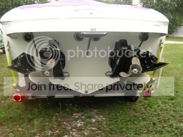

My lower units are missing the ? w/pic
Join Date: May 2009
Posts: 204
Received 0 Likes
on
0 Posts
Not sure what there called but they connect the two together. What does this do and can I do install them on mine. Anyone have an idea of price?
Join Date: Oct 2006
Location: Michigan
Posts: 1,449
Received 0 Likes
on
0 Posts
Swap Shop
Keep an eye open in the swap shop, they come up every now and then. Thought there was one in this post but haven't looked lately.
http://www.offshoreonly.com/forums/s...or-plates.html
If you have the inner tiebar, I wouldn't use the exterior one too. Using both can put a tons of stress on the steering tiller, gimble rings when trim at different amounts. The lenght between the points where the ext tie bar mounts changes as the drives trim further apart, while the inner bar always remains the same lenght. Something has to give! Steel doesn't stretch or compress here.
