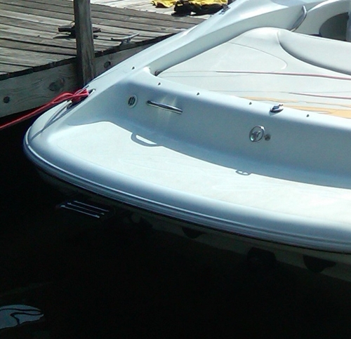

Let me ask you a question. We run (and tow) without the center portion of the windscreen in place and without the bifold door (ours is an Islander). The issue is that the hatch is always trying to open at anything above 45 or 50 mph. It has even pulled the hatch actuator bracket loose from the hatch. Do you have this problem? Actually this occured when we had the center section of the windscreen in place. I am taking steps to correct this but I did find it odd. It would be much better if the hatch also had the back of the bench seat attached to it. That would have solved a lot of my problems I imagine.
Here's a picture of the recessed hatch for those that don't understand the problem.
