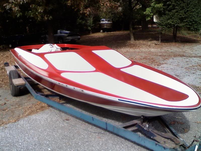

    I have a 23 powerplay that I rebuilt the stock 7.4. I bored out .30 used the stock crank and rods with hyperpertetic pistons 9.5:1, mild comp cams marine extreme cam kit, I was able to use the stock springs but I added the bigger push rods and harlem sharp rockers, had to use longers studs for the cam and rockers, summit duel plane intake and re-jetted the stock carb, I kept the stock exhaust but made it thru-hull with corsa muffler tips. I don't know how fast the boat was before i rebuilt it because it was a basket case when I got it but it runs 62 to 63mph on gps. I ran it all year with no problems and it pulls a tube and comes out of the hole great. It has a 23p mirage 3 blade.Walker Road 079.jpg
