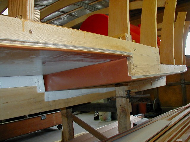

Replica of Miss Detroit III - built by Mike Michaud
[ATTACH=CONFIG]527337[/ATTACH]
The step.
[ATTACH=CONFIG]527338[/ATTACH]
From 1910 to 1936, the "step" hydroplane reigned supreme as the undisputed king of big-time power boat racing. This was especially true in the area of Harmsworth competition. The British International ("Harmsworth") Trophy was the bronze plaque traditionally emblematic of the speedboat championship of the world. The Harmsworth was technically a race between nations rather than individual boats. During the years between the World Wars, the two countries that usually battled for possession of the Harmsworth Trophy were the United States and Great Britain.
