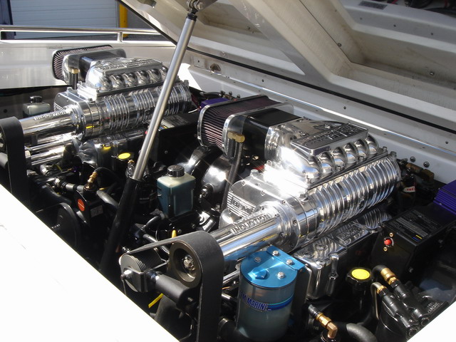

Here she is!
BTW nice boat in your signature picture.
Here she is!

looks DAM good Craig. That is a true lake rocket. I miss that blow your hair back type feeling. Now that you have some seat time what type speeds are you pulling???
