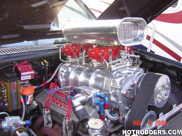

I am converting my NA 509 over to FI with a B&M 250 blower. I currently have the oem recerc pump and thermostat housing on my motor.
My question is this, where can I find a recurculation thermostat housing that will bolt on to the front of this B&M intake manifold?

not sure on the B&M but the weiand's used a adapter to move the therm housing out from under the blower on their marine units, I used a crossover and a short aftermarket housing and worked fine

We used to use the housing off the Mercury 800, but it's no longer made.
