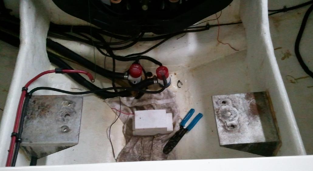

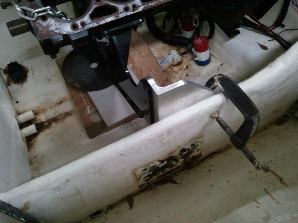

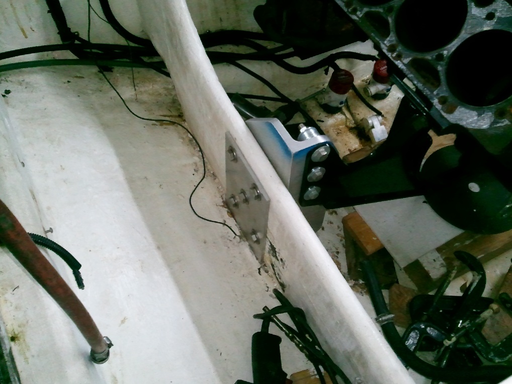

I made the alum stringer mounts out of 6" angle 1/2" thick and cut it to make it look like an original - just a little or maybe alot more beefy, maybe an over kill but oh well.

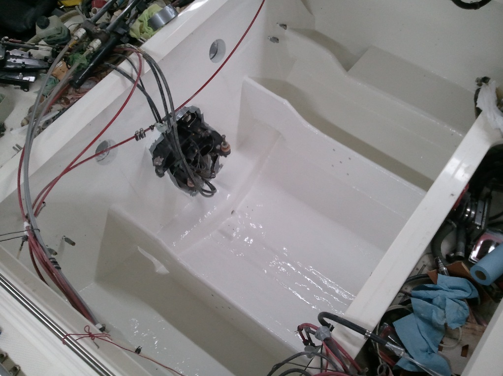

all junk taken out, cleaned up, holes filled in and painted, now just waiting for my lazy butt to finish the motor and drop it in!!
