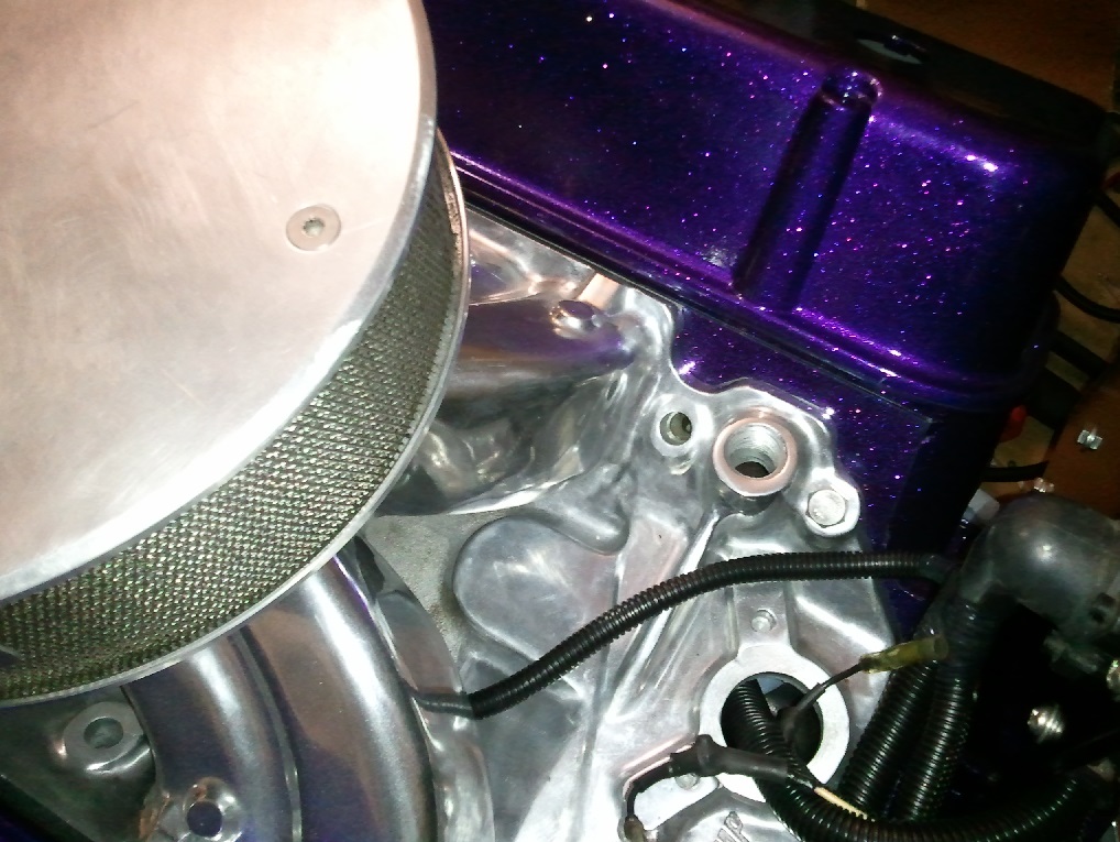

I have seen where Merc was running a PCV in the lifter valley, mounted in the intake manifold of the Dart intakes and routed up to a fitting on the carb spacer. Does this significantly help with blowby and excessive crankcase pressure? I have run breather tubes up to my flame arrester in the past, and have always had the annoyance of some oil dripping out of them. Wondering if the PCV will help with this. My manifold that I am going to run already has the boss for one - it would just be a matter of drilling the correct diameter hole and obtaining a grommet and PCV, etc.

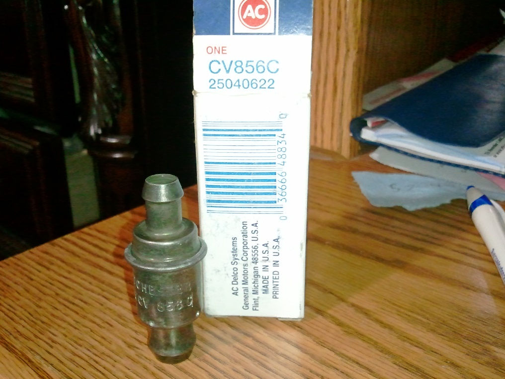

I was going to do the same thing to my intake, my buddy's 525SC has the same set up in the back of the intake. I found a thread on here asking the same cross ref of the PCV the number they gave was CV856C
But I MUST caution you, you also have to run a valley pan or else the PCV will suck oil up. I ordered the pan from my local Chevy dealer. I still have to find a grommet that matches the PCV valve. Hope this helps.
