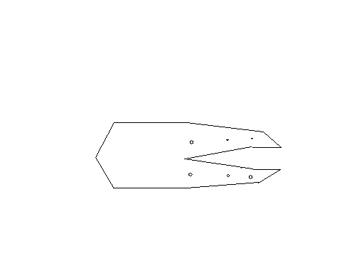

I HAVE A VERY HEAVY REAR ON MY CARY 50 (QUAD BBC) ANYONE EVER TRIED ADDING TO THE CAVATATION PLATES ON THE OUT DRIVE (LIKE A WHALE TAIL) TO HELP LIFT ? WE HAVE SMALL SKI BOATS DOING THIS TO HELP GET ON PLANE, AND I WELD QUITE A FEW OF THEM BACK TOGETHER BECAUSE OF POOR DESIGN. I'VE SEEN ALUMINUM ADD ON'S ON B-MAX AND OTHER HI-PERFORMANCE DRIVES BUT NEVER ON ANYTHING AS LARGE AS MY BOAT WITH TRS DRIVES. WOULD THESE HELP KEEP THIS THING ON PLANE ? THE BOAT WEIGHTS 32000 LBS AND HAS A TOP SPEED OF 54 MPH, CRUISE SPEED @ 4200 RPM IS 40 MPH.

YES IT HAS LARGE TRIM TABS, GETTING ON PLANE NOT A PROBLEM, AS I JUST PUSH THE CENTER 2 TROTTLES TO 1/2-3/4 THEN THE OUTER 2 UP ALL THE WAY THEN AGAIN THE CENTER 2 AND AWAY WE GO. THE PROBLEM IS BELOW 34 MPH THE BOW RIDES SO HIGH THAT YOU CAN'NT SEE PAST IT. (I THINK I'VE RUN OVER A FEW JET SKI'S..LOL.) IF I PUT THE TABS DOWN TO LOWER THE BOW I HAVE TO THROTTLE BACK UP TO MAKE UP FOR THE DRAG. SO ITS BETTER TO JUST THROTTLE IT TO 4000 RPM + AND GO. I WAS HOPEING SOME OF THE PEOPLE ON THIS SITE MAY HAVE PLAYED WITH DIFFERANT SIZE CAV. TABS ON LARGER OS. BOATS LIKE CIG'S WITH TRIPLES ETC. I OWN A FAB SHOP AND I REPAIR ALOT OF LOWER UNITS ( ALUMINUM WELDING & FABRICATING) SO I KNOW THAT WHALE TAILS WILL BREAK THE CAV. PLATES BUT I"VE SEEN ADD ON ALUM. PLATES ON SOME B-MAX AND OTHER HI-PERF. DRIVES AND IT GOT ME THINKING!!! (I SHOULDN'T DO THAT!)

If you have a fab shop then you're set!
Most of the breakage comes from extensions that are bolted to the TOP of the existing cav plate. If you make a 1-piece extension, about 10" wide, extending back an additional 10" that has a cutout in the center that allows it to be bolted to the BOTTOM of the existing cav plate, then it should work. Use 3/8" thick aluminum.
