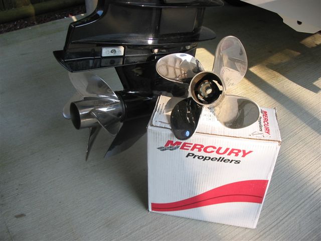

FASTX,
You still didn't tell me if you had an X motor or not. Big difference. Try all props you can. Hell, I got a 28 small ear chopper I thru on, but didn't like it. Pics of the Trophy Plus', flotorque II hub kit, both new(only way they sell 'em that I know).WWW.PROPELLERSONLINE.COM
The cabin door thing just bothered me. Shoulda been built right first time. Sticker is coming off & getting stuck to something portable.
FASTX,
