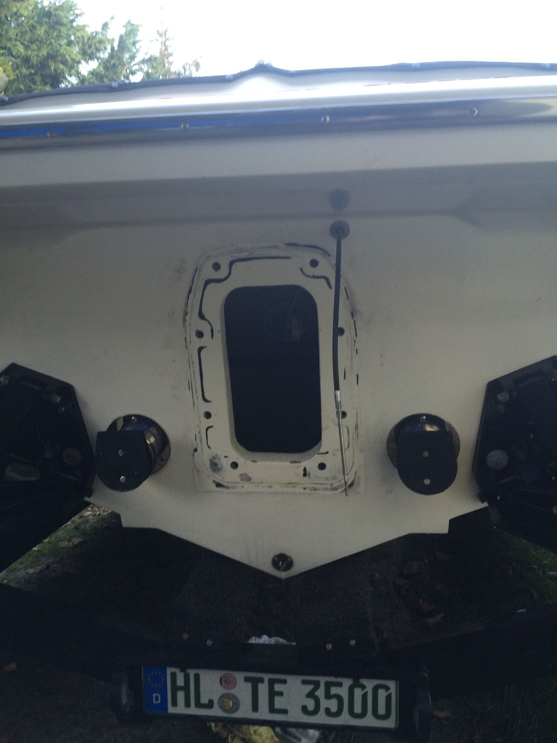

Transeurop 09-06-2022 03:39 PM
My 30 Activator once had a #6 fitted
https://cimg3.ibsrv.net/gimg/www.off...339ea8969c.jpg
tomcei 09-09-2022 01:37 PM
interesting exhaust set up..
