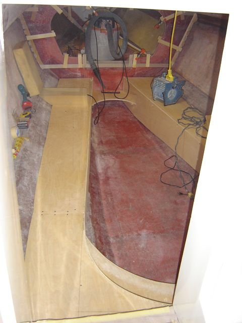

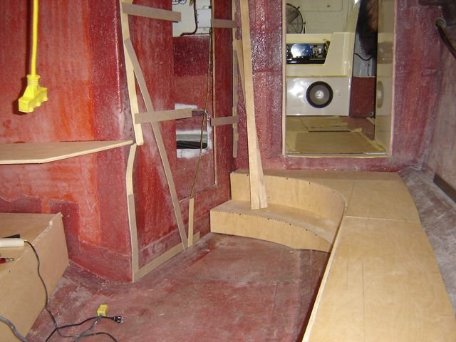

Here's the cuddy being built for my 33 AT Remedy. This should give you a idea of how the corian was installed over the wood.
https://cimg9.ibsrv.net/gimg/www.off...16d812f227.jpg
https://cimg0.ibsrv.net/gimg/www.off...4104b548e7.jpg
