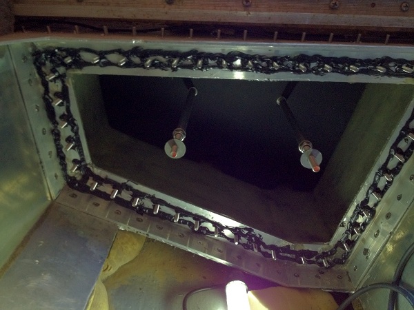

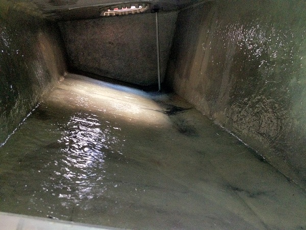

Tanks are ready and keeps fuel inside

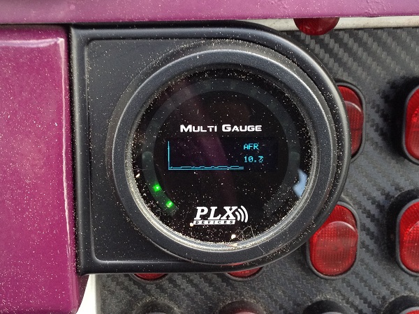

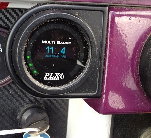

PLX O2 Gauges in place and working
Idle mixtures are fat like i have think (Port 11, sb 10).

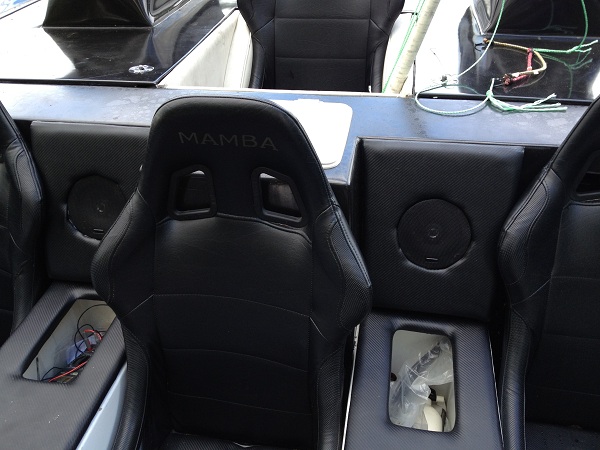

Old 06-03-2012 | 12:35 PM
Joined: Aug 2010
Posts: 197

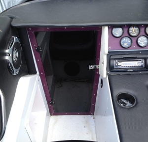

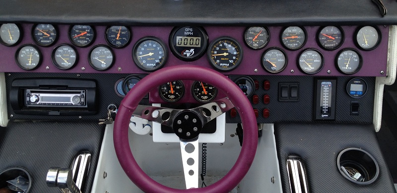

Outside doors ready and in place also back speakers has new
integrated speaker holsters.
