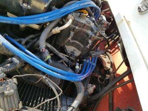

Shotgunn 12-01-2019 05:33 PM
https://cimg1.ibsrv.net/gimg/www.off...286ee8adbf.jpg
Tested headers, no leaks found yay! Got engine out- not fun. Back seat was scum adhered in place, must have been 15 ground wires( one on every hidden bolt lol) Put it on my brand new 1000lbs stand, the stand folded in half- top notch china quality there. Looks like something is missing?

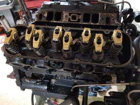

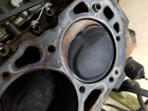

Shotgunn 12-01-2019 05:38 PM
https://cimg7.ibsrv.net/gimg/www.off...4af9634474.jpg
https://cimg8.ibsrv.net/gimg/www.off...437c8ac3ac.jpg
https://cimg2.ibsrv.net/gimg/www.off...3f7e973ee2.jpg
https://cimg4.ibsrv.net/gimg/www.off...309c94f849.jpg
https://cimg6.ibsrv.net/gimg/www.off...b01eeb3364.jpg
Roller rockers(crane), Ported heads, and Domed pistons. Not what I was expecting to see

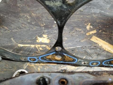

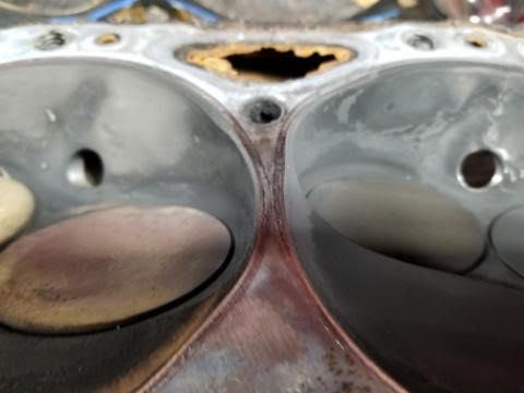

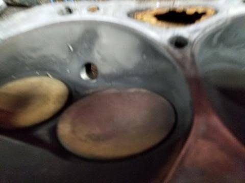

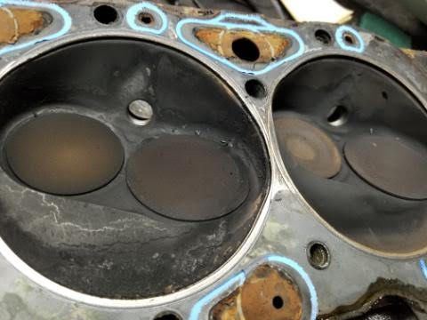

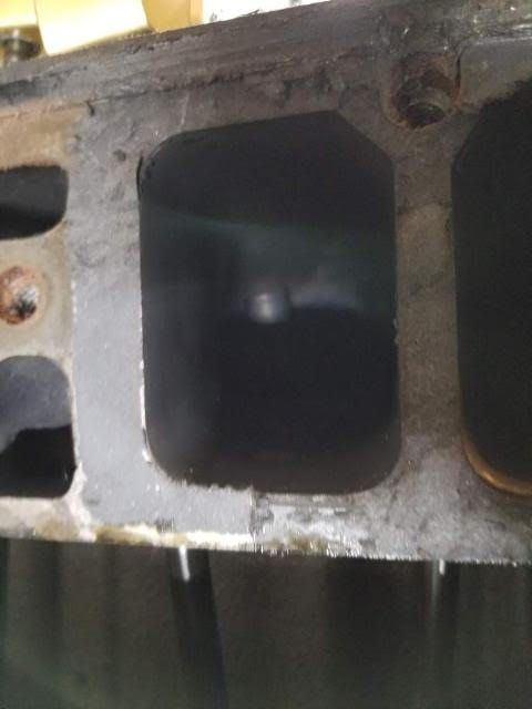

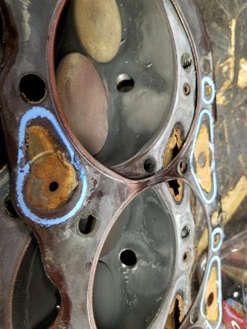

Shotgunn 12-01-2019 05:42 PM
https://cimg3.ibsrv.net/gimg/www.off...60ec3e75f6.jpg
Light scoring
https://cimg4.ibsrv.net/gimg/www.off...32bec7c5e4.jpg
Head gasket
https://cimg5.ibsrv.net/gimg/www.off...16f867f03c.jpg
Head gasket 6 and 8
https://cimg6.ibsrv.net/gimg/www.off...822acf9555.jpg
Head 6 and 8
https://cimg7.ibsrv.net/gimg/www.off...0a487c8be2.jpg
5 and 7
https://cimg9.ibsrv.net/gimg/www.off...1166ffd8f0.jpg
5 and 7
So who said blown head gasket? WINNER
GasketS actually

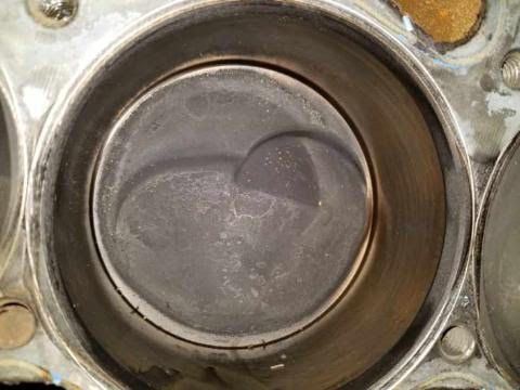

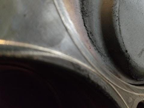

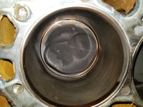

Shotgunn 12-01-2019 05:48 PM
https://cimg2.ibsrv.net/gimg/www.off...54de1a43e0.jpg
See the ridge? Is this some kind of marine finish? Very pronounced around all cylinders.
https://cimg5.ibsrv.net/gimg/www.off...7b3a0bdb78.jpg
Blown? not bad enough for 0 psi I dont think, and why was #5 reading over 100?
I cant find any other reason other than a blown head gasket, Anyone have thoughts?
Shotgunn 12-01-2019 06:08 PM
JE pistons!
Shotgunn 12-02-2019 06:16 PM
Ok, research done. The block was "o ringed" for use with copper head gaskets. The person that assembled the engine this last go round used standard marine felpro gaskets.
