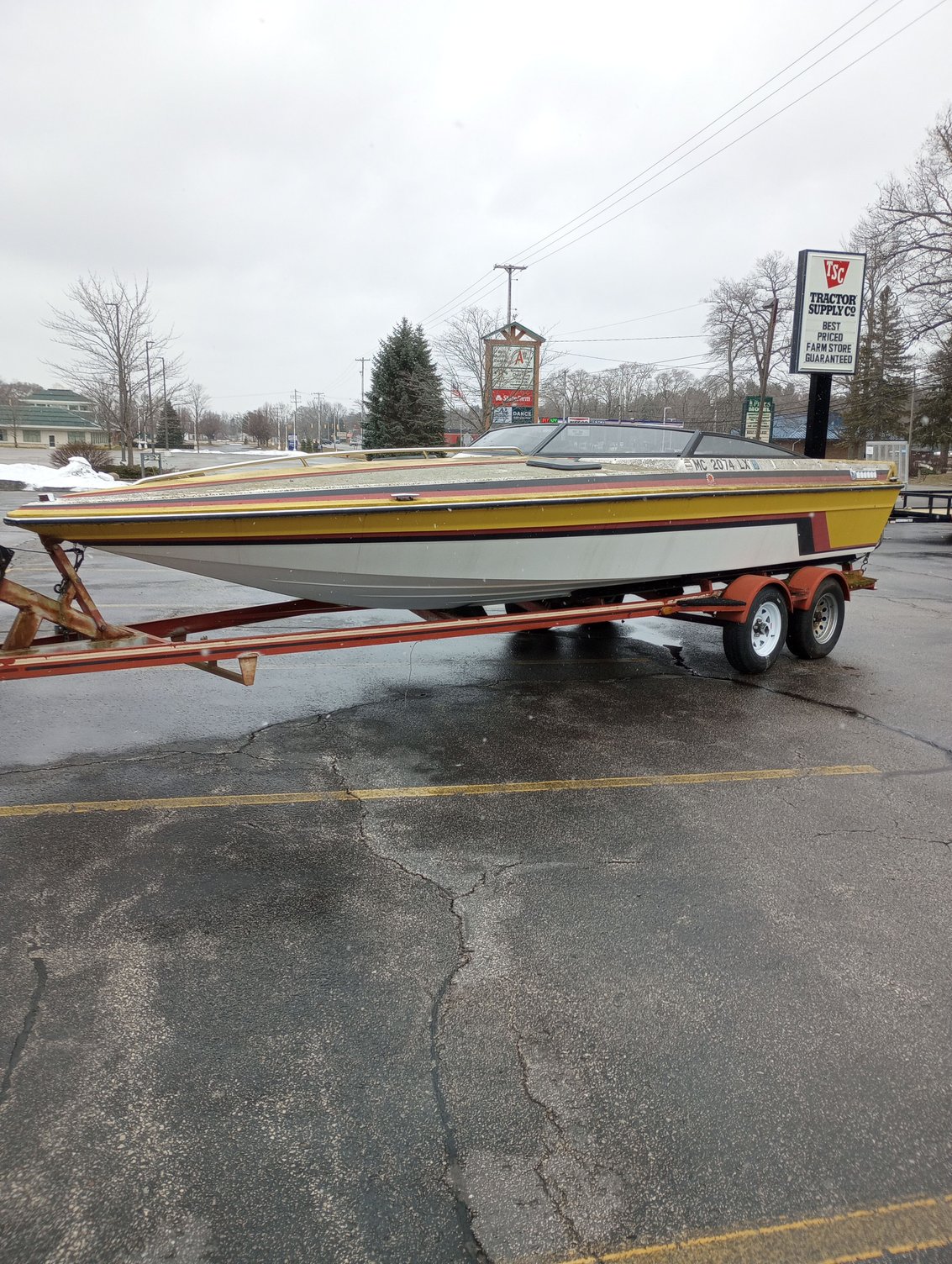

Lets see if the pics go through after my 10th post! Pic of boat in local Tractor Supply parking lot. Actually made is 3.4 miles on the rotted tires!!! Had to pull of 10 miles up the road (luckily at a Walmart) because we lost one old one and put 2 new tires on the old rims for the trip home. :)

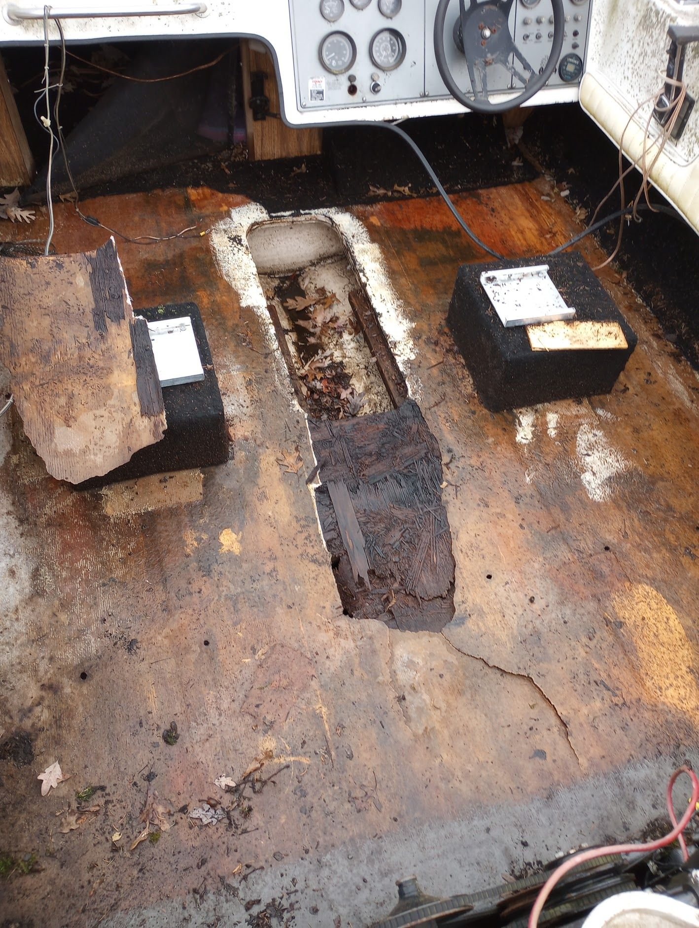

Started pulling carpet and seat pedistals / boxes. Floor is pretty rough. Will try and get a section cut out today and see whats going on. Floor appears to be very thin plywood coated with resin.

The floors were notorious for having issues, the stringers were/are usually less susceptible to rot but still need to be checked thoroughly. And of course make sure the transom is sound.

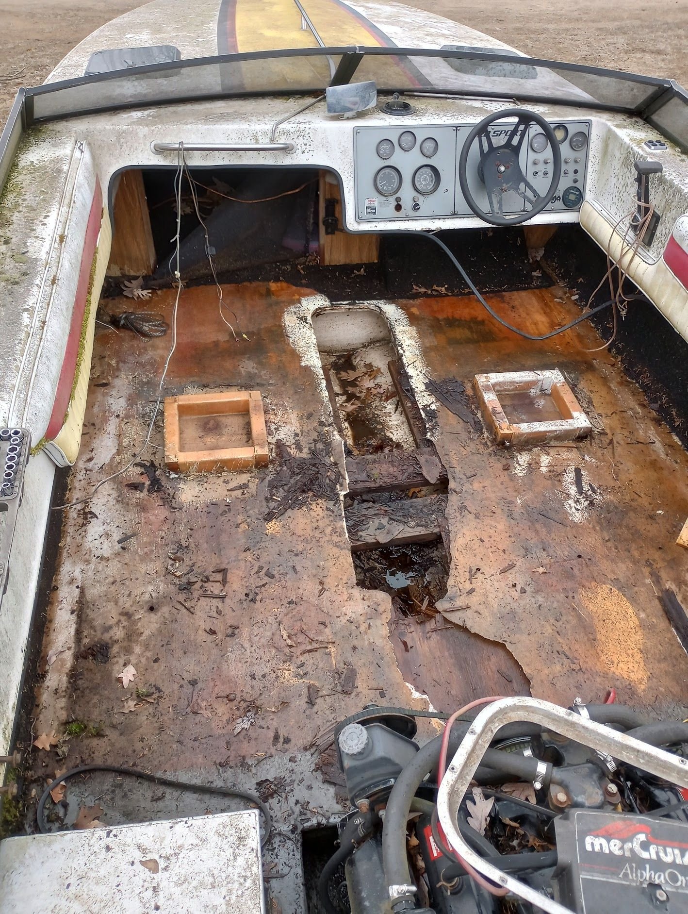

hmc710 04-01-2023 09:01 AM
Bad floor

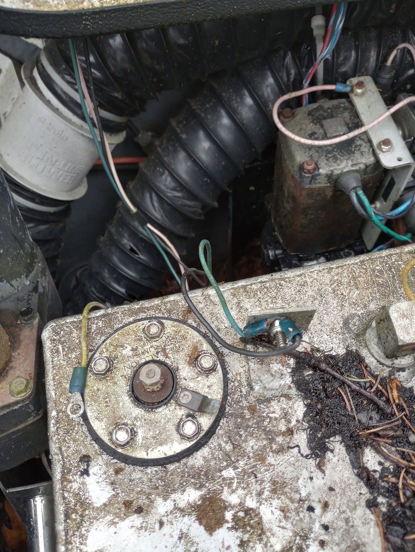

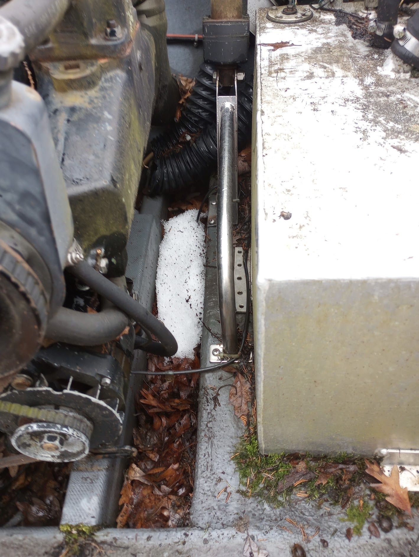

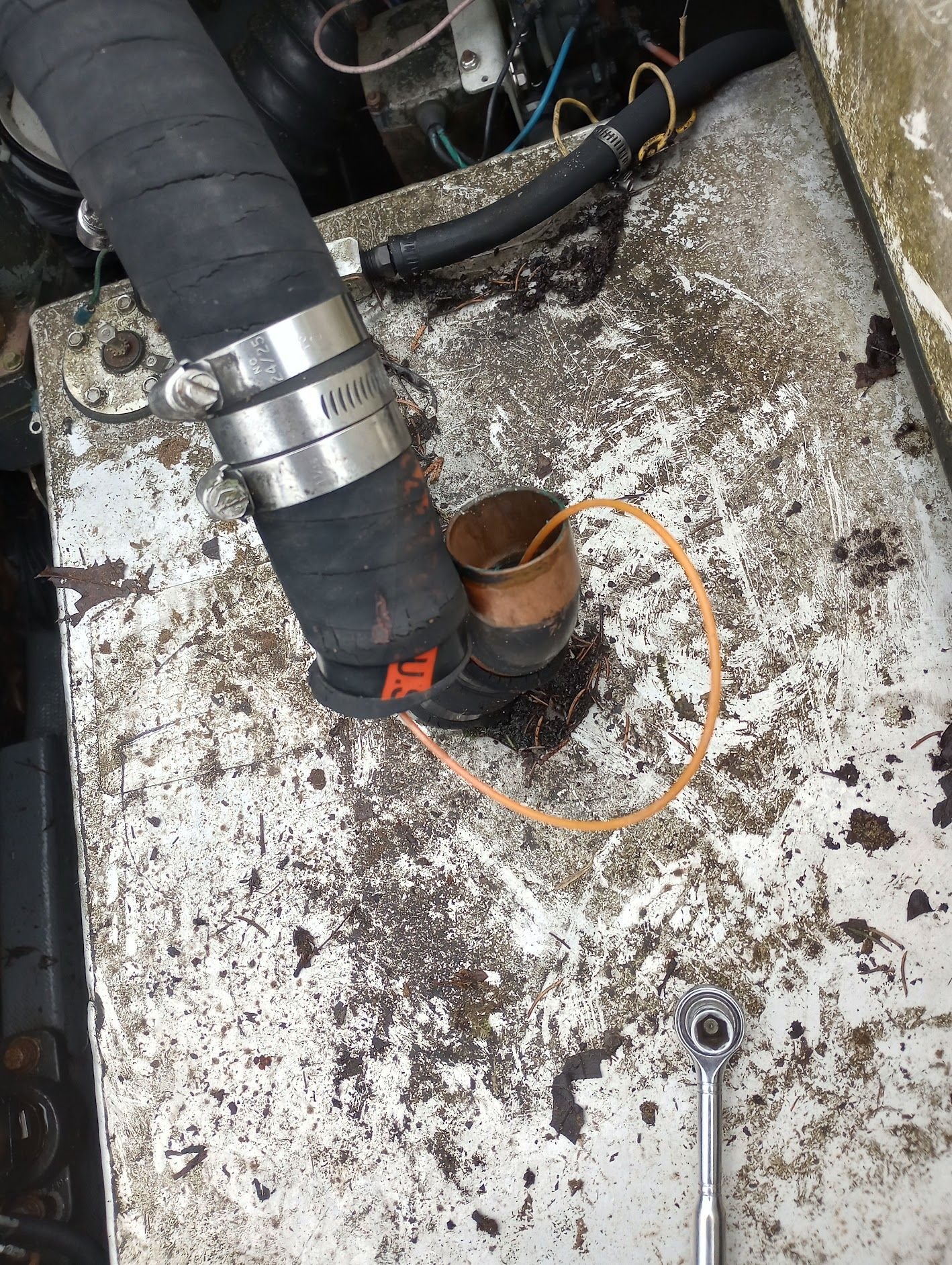

Floor is gone, and not having done this in person before, taking note of what I do find. Pulled out the remnants of the battery box, getting fuel tanks unhooked. seat bases out, and started peeling off the loose glass on the floor.
Will probably take it to the shop and pull the motor out to make more room and do better inspection of engine bay and transom.
https://cimg2.ibsrv.net/gimg/www.off...443bd0f2ef.jpg
Battery box
https://cimg4.ibsrv.net/gimg/www.off...ba50002fb8.jpg
Yuk
https://cimg5.ibsrv.net/gimg/www.off...b3febcdc79.jpg
yikes
https://cimg6.ibsrv.net/gimg/www.off...371956c531.jpg
Rutt row...
https://cimg8.ibsrv.net/gimg/www.off...a39acb5b27.jpg
Hatch Mount
https://cimg0.ibsrv.net/gimg/www.off...351affc8e7.jpg
tank wires
https://cimg1.ibsrv.net/gimg/www.off...38491e41aa.jpg
Tank

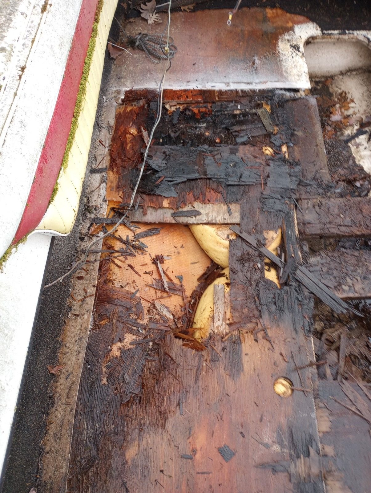

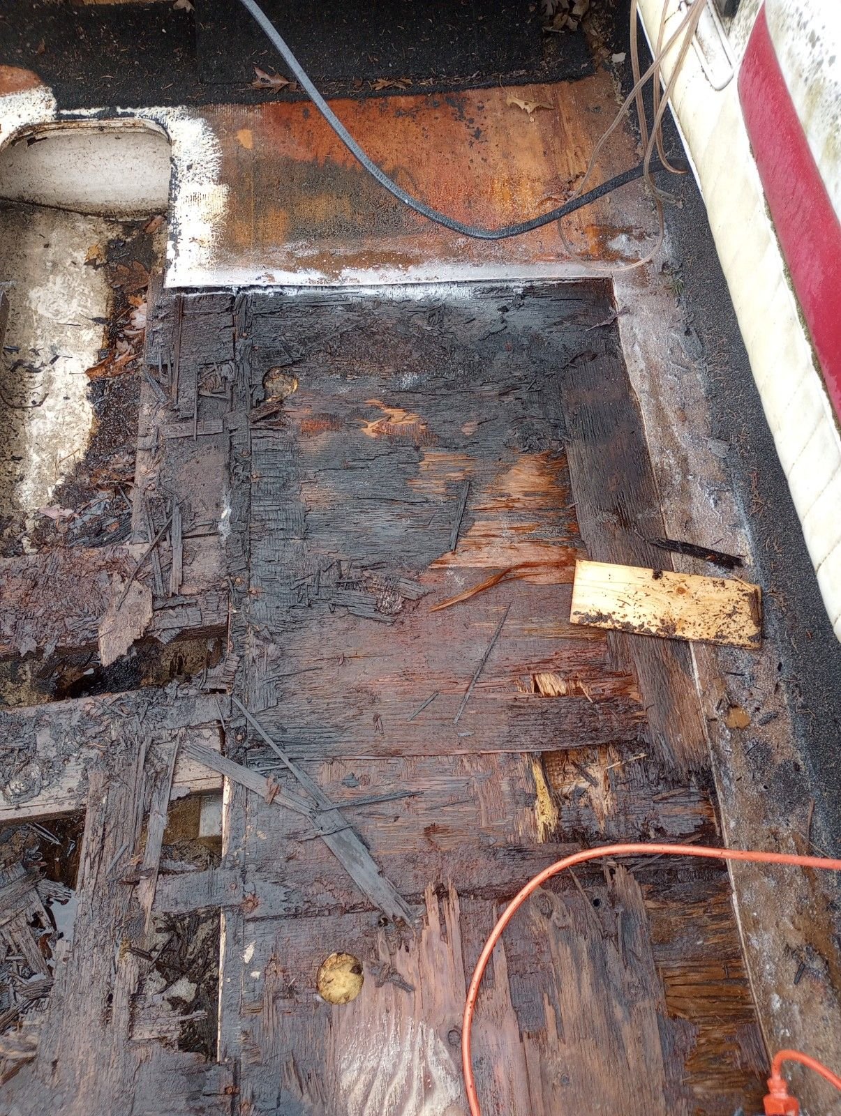

hmc710 04-02-2023 10:17 AM
Cutting floor out

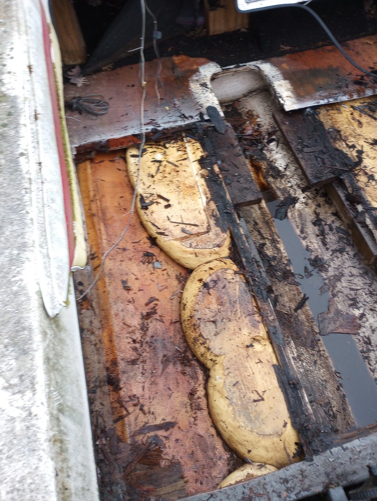

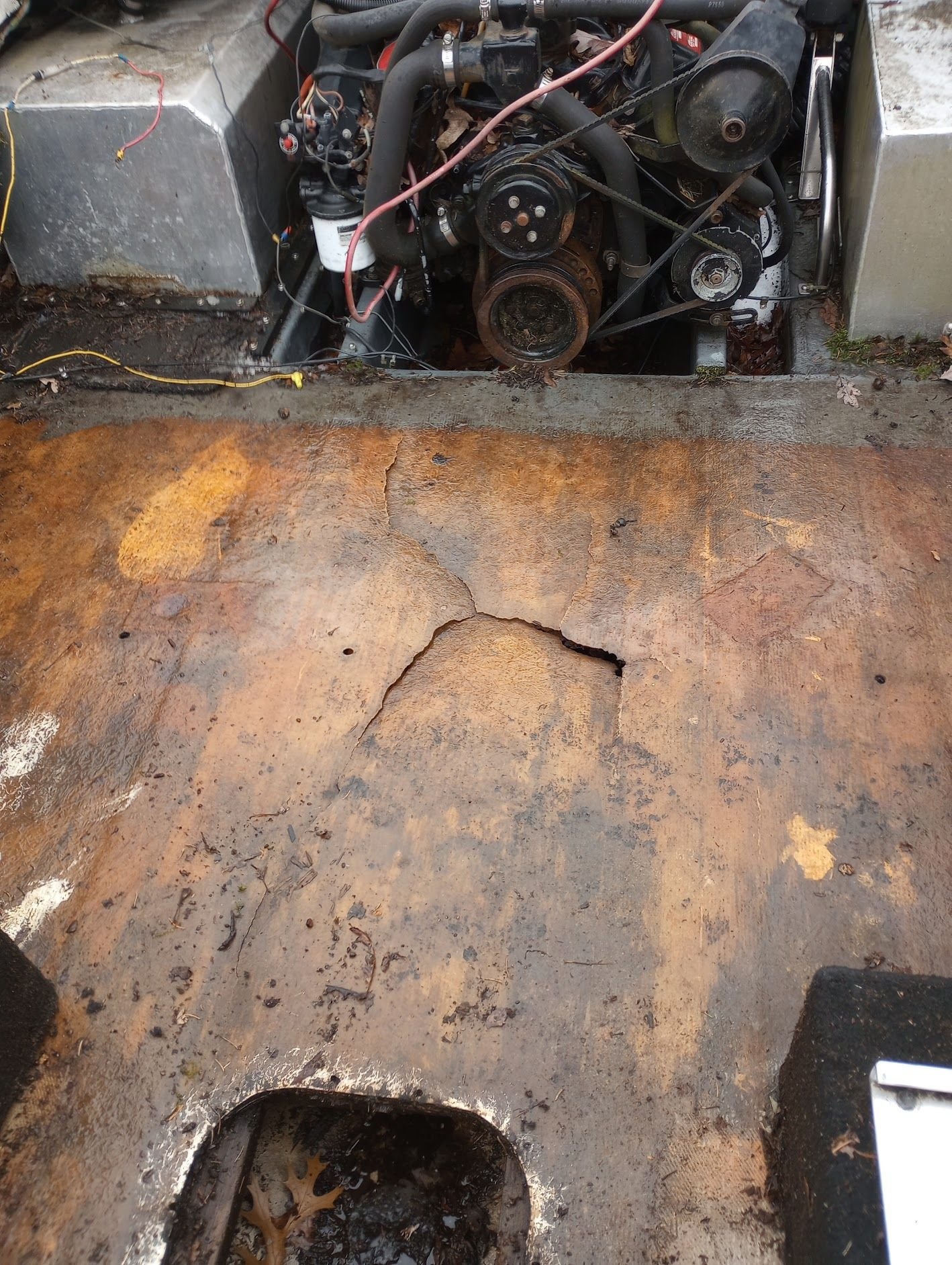

Took a saw and cut out the back half of the fiberglass floor, what a mess. Definitely going to have to take out more up into the "cuddy" area which means pulling out the bulkhead / wall. I'll take a look at that this afternoon. Any suggestions please let me know. It looks like two layers of 3/8 or 1/2" plywood that might have had a layer of glass between them. You can see the holes where they cut out to fill in with foam. I'm going to pull the carpet off the sides and see what the cuddy wall looks like so I can pull that out or "gasp" start learning about cutting the deck off....
https://cimg4.ibsrv.net/gimg/www.off...5bf8fb1d70.jpg
Section 1
https://cimg5.ibsrv.net/gimg/www.off...323879c243.jpg
Section 2
https://cimg6.ibsrv.net/gimg/www.off...d0f074d35c.jpg
Rot
https://cimg8.ibsrv.net/gimg/www.off...fb3473dbf6.jpg
More rot
https://cimg9.ibsrv.net/gimg/www.off...a961a1a9d8.jpg
