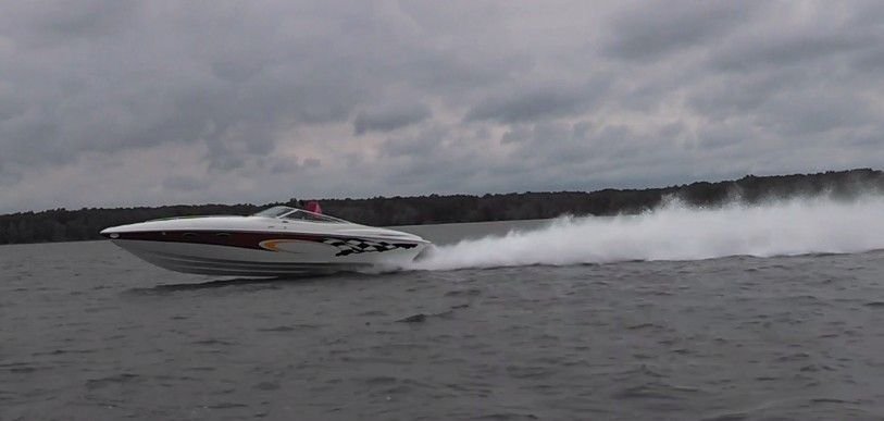

sabo 12-10-2025 06:22 AM
My dad had a 302 with 454 mpi's 385hp, 25p 3 blade Mirage plus I believe it ran 69gps
https://cimg1.ibsrv.net/gimg/www.off...19e745091e.jpg
