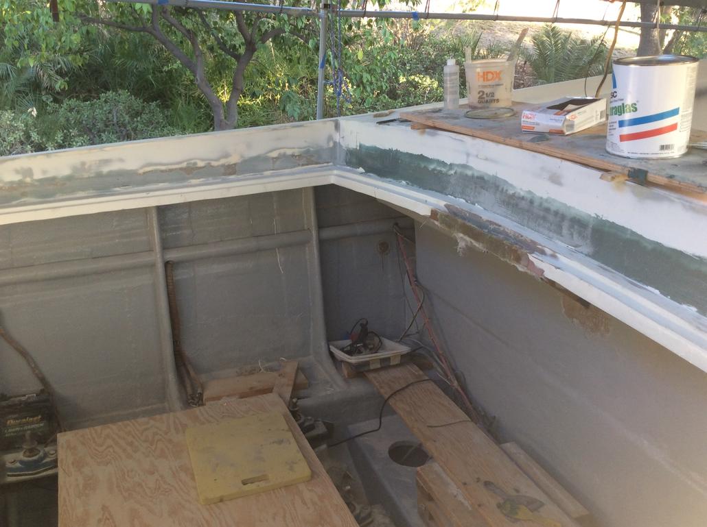

[ATTACH=CONFIG]559937[/ATTACH]Another update...does not seem like a lot has been accomplished, but many many days have been spent block sanding deck, then filling, then block sanding, then....! It finally has blocked out smooth. Made a outline mock up of Seatek with motor mounts in proper locations. Aligned mock up to drive location, discovered the hatches are too low! Attached a picture. Thought about scoops, my son (16 years old, liked that), but I just don't think it works on this boat. Dan Archer stopped by to check out my progress, he had an awesome solution, just raise hatch hieght. At the same time, I will disc the twin hatches for one large one hinged from the back, this will allow easy access down the middle between engines, as well. Problem solved, thanks Dan!

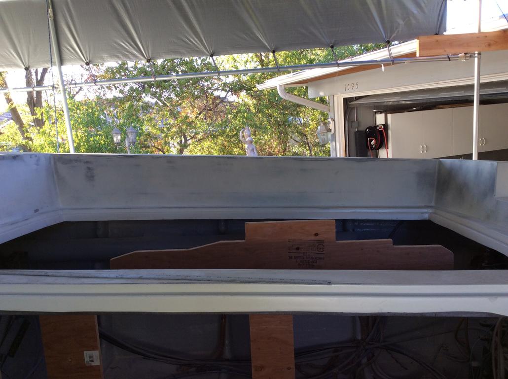

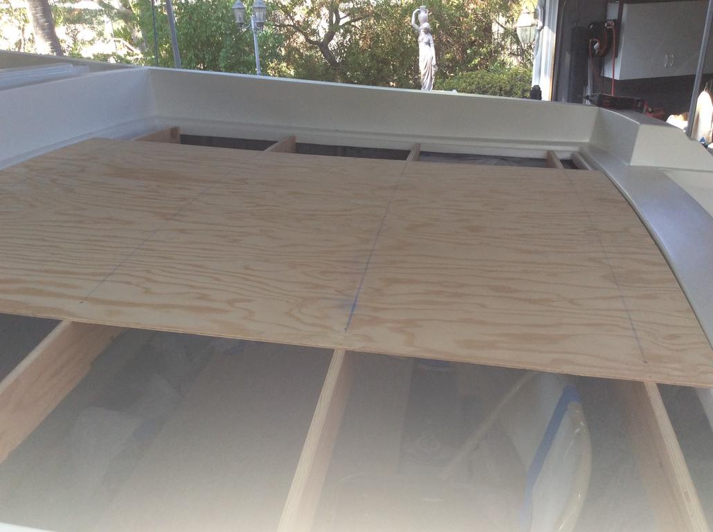

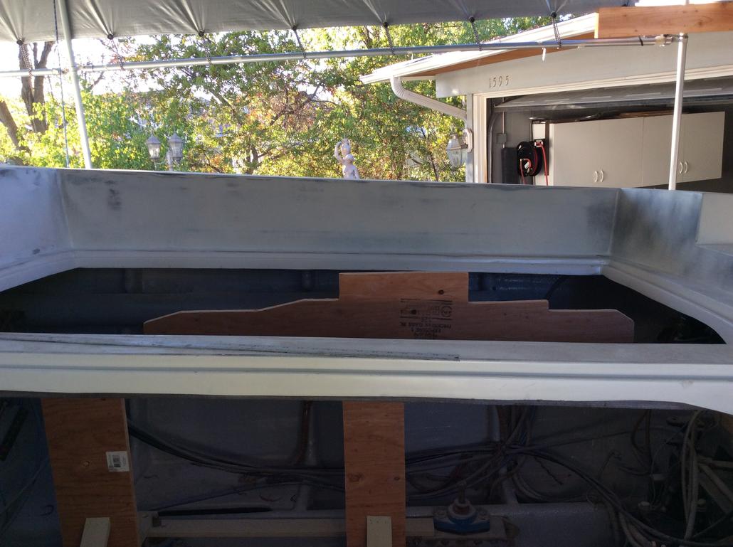

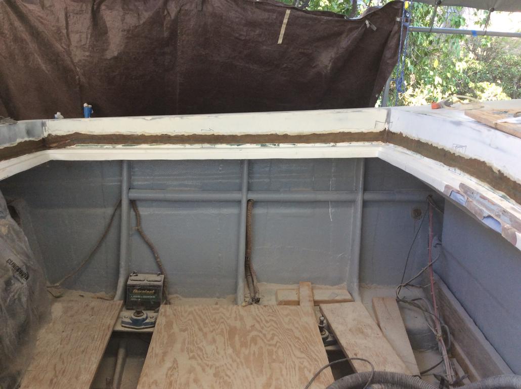

[ATTACH=CONFIG]561196[/ATTACH][ATTACH=CONFIG]561197[/ATTACH][ATTACH=CONFIG]561198[/ATTACH][ATTACH=CONFIG]561199[/ATTACH][ATTACH=CONFIG]561196[/ATTACH][ATTACH=CONFIG]561197[/ATTACH][ATTACH=CONFIG]561198[/ATTACH][ATTACH=CONFIG]561199[/ATTACH]Here's the hatch raised to the new level. You have to look at reference points to spot the new location of hatch. Also removed the center piece. It will now accommodate the Seatek's height. I've attached a few photos along the way. Fabricating the pattern for one piece hatch now. Sorry, just realized I attached the photos twice, can't figure out how to delete photos!

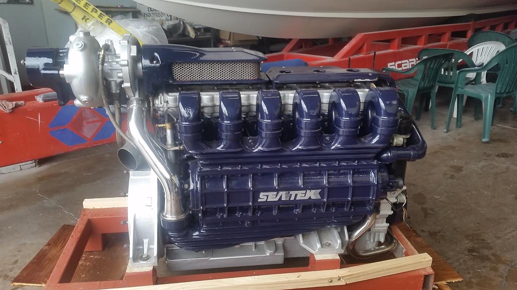

From: Newport Beach
It's been a little while for updates. We're getting closer! The Seatek 600hp engines have arrived to Archer Marine. Dan will be installing. We're running TwinDisc 5075 SC with .80:1 ratio. This will put prop speed around 3900 rpm. Install should start within the next few weeks. If you've been watching weather, SoCal has been held up a lot with weather related stuff. I know, nothing compared to the rest of USA...but at least we're getting a little bit of weather!
