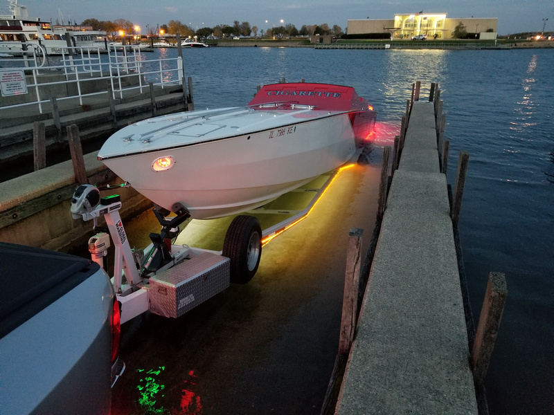

ICDEDPPL 10-23-2017 08:33 AM
4 Attachment(s)
Did some end of October boating/looking for my lost prop this weekend ... loving this weather .
Small craft advisory most of the day, got to test the set up, help up and worked fantastic. :drink:
