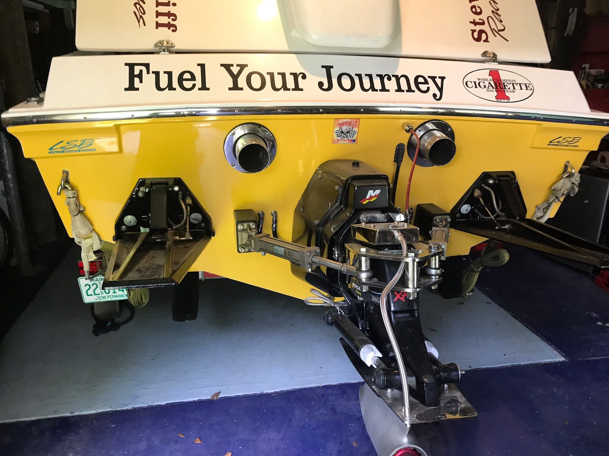

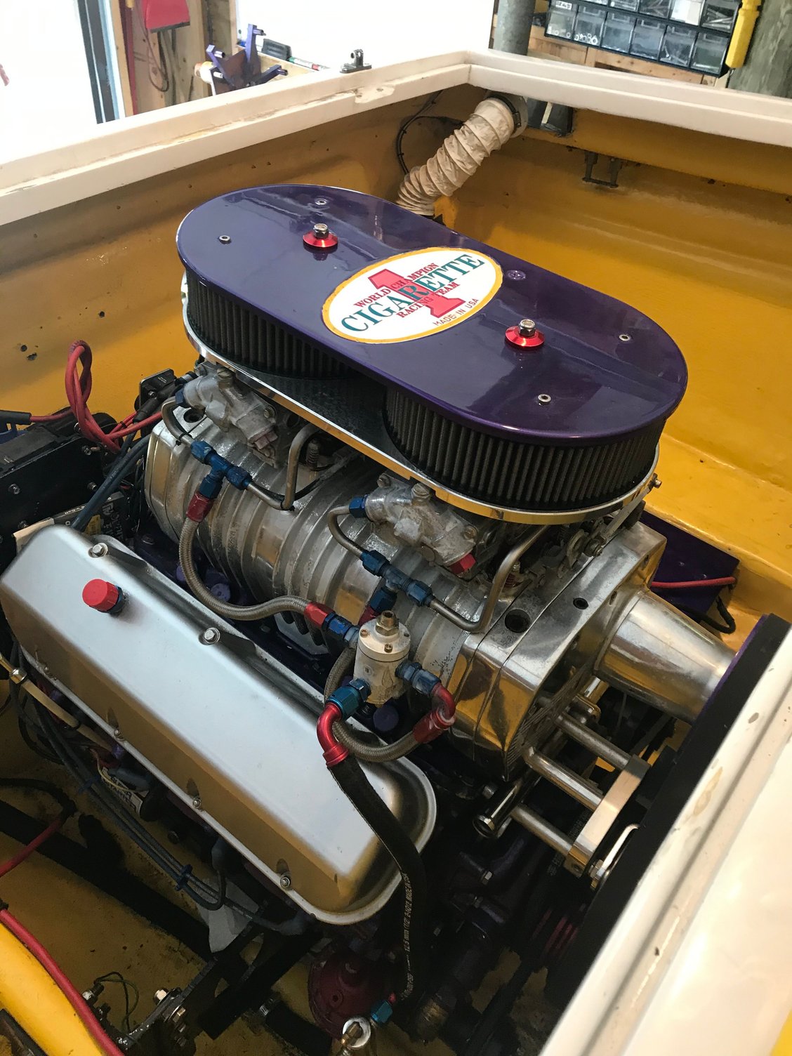

If you are Gregg, we spoke yesterday. My last 28 was originally an old twin small block with TRS's. We converted it to a single supercharged BBC with an Bravo XR upper and an IMCO -2 lower. We used 380 K-planes and of course hydraulic steering. The boat handles great and rides very level. I would highly recommend the conversion.
Thanks, Barry

I deleted a bunch of pictures, here are a few Speed was competitive in Class P5
Thanks, Barry
Driver - High's Fuel Your Journey Cigarette Racing Team #598
