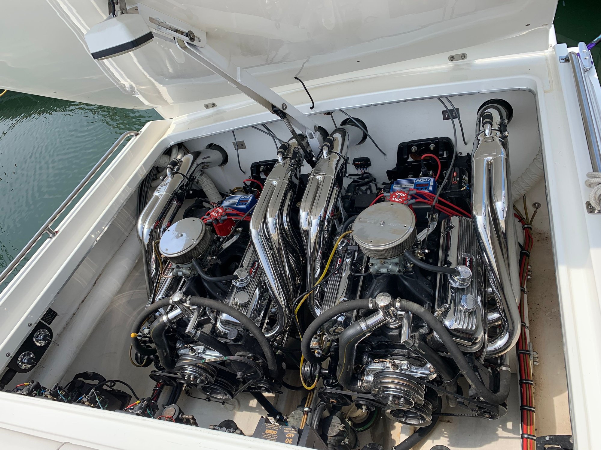

On the motors, IMO, the safest way to buy motors is to buy them totally disassembled.
We are doing a long weekend on one of our favorite Lake Erie islands, on our 251 this weekend.
Last time there, I helped into dock, a gorgeous, all orig gun w/orgasmic motors!
I was impressed at their level of tune, especially at idle.
Shiffted, idled perfectly, never stalled around dock etc.
I think many miss this target and importance of it when weekending on the boat.
He reported 500-ish HP per side and 70 MPH top end which he was very satisfied with and think I would be too.
Im an OB guy but couldn’t take my eyes off the motors!
