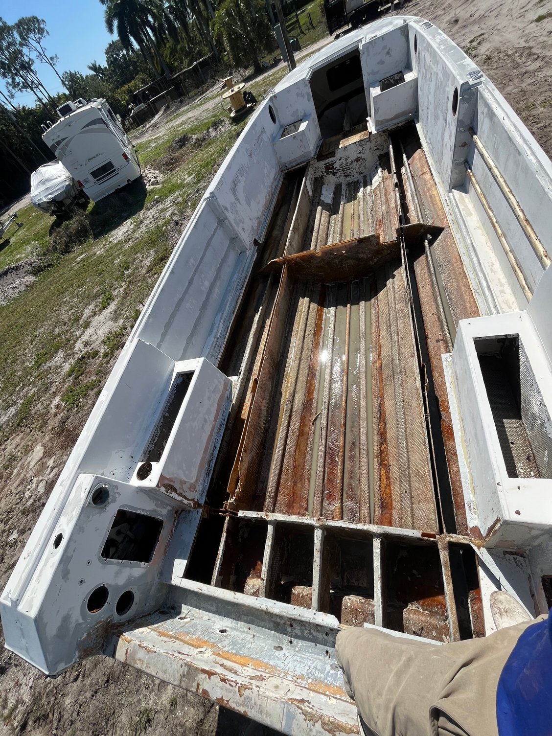

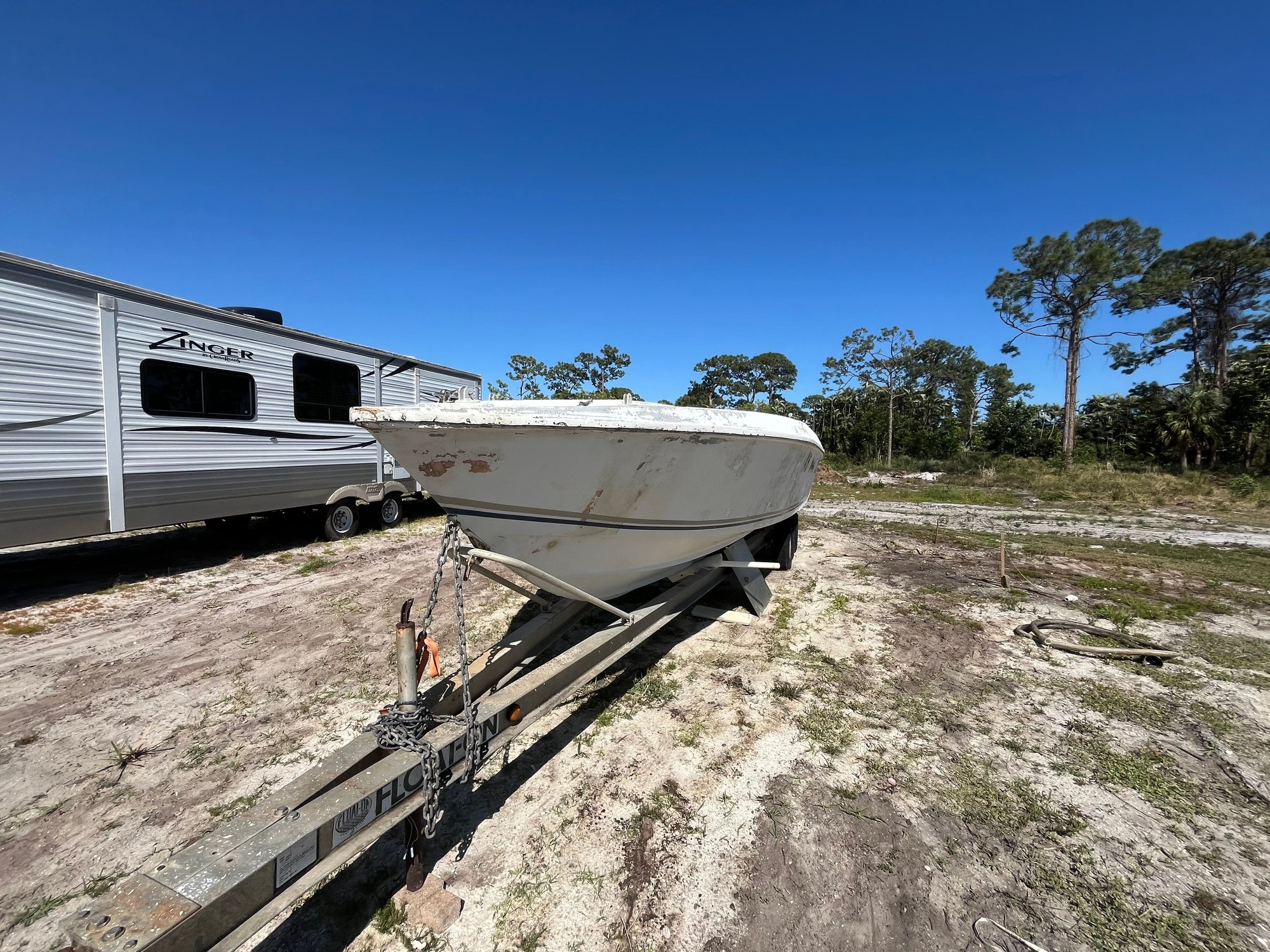

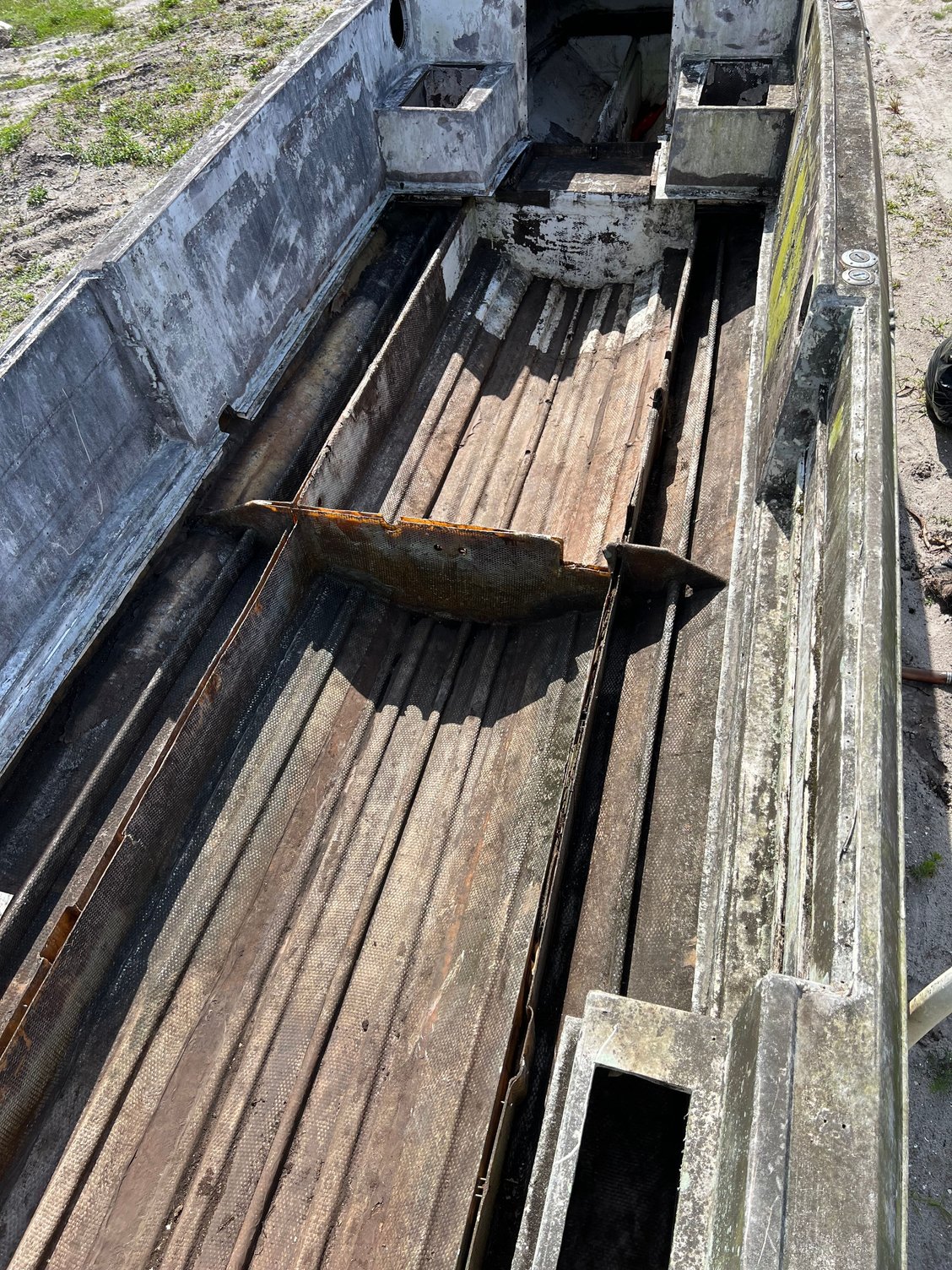

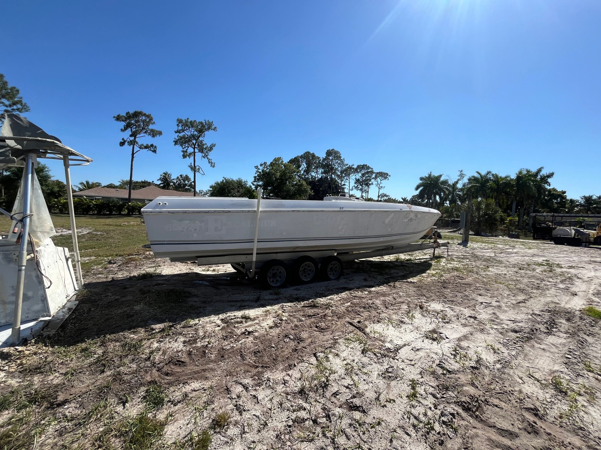

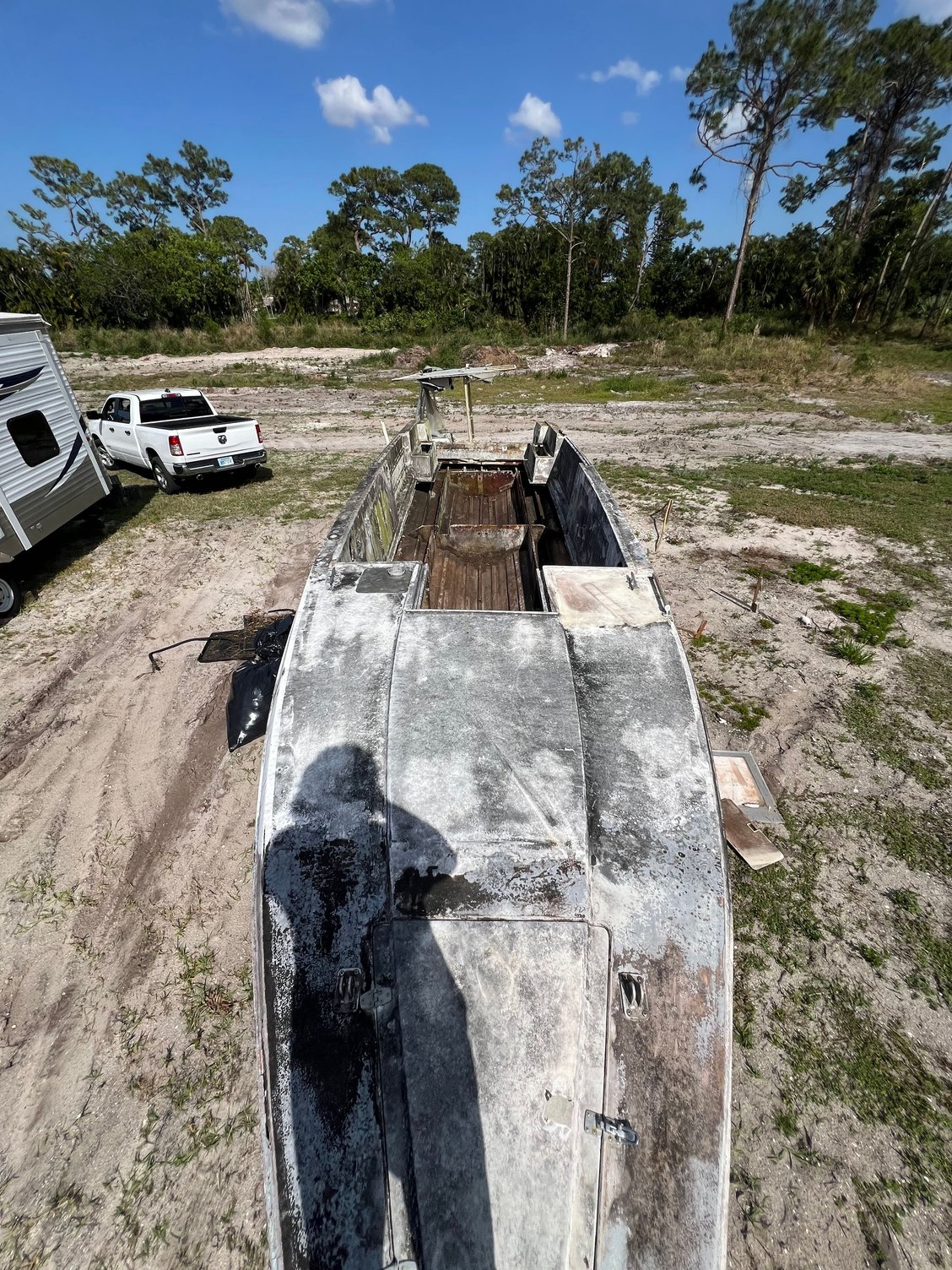

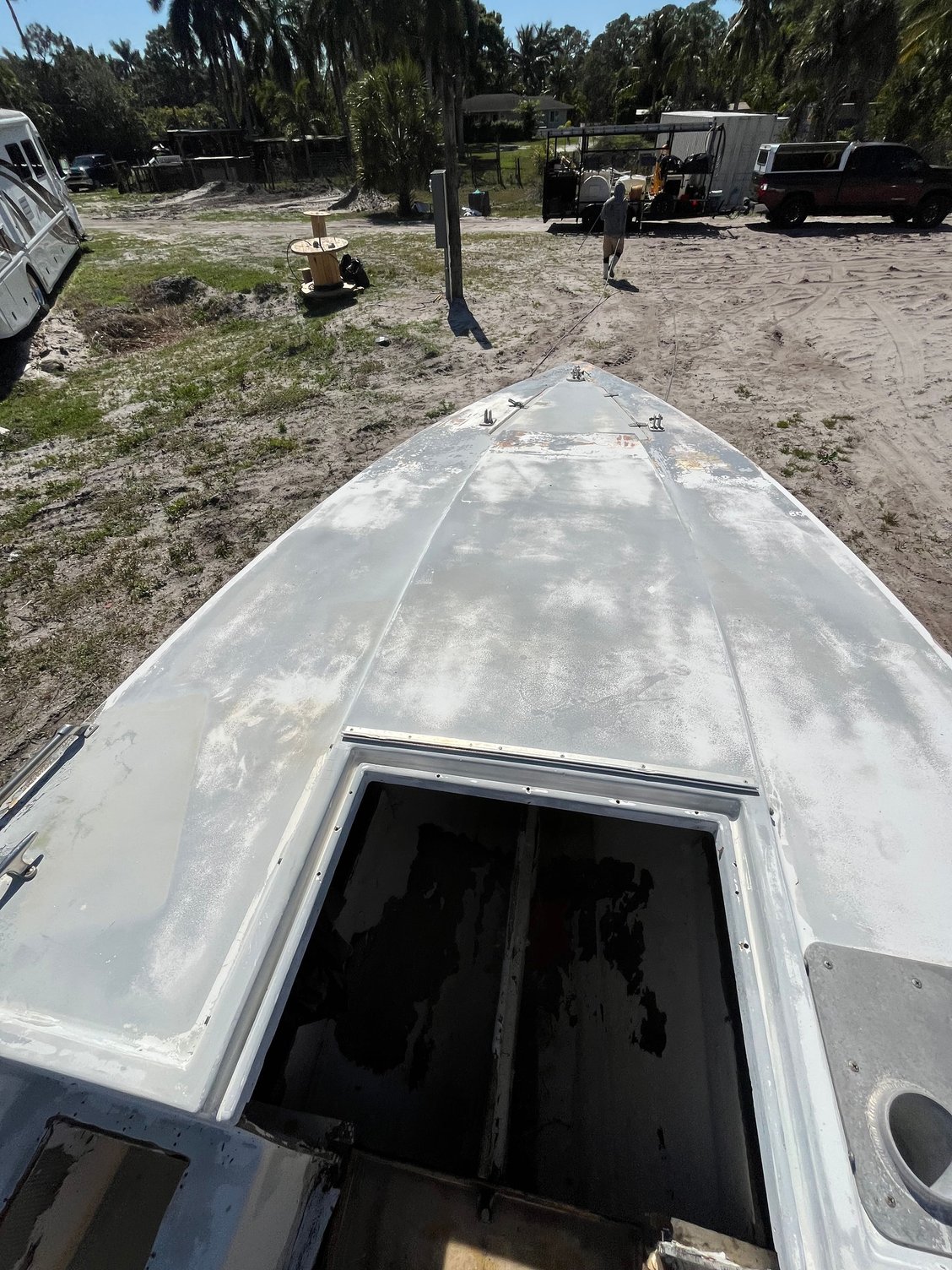

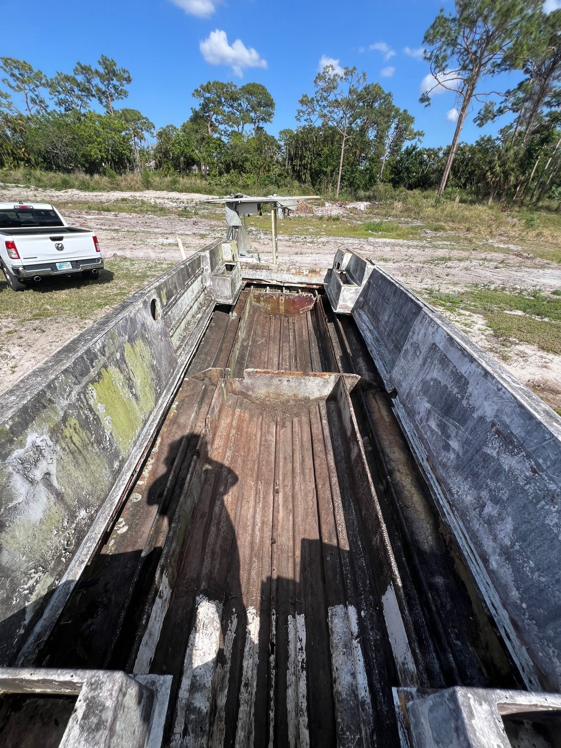

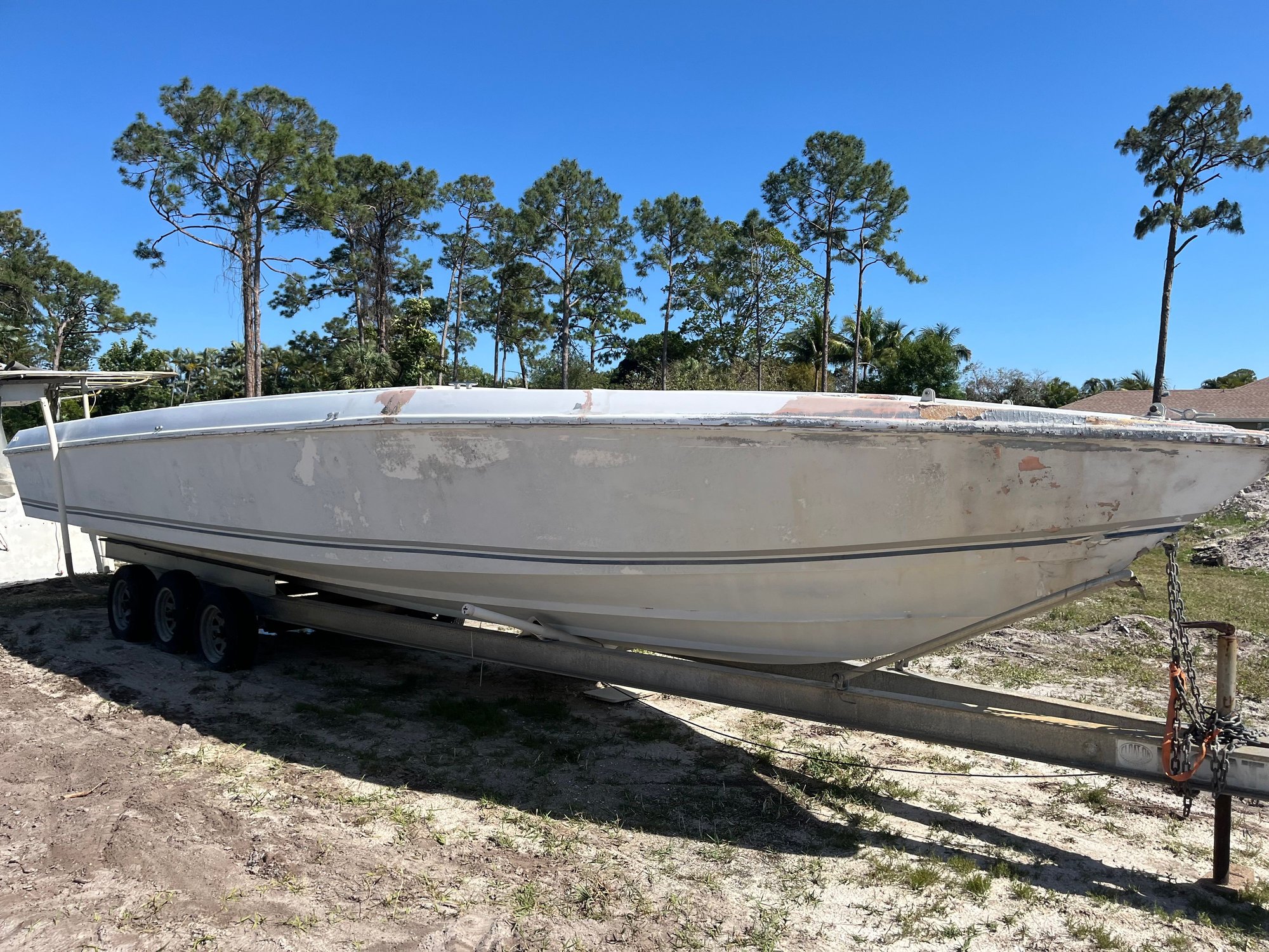

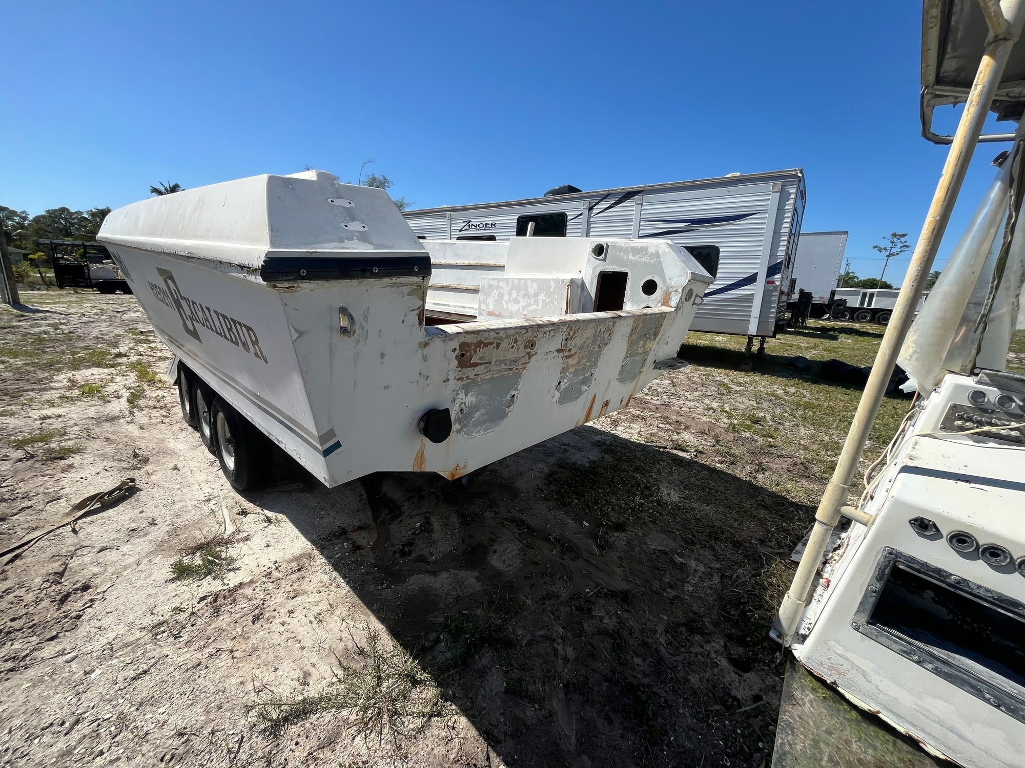

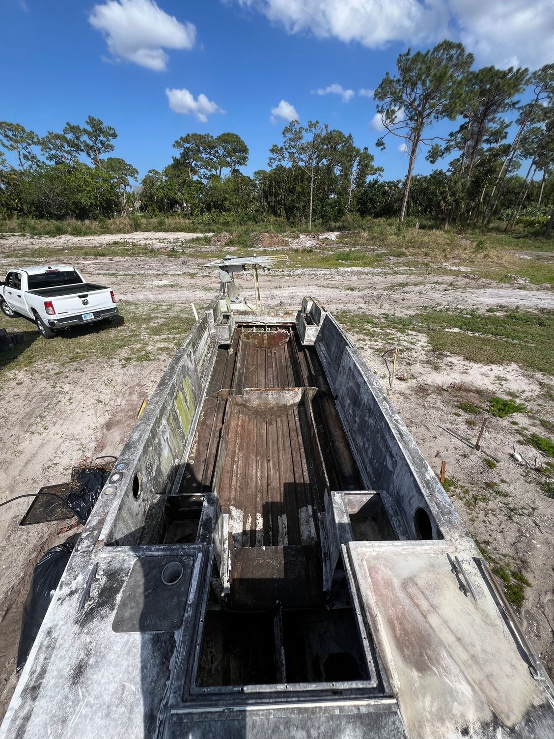

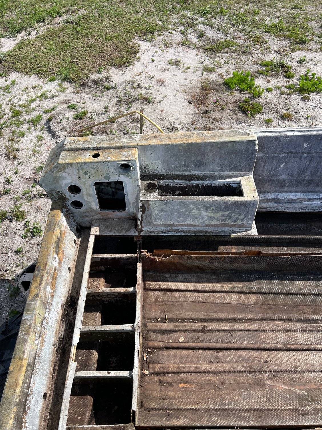

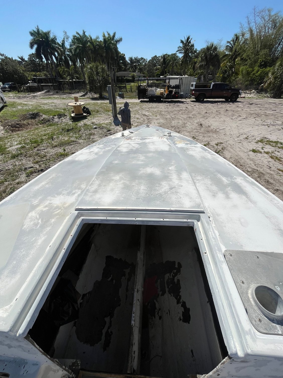

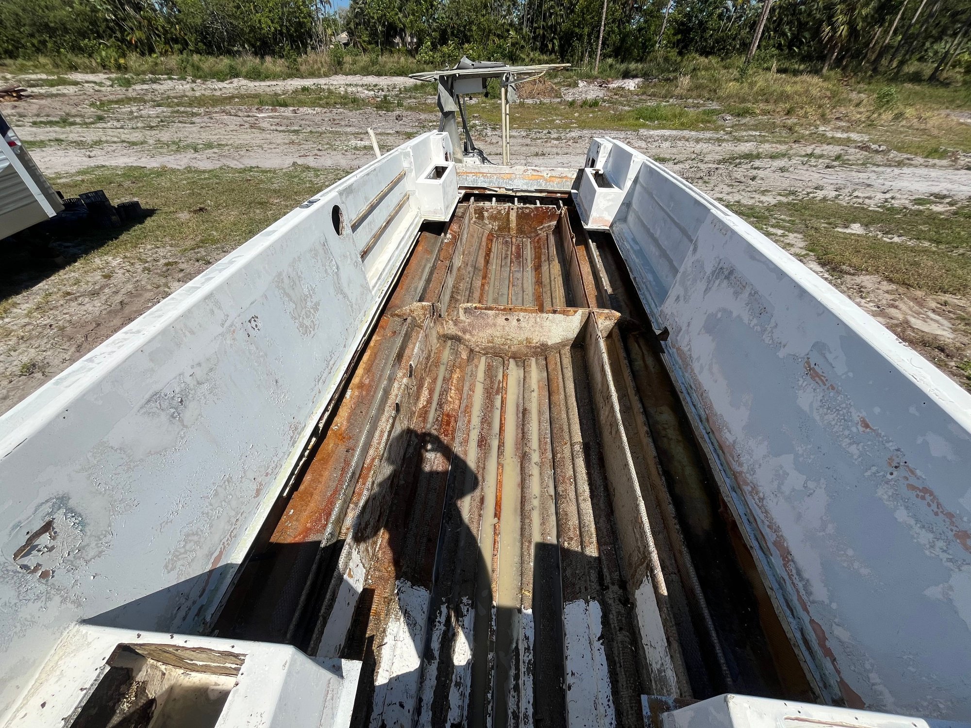

Hello all purchased a 1981Excalibur from a widow in fl it was her husbands boat but it has been sitting for over 20 years. Trying to get a bit more information about them I remember all the speed boats but any information on the center consoles would be appreciated.

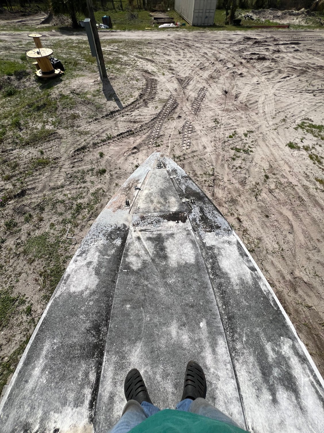

Pics
https://cimg9.ibsrv.net/gimg/www.off...414160fc9.jpeg
https://cimg1.ibsrv.net/gimg/www.off...213c770bc.jpeg
https://cimg4.ibsrv.net/gimg/www.off...9f96d3def.jpeg
https://cimg5.ibsrv.net/gimg/www.off...49c5fa188.jpeg
https://cimg6.ibsrv.net/gimg/www.off...9025473d5.jpeg

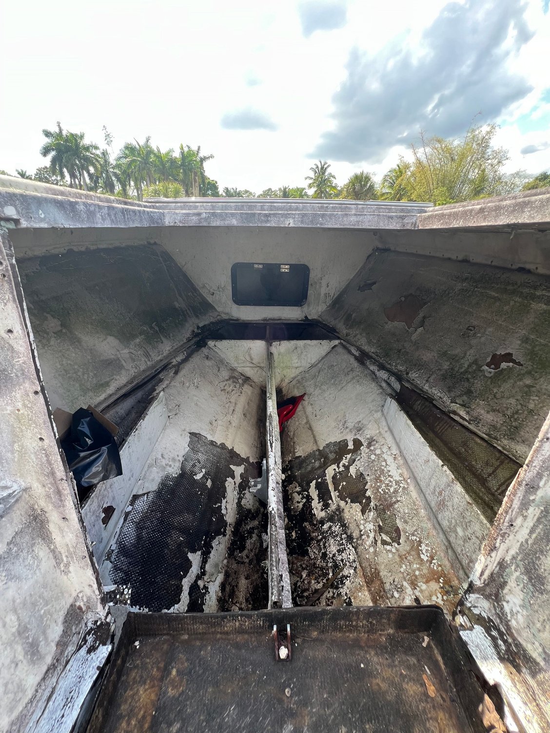

242Donzi 03-24-2025 05:39 PM
Next pics hull will be pressure washed and vacuumed out. Then I can begin getting new stringers and coosa boards for full rebuild
Drake22.250 03-24-2025 06:02 PM
Damn, Share the same issues. Good luck with the project!!! Keep the pictures coming
F-2 Speedy 03-24-2025 06:29 PM
You paid for that............:D........must be young to tackle a project like this, whats the single exhaust flapper for ? generator
242Donzi 03-24-2025 06:35 PM

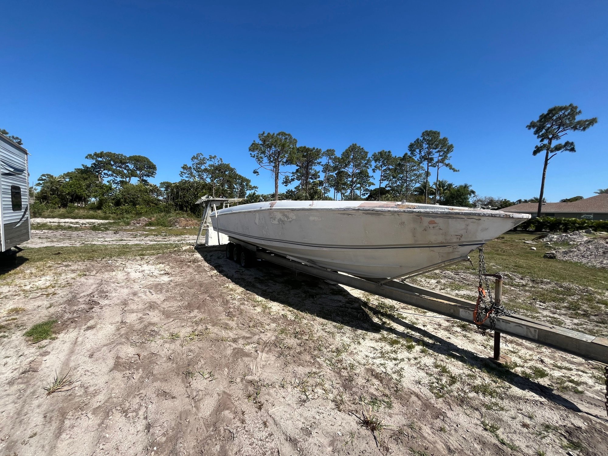

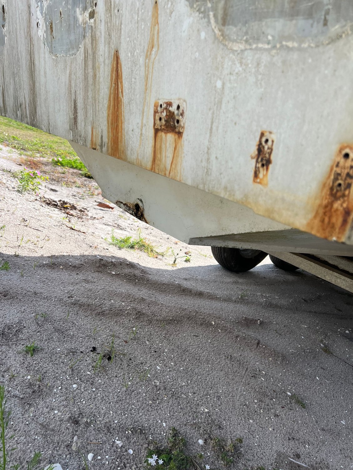

Drake22.250 03-25-2025 04:14 AM
I'm confused, looks like it had a triple egg beater set up but then a single through hall exhaust. Must have been one of Willy's Smuggling rides. :cool-smiley-027:

TxHawk 03-25-2025 07:56 AM
I saw your PM. What is the Hull ID? I see a couple hints of Excalibur but not in the deck. It looks like it has notched transom and a pad.

242Donzi 03-25-2025 08:06 AM
same thing I said it had triple mercs but what’s the generator flap about lol. I couldn’t pass this project up I can tell it has some history

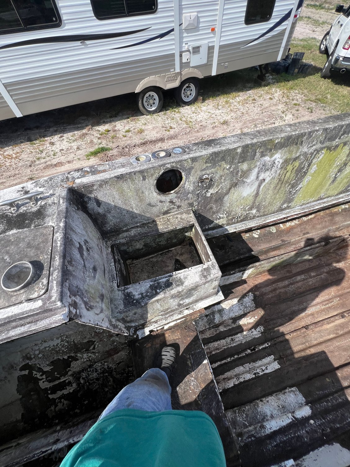

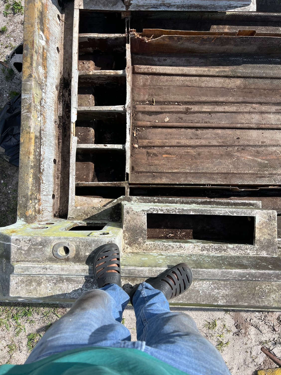

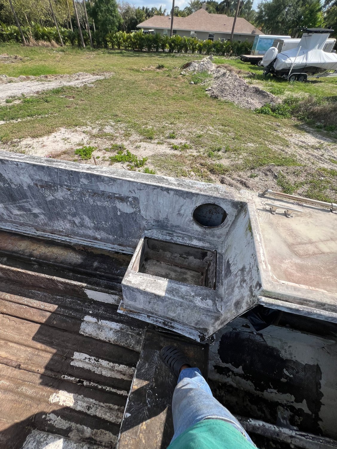

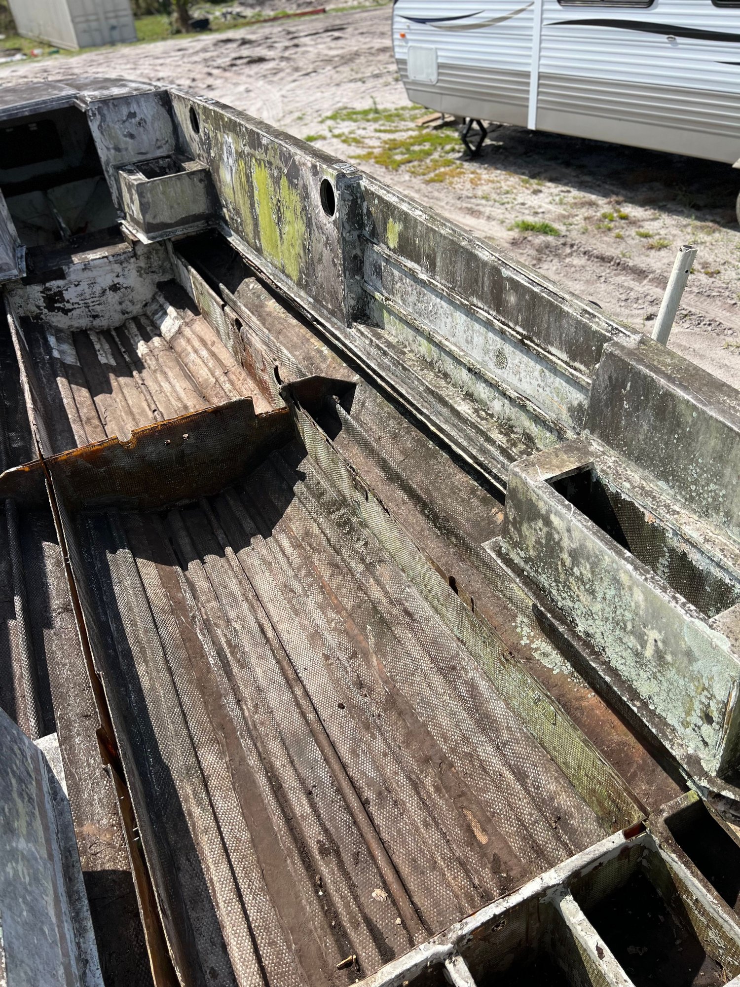

242Donzi 04-09-2025 08:53 PM
Update teardown
Well today I moved it to storage. And was able to start cleaning out hull by hand as no electricity or water but I am arranging a pressure washing and I’ll bring my generator for the cutting. Once pressure washed I’ll post more pics and will begin the rebuild
https://cimg8.ibsrv.net/gimg/www.off...603d67479.jpeg
https://cimg9.ibsrv.net/gimg/www.off...acc600784.jpeg
https://cimg0.ibsrv.net/gimg/www.off...867082d03.jpeg
https://cimg1.ibsrv.net/gimg/www.off...18922d7d9.jpeg
https://cimg2.ibsrv.net/gimg/www.off...a383cf256.jpeg
https://cimg3.ibsrv.net/gimg/www.off...cae71d65a.jpeg
https://cimg4.ibsrv.net/gimg/www.off...d3ea369c7.jpeg
https://cimg5.ibsrv.net/gimg/www.off...1b151ba8d.jpeg
https://cimg6.ibsrv.net/gimg/www.off...abc986e0e.jpeg
https://cimg7.ibsrv.net/gimg/www.off...fabf89d74.jpeg
https://cimg8.ibsrv.net/gimg/www.off...8244412de.jpeg
https://cimg9.ibsrv.net/gimg/www.off...a9b930503.jpeg
https://cimg0.ibsrv.net/gimg/www.off...6c505d9eb.jpeg

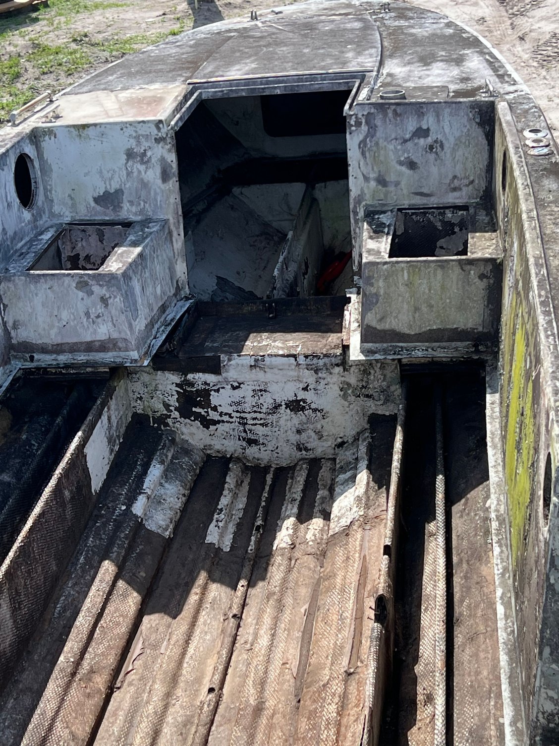

242Donzi 04-09-2025 08:55 PM
More info on hull
So I was told by the widows brother that her husband got it brand new custom made in 81 from Excalibur he told them what he wanted based on his commercial fishing in Bahamas. I’m not sure if it’s a one of one but it’s a strong hull for sure.

Pad and notch like a Velocity

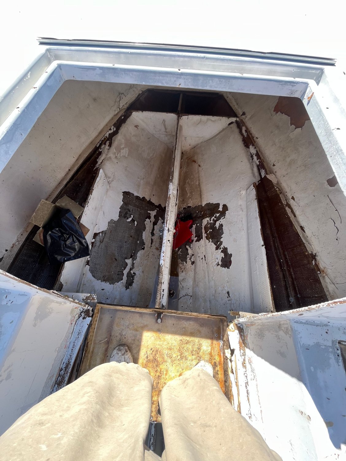

242Donzi 08-02-2025 09:01 AM
More pics
[img alt="She looking good but going to start cutting and creating templates for new stringers and transom
This week. Still trying to decide if I’m going to keep the cabin or remove it "]https://cimg2.ibsrv.net/gimg/www.offshoreonly.com-vbulletin/2000x1504/img_4012_b014d81122e630f85f6eca8169f51ea9ee28ed71. jpeg[/img]
She looking good but going to start cutting and creating templates for new stringers and transom This week. Still trying to decide if I’m going to keep the cabin or remove it
