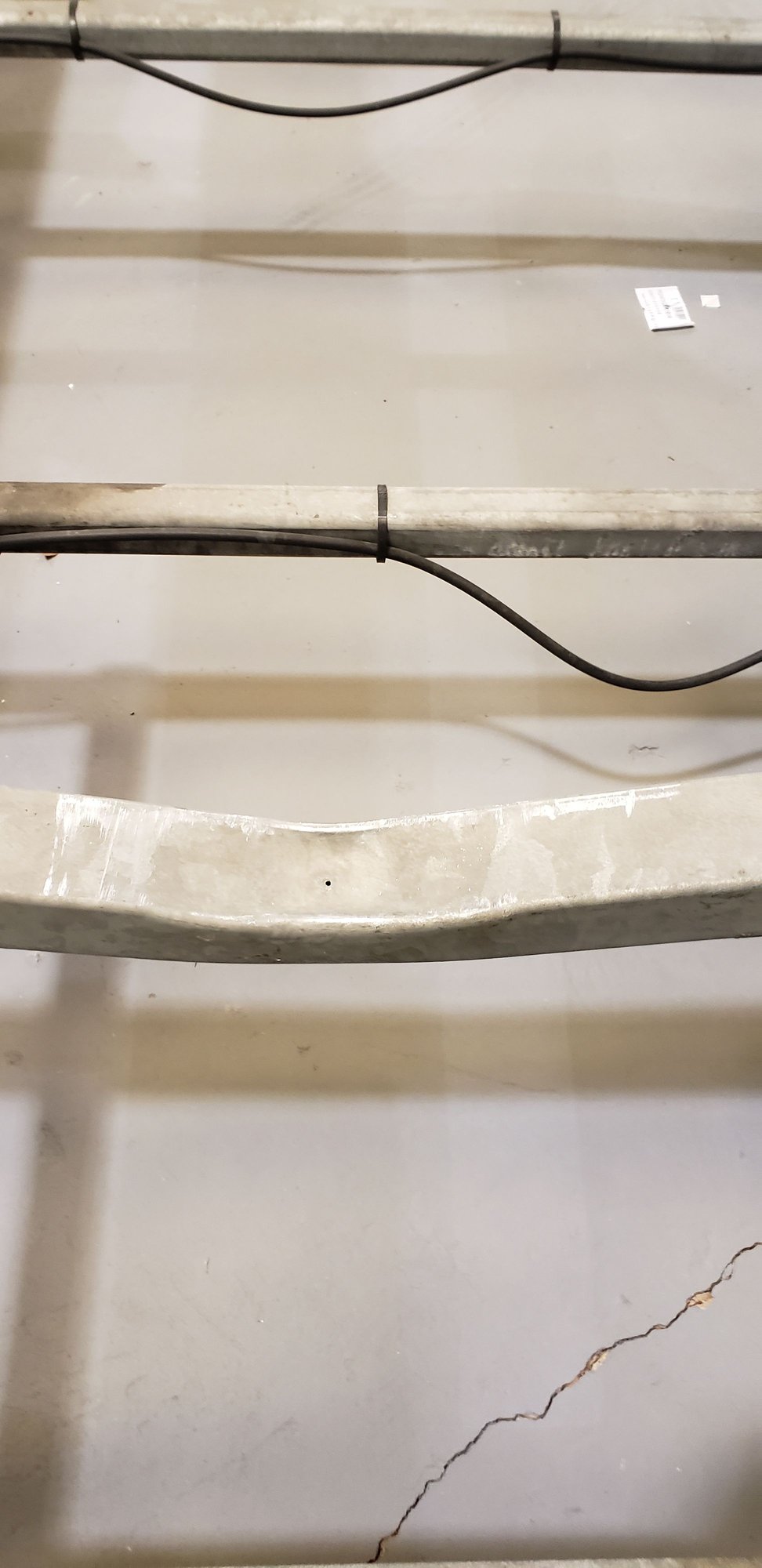

glassdave 07-31-2019 04:19 PM
yikes, yeah thats a pretty good ding'er there . . . .
The number is fair, it is a pretty good size area that will have to be scarfed back to catch all that. Just make sure your repair facility has plenty of references and is capable of handling structural damage. They should be doing this in Epoxy or VE at the very least. Would also be nice to access it from the inside even if it means opening up some floor panels, personally i would rather have live with some floor repairs or snap in carpet for the peace of mind knowing it have some tie-in lamination on the inside.
Honestly it does look like an extreme hard trailer drag to me and I've seen more then a few . . . . hell i even did one almost that bad myself on a windy fall day lol . . . i was not happy but hey i kniw a guy that could fix it :D

770guy 07-31-2019 05:20 PM
Dave,
Thank you for the input! I am fairly certain this thing hit the trailer....there is gray galvanized paint marks on the areas that didnt break and the first cross member on the trailer has white marks on it.
As far as the repair goes, the place had good reviews and structural experience. They said they were going to repair it from the inside out and "cross stitch". Its a set back but it has not killed my enthusiasm (yet).

I went by and took a look at the boat this morning and the trailer now that the boat is off. I snapped a few pics. Couple more posts and I can put them up. I have been a lurker for too many years.
770guy 08-01-2019 04:14 PM
Here is the trailer. Taking it back to my shop to raise the bunks and once the boat is fixed I may adjust side to side depending on how they fall on the hull.. Yikes. I cant believe the guy didnt care enough to stop driving it on the trailer. I always at least pull the trailer in enough to wet the bunks also.....

770guy 08-01-2019 06:15 PM
Here is a full pic of the boat. It has lived a rough life, needs some TLC, but ive seen much worse.https://cimg0.ibsrv.net/gimg/www.off...786b6695f2.jpg

770guy 08-16-2019 12:43 PM
Originally Posted by Baja Rooster (Post 4699871)
Gorgeous boat worthy of some love!
Id add some rear bunks as well to support the engine and transom.
That is a good idea and I am going to do it. I was looking at a person with the same boat and the factory trailer and it had bunks at every chine. I went ahead and raised the existing bunks 3.5". I made these stainless brackets.
https://cimg4.ibsrv.net/gimg/www.off...0e02479bb9.jpg
https://cimg5.ibsrv.net/gimg/www.off...ce9569ca83.jpg
https://cimg6.ibsrv.net/gimg/www.off...78fb5391dd.jpg
https://cimg7.ibsrv.net/gimg/www.off...2f3c6d82dd.jpg
https://cimg8.ibsrv.net/gimg/www.off...19db5d6568.jpg
Tinkerer 08-16-2019 08:25 PM
I would have put one bolt in the top hole and one in the bottom. I don't think one bolt is enough.
Nice brackets.
That nd you definitely need bunks under the stringers that the engines are bolted to.
