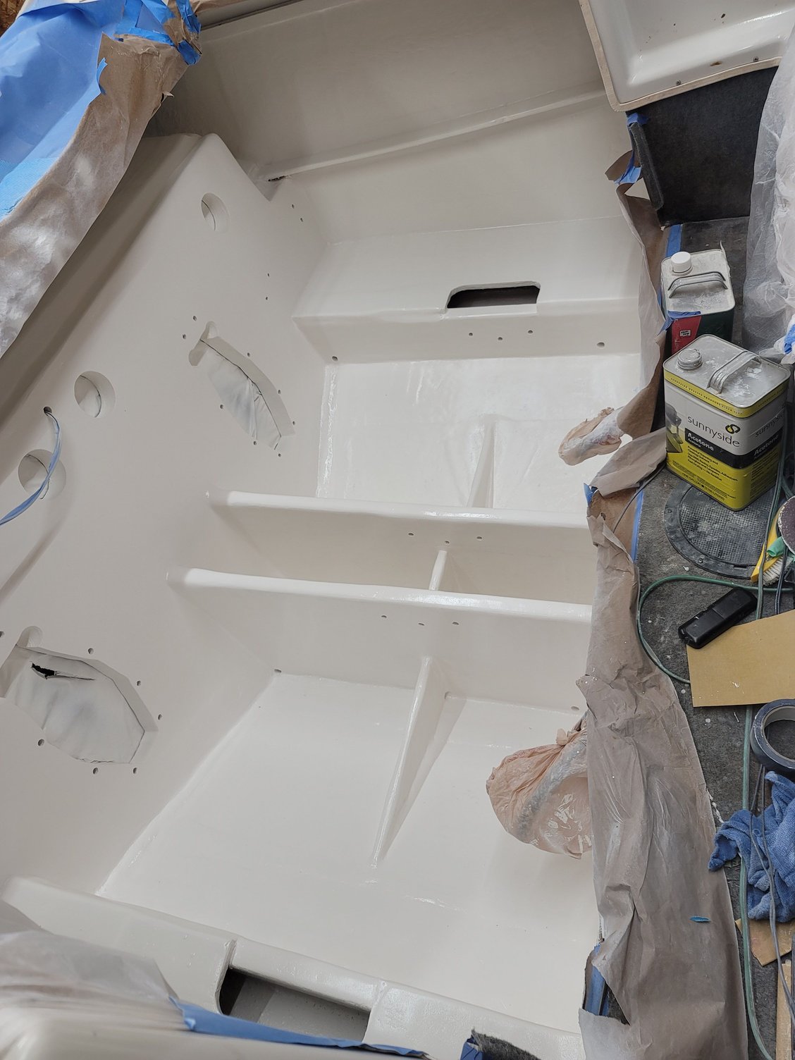

All holes are drilled in the transom, and the keyholes are cut. I used gel coat to seal the exposed wood so I can hopefully avoid this fiasco again.
A quick coat of gel coat as a "filler" primer to sand before rolling and tipping the last coat. Then I'll be using Awlgrip to paint the compartment.
https://cimg6.ibsrv.net/gimg/www.off...2558372fee.jpg
Thankfully a local boat shop let me borrow their outdrive fixture so I could drill the holes correctly.

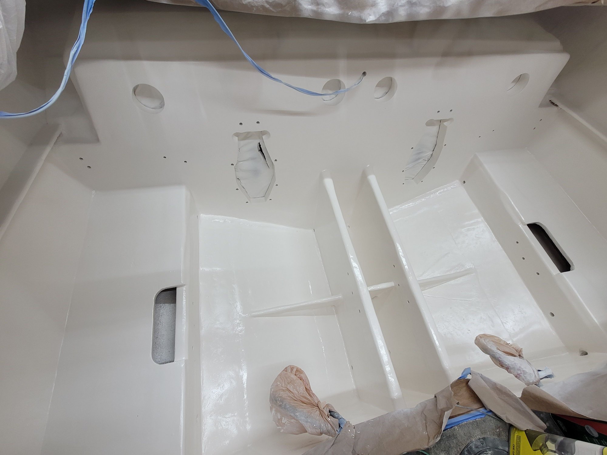

Speed0verdose 05-08-2023 08:07 PM
2nd coat, gelcoat doesn't cover as well as i thought it would

scarabman 05-09-2023 07:56 AM
What is the concern with Gel coverage if you are finishing with AwlGrip?
Speed0verdose 05-09-2023 04:23 PM
none, just something I noticed and wanted to share with anyone that reads this.

jeff32 05-10-2023 07:40 PM
https://cimg4.ibsrv.net/gimg/www.off...a8c2387674.jpg
looks good from that picture !!!

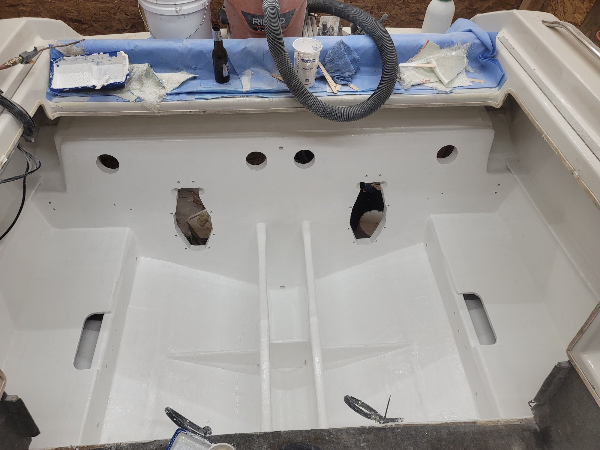

Speed0verdose 05-16-2023 09:20 PM
I changed gears and decided to use TotalBoat Total Bilge. I just didn't have the time to properly go through the steps needed for AwlGrip before the shop needed me to bring it in to reinstall the engines before the Kuttawa Cannonball Run.
So...... It's done

PQ290Enticer 05-17-2023 03:46 AM
That looks great! Mine looked extremely clean too.....for a while. Now trashed. Hard to keep clean especially after all the leaks I've had. Luckily in the 290 you really can't see much except the center section.

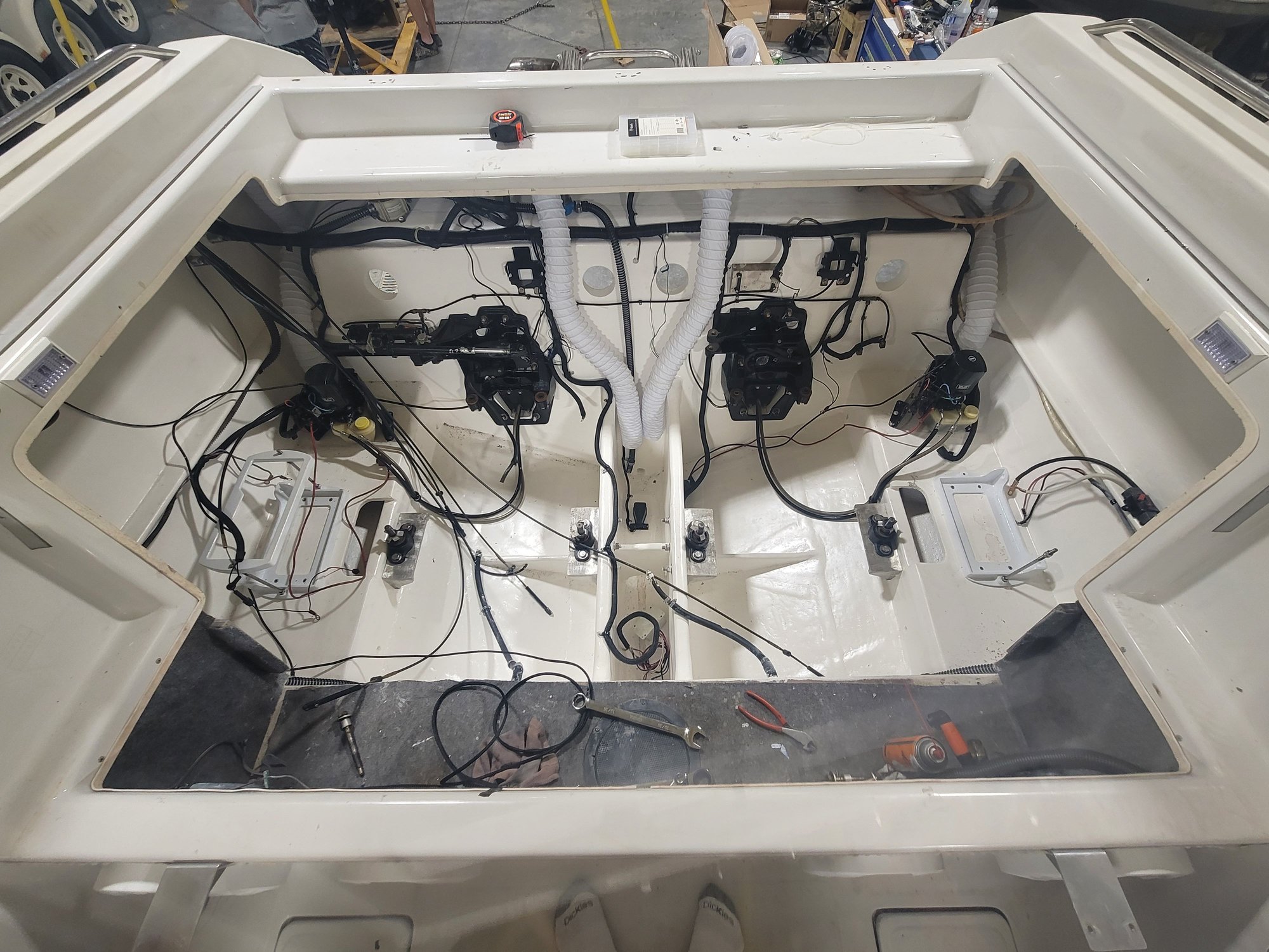

Speed0verdose 06-06-2023 09:03 AM
I spent a long time wiring and plumbing the compartment.
Every screw that went into the transom, stringer, or bulkhead was coated with Life Caulk. https://cimg2.ibsrv.net/gimg/www.off...4a855743b7.jpg
