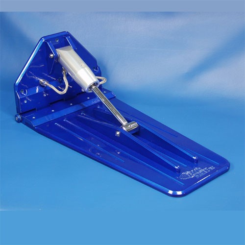

007joe 04-05-2008 07:41 AM
trim tab install
how difficult is it to install tabs? seems simple enough, but i have a couple of questions.
when drilling through the transom do you use resin to seal the exposed core or a marine silicon (or both)?
what do you use behind the actual tabs, i am assuming a good marine silicone?
should i make some kind of backing plates for where everything is going to be mounted?
i am also looking at having them professionally done.... not sure which way i'm gonna go yet
thanks!

007joe 04-05-2008 08:08 PM
garrett,
i did get the dash mounted indicators, how did you mount yours?
also mine did not come with any mounting hardware...
thanks for the info
joe
007joe 04-05-2008 08:10 PM
1 Attachment(s)
Attachment 334945 these are the ones i got
sunchaser796 04-06-2008 01:43 AM
I did a set of tabs on a 45 Sonic. If I remember correctly, 3/4 inch fron the bottom edge of the hull. You want to keep the tabs out of the water flow when not needed. Use boat life caulk or 3m 101 sealant. DO NOT USE 5200 or silicone under the water line. Backing plates only if no wood is present..
