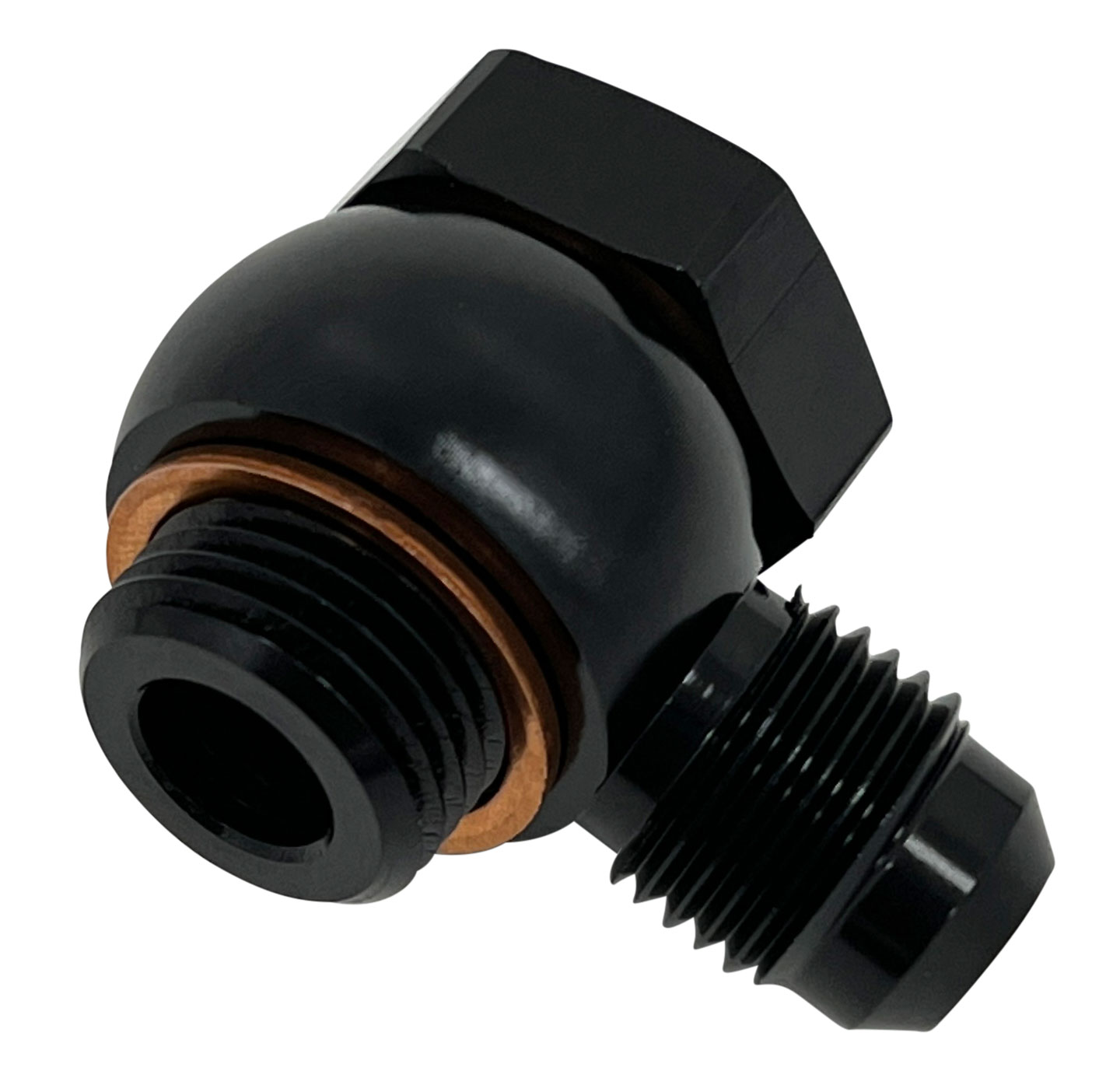

tunertech 04-19-2012 09:06 PM
https://www.google.com/search?rlz=1C...4d42831c954613
google banjo bolt. I saw a setup once the basically replaced the pressure line from the pump. I will dig into it a little more.
Many brake line components use banjo bolts.

c_deezy 04-20-2012 06:41 PM
Here is the banjo fitting:
http://www.cpperformance.com/p-11506...o-fitting.aspx
http://www.cpperformance.com/images/...e/136-1013.jpg
