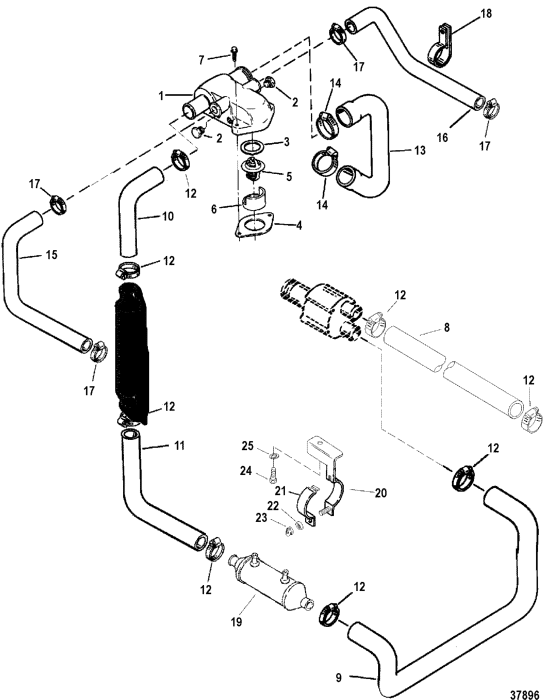

[ATTACH=CONFIG]504547[/ATTACH]
If your thermo housing looks like this...... Make sure the upper gasket (3) is there and (6) is in good shape
Without them in good shape it can run so cold the gauge will not move.
You can just touch the sending unit with your finger as it warms up to see if you are building heat.
(It could be why it works after it sits the water heats up)
