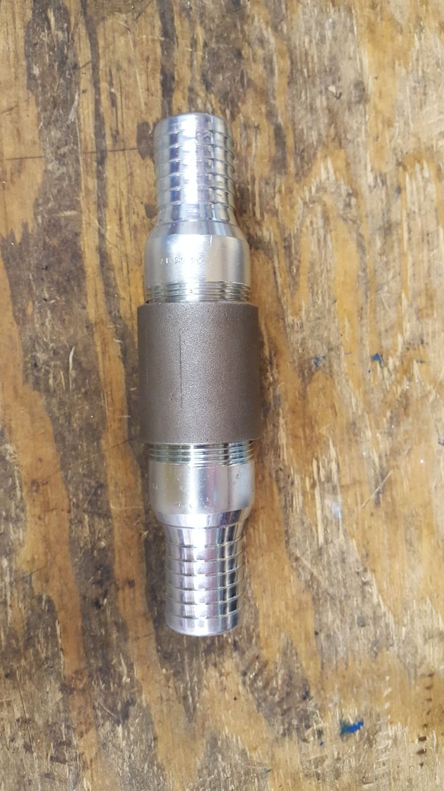

DiamondPerformance 05-18-2020 05:07 PM
That's what I did, bilge was always wet, did away with the air systems, no more wet bilge.

Sydwayz 05-19-2020 08:32 AM
Originally Posted by Gklado (Post 4739592)
Sorry 2 years late. The actuator is discontinued. Looking to bypass with pipe. Cant find anything that has two ended barbs. Where did you find yours
It wasn't barbs. It was just a length of pipe that had threads on both ends, that was the right outer diameter.

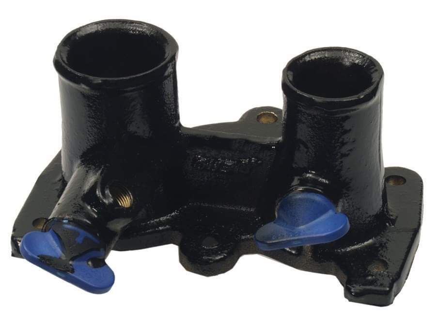

AllDodge 05-19-2020 09:22 AM
Another option P/N 861505
