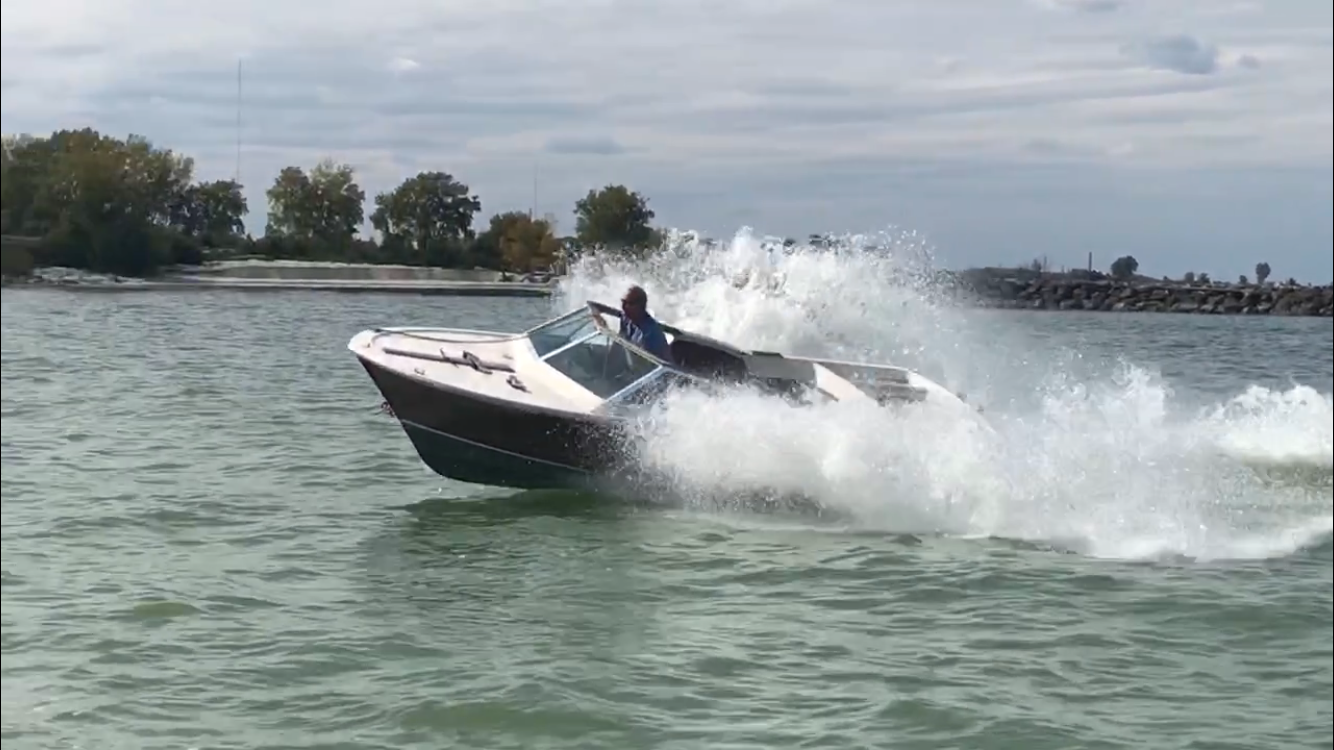

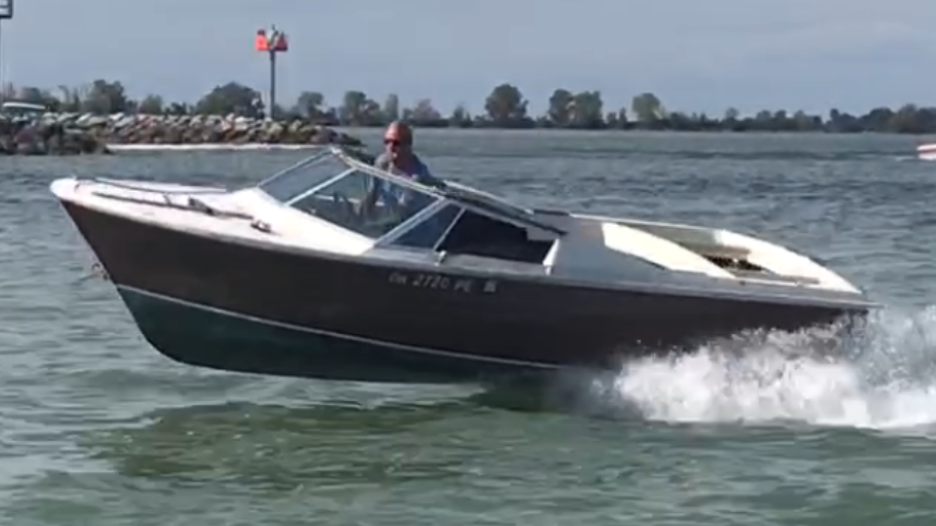

I’m back. The Lyman runs out to 40 mph on gps. Having trouble with the carb, won’t idle right. Seems a little slow, was hoping for close to 50. Kind of hard driving it with no seats, or floor.

smashm 10-23-2020 10:05 PM
Congrats on finally getting it out for a good run. Looks like a fun little boat. Great heritage with a Lyman. Enjoy!!
mike tkach 10-23-2020 10:20 PM
she,s bad azz.glad to see it running.
donzi matt 10-24-2020 07:11 AM
That's a great little boat and looks like a very similar hull to the Chris Craft 19 Lancer. I own a 1969 Lancer with a 283F (flywheel aft, like most conventional I/O's) and it is a wonderful boat. That 307Q motor (flywheel forward) is a good little engine and should push that boat into the mid 40's if it is healthy. Careful when winterizing, there is water that gets trapped in the intake manifold and will crack the bottom of the intake. There is a plug on top you can remove and suck the water out with a turkey baster. Glad you are on the water with it and thanks for taking us on your journey about the boat.
