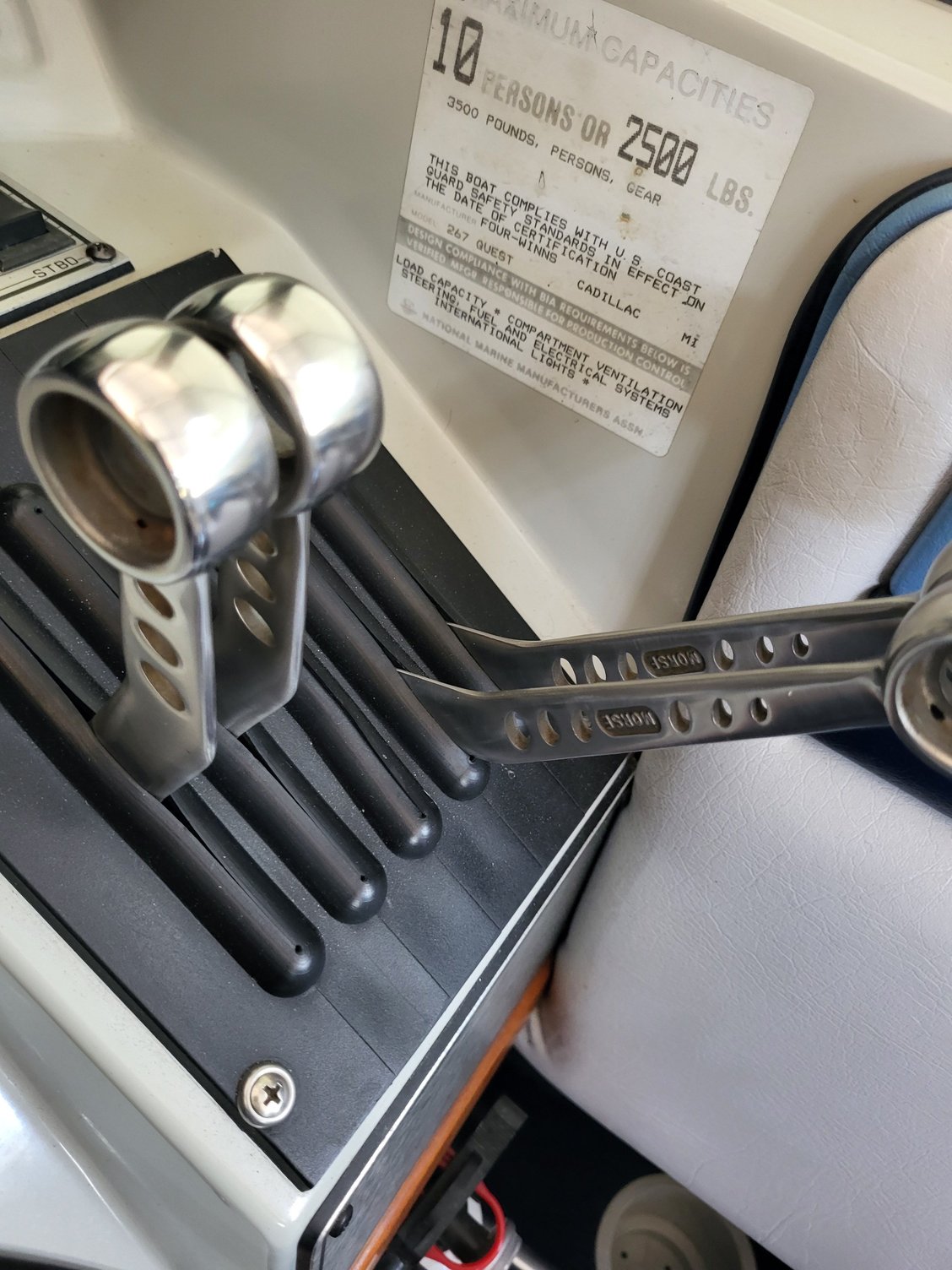

powerboatr 10-16-2025 09:59 AM
i know this is an old post
but my 261 has Morse plson
plain alum big item on side of binnacle
throttles have holes for trim switch..but be dammed i cant find one
https://cimg9.ibsrv.net/gimg/www.off...bbdd9adaca.jpg
https://cimg1.ibsrv.net/gimg/www.off...aa27394391.jpg
gaffrig has several that look like direct bolt ins with trim switchs
in fact if order them i will post up the part numbers
i have to go get a few pics for them to verfiy fit etc
gaff
Griff 10-25-2025 04:09 PM
Those never came with built in trim switches on the controls
You may able to make these work Throttles Archives - Livorsi Marine, Inc.
