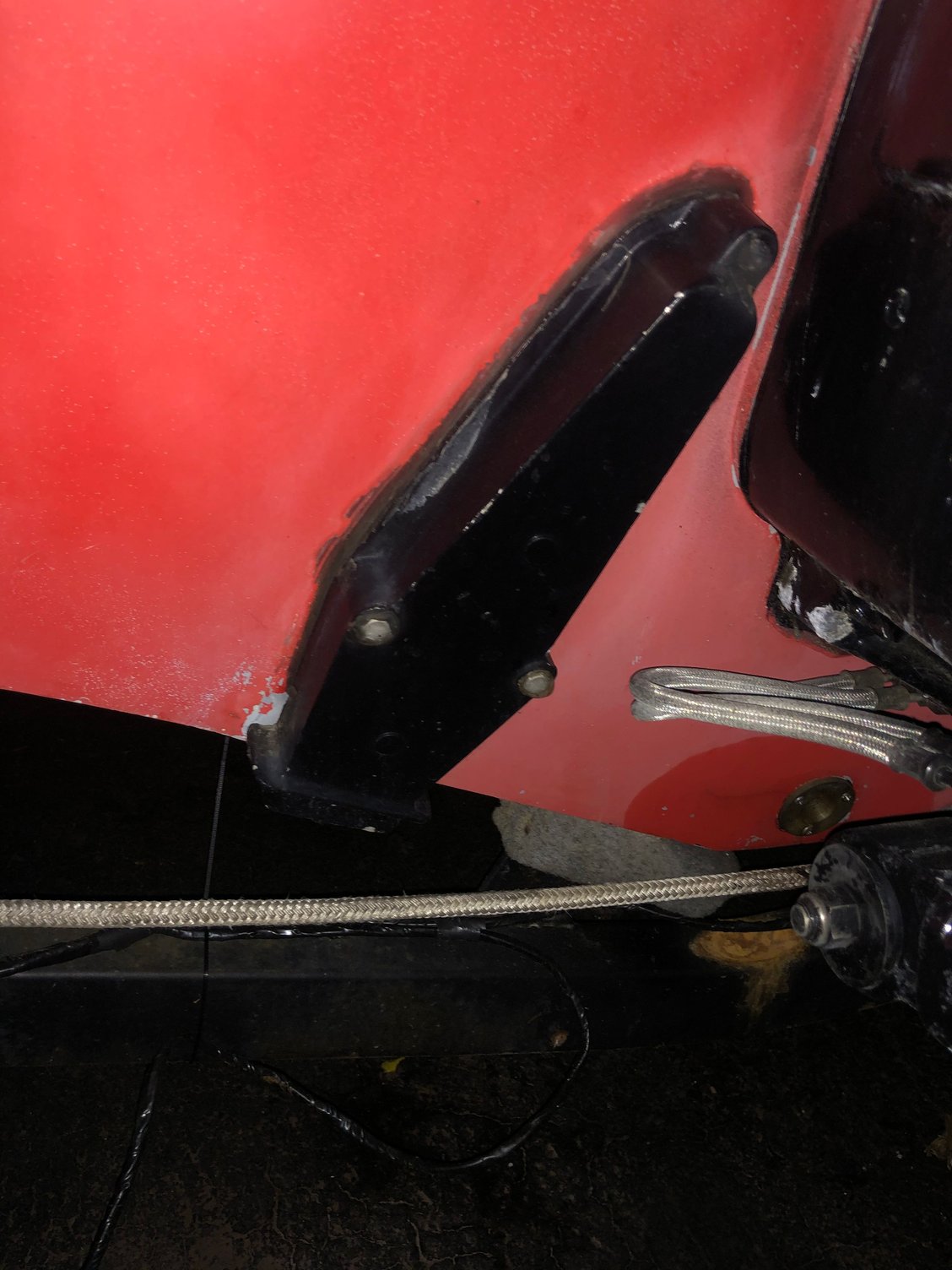

21eagle 06-10-2020 08:07 PM
Those pickups fit on this?
https://cimg6.ibsrv.net/gimg/www.off...06031216a.jpeg
BDiggity 06-12-2020 09:54 AM
Those are the same pickups i had on mine. The Teague ones used the same inlet hole. I still will need to figure out proper length to make sure they provide optimal pressure while at speed.
21eagle 06-12-2020 10:03 AM
Yea this is flush with hull I’d think tube down an inch or two?
