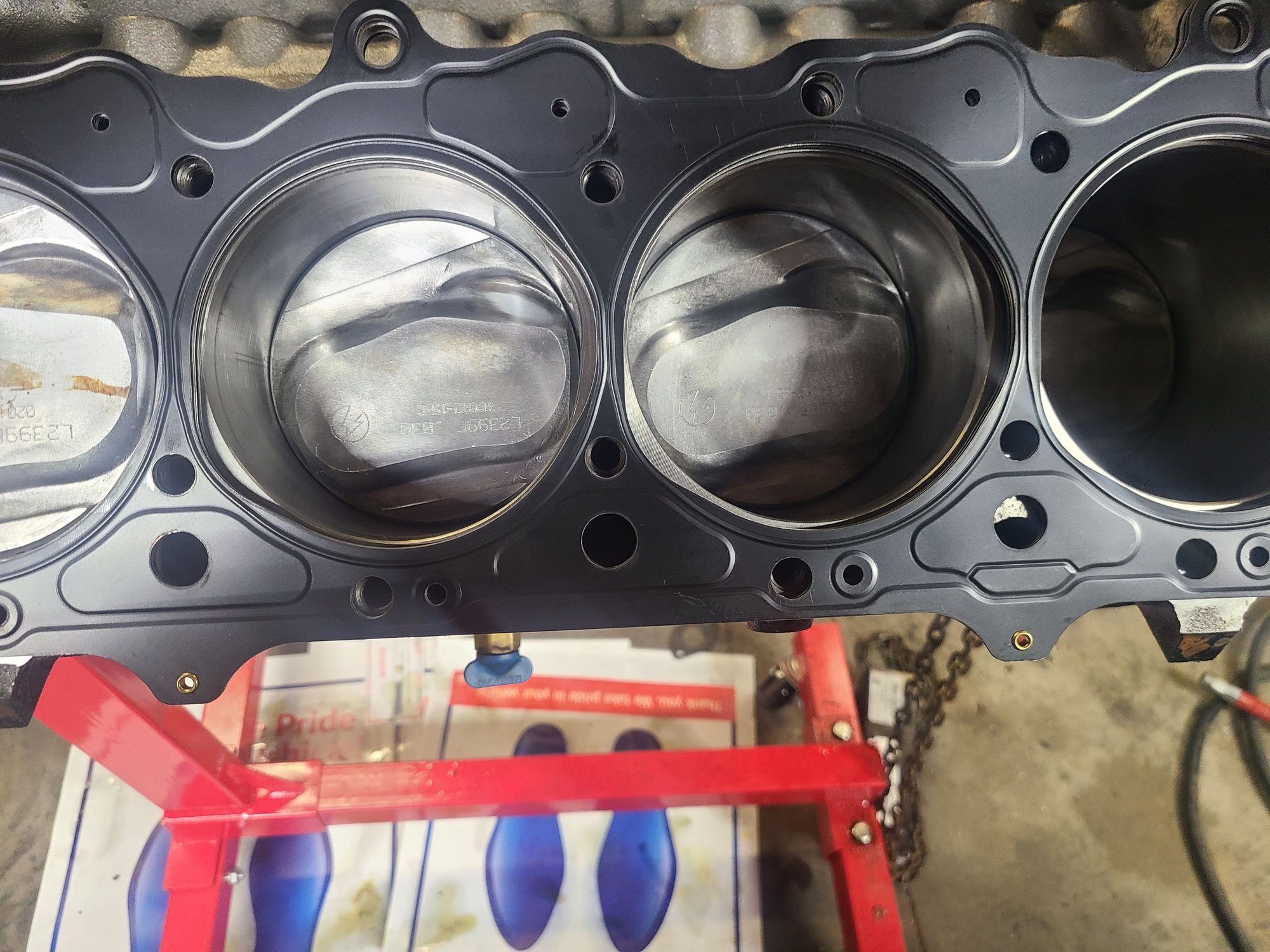

Baja 250es 03-10-2021 09:42 PM
Hit the brakes I have problems
Hold up wait a minute something just ain't right
https://cimg1.ibsrv.net/gimg/www.off...f8d1621668.jpg
Was some one at cometic drink the Friday this was made out am i stupid check out the fast right coolant port any one ever seen this cometic mls gasket 0.60 thick wtf do i do about this and also answer to the above question thanks oso

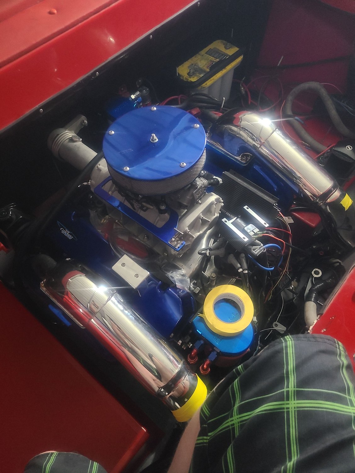

Baja 250es 06-11-2021 12:41 PM
Getting it back together
https://cimg8.ibsrv.net/gimg/www.off...0161e89a9e.jpg
I know it's been a while since i posted but putting it back in
