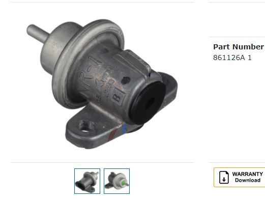

Looks like I'm not getting notified of a response via email. What I have for Reg861126A1 Cool Fuel Gen 2 (43 psi) BLUEMallory 9-33206, Merc 892681
Basketcase 05-12-2022 07:19 AM
Kinda funny. Someone on a FB group pointed out that the OEM part is made by Keihin and is the same reg as a honda civic. See photos.....IDK if I trust it enough to do it, but its interesting for sure.
https://cimg6.ibsrv.net/gimg/www.off...db509533ee.jpg
https://cimg7.ibsrv.net/gimg/www.off...d721c5b27b.jpg

SB 05-12-2022 07:43 AM
I believe there is a 30psi keihin nr-1 and a 43 psi nr-1. So, be careful.
