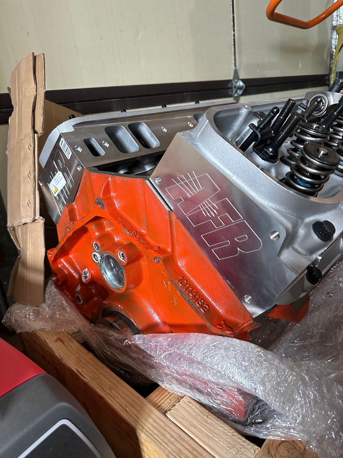

Back to working on the 496.
https://cimg1.ibsrv.net/gimg/www.off...6e2a001b6.jpeg
Gota get pushrods. Somewhere around 8-10 inches
https://cimg4.ibsrv.net/gimg/www.off...94dfe5b43.jpeg
xlint89 04-22-2023 06:20 PM
Is that a steel freeze plug?
sutphen 30 04-22-2023 06:22 PM
its the back of the camshaft journal,,its always steel.
Batmeat 04-22-2023 07:34 PM
correct
