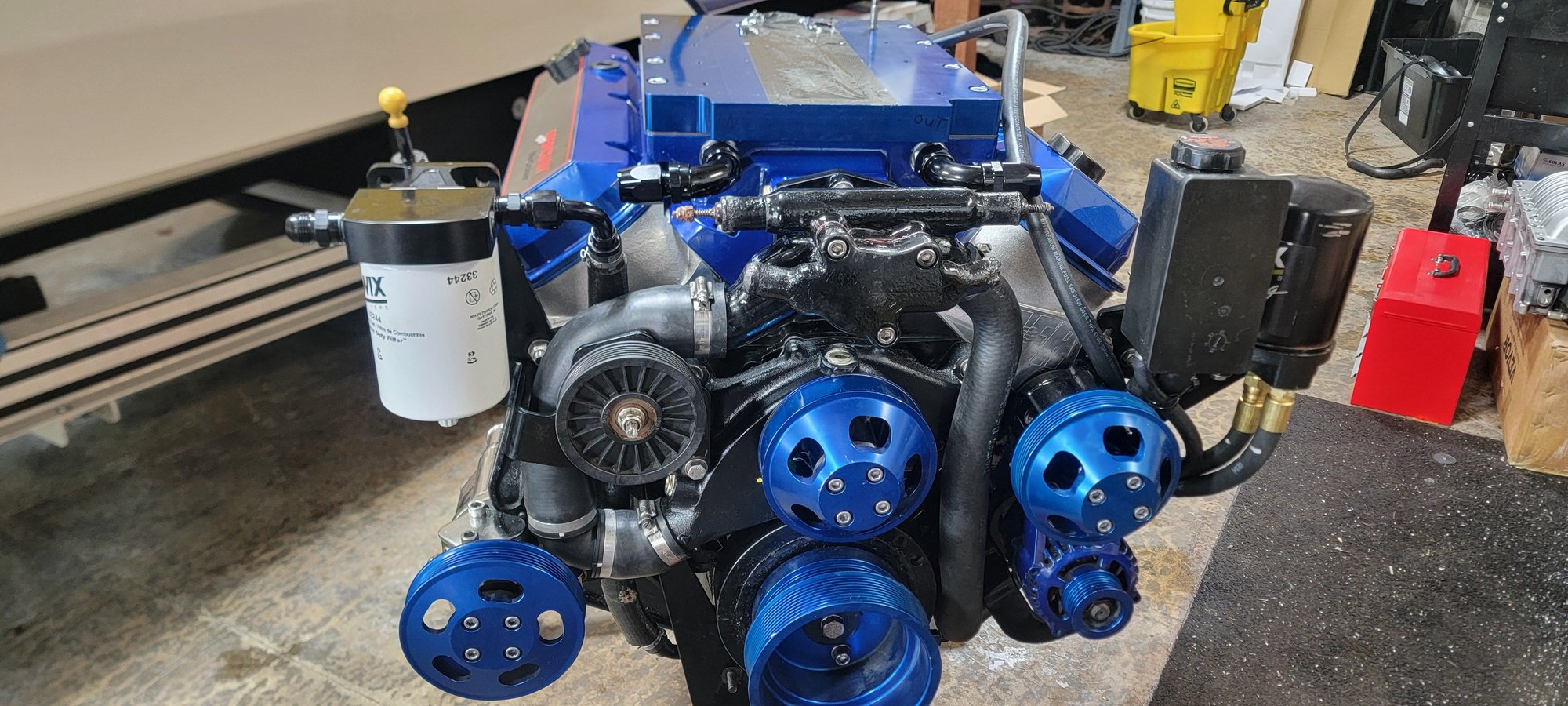

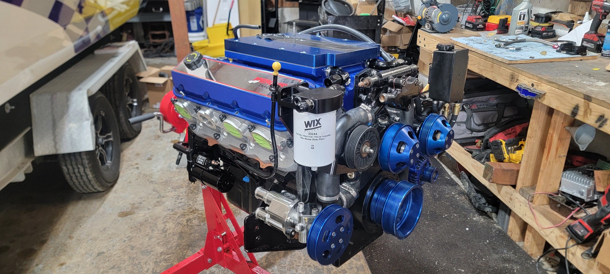

https://cimg3.ibsrv.net/gimg/www.off...aeb5264449.jpg
https://cimg5.ibsrv.net/gimg/www.off...de8a3f97ee.jpg
Sci 575 upgrades coming along.
hpmaniac 05-03-2026 01:04 PM
Upgrades are these
my spec hydraulic roller, 241 251 637 621 intake on a 114 installed at 110.5 intake cenerline.
gm hydraulic lifters.
Afr full cnc 315 head with inconel exhaust valves.
young performance fuel system and injection upgrade with his tuning.
Whipple intercooler.
Stock 575 bottom end, only had 111 hrs on her. Compression specked out at 7.8. I rolled new h series main bearings just because along with a melling hv pump. Young performance double roller chain that he has custom built for him.
new mercury starter, water pump, oil lines.
New blower shop 250 replacement blower with a 3.35 pulley. I really went back n forth on blower, I already had the whipple intercooler so I decided to stick with the smaller blower. I'm looking for between 750-800 hp so this little blower with the whipple will do the job and should be very reliable.
