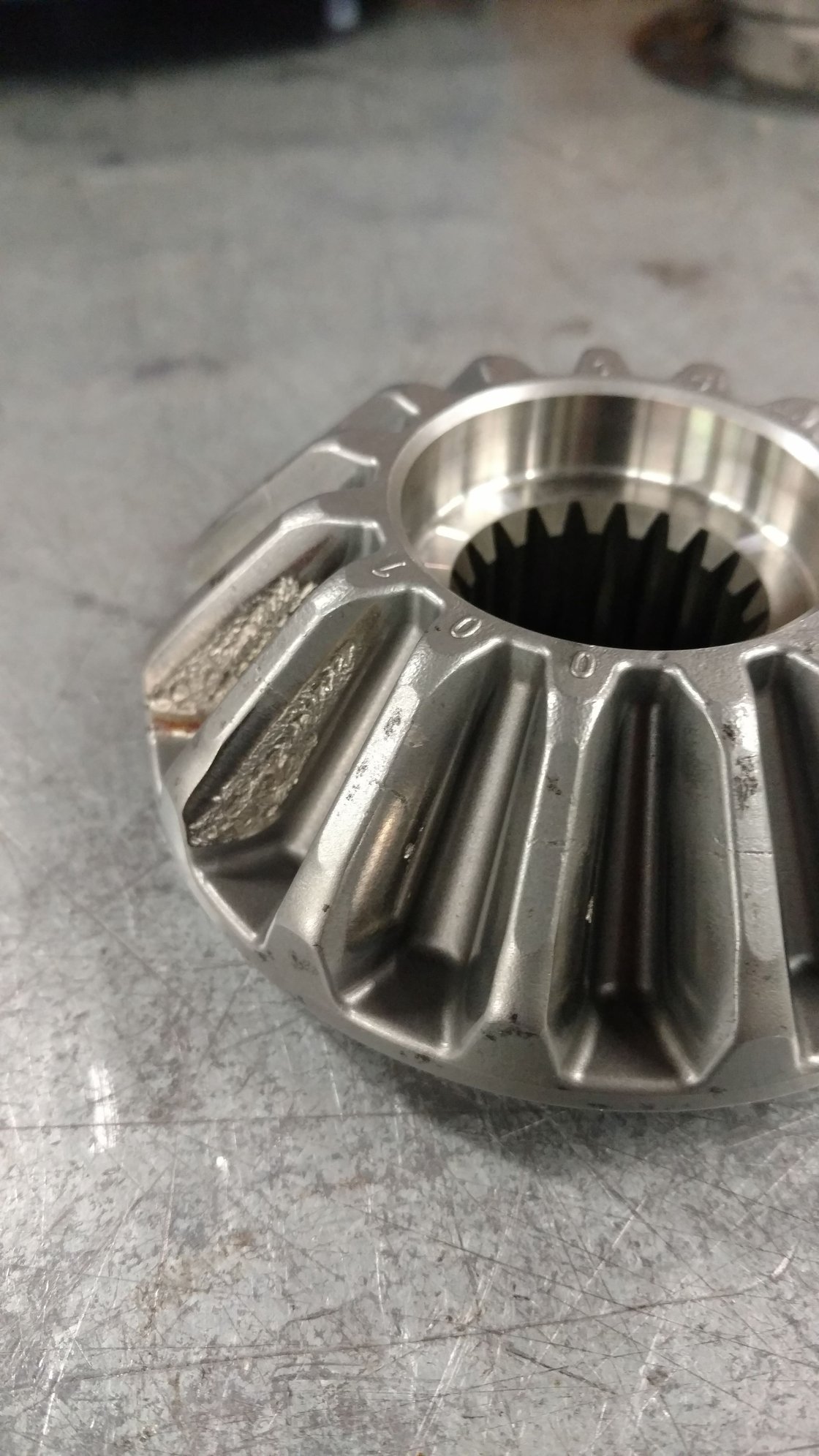

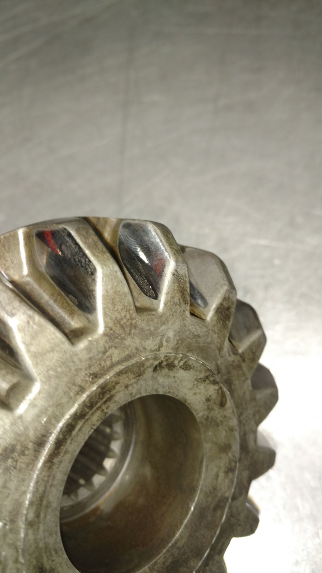

Went from -1 IMCO SC's to -4SCX's(blueprinted lowers, #6 shafts, 17" 5bl 35P props) and didn't lose any speed
Went from limping home on a broken upper every 100 hours or so to a few months of hard shifting(both drives) and metal on the drain plug(one drive) at 180 hours.
Took drives apart
Metal came from lower gear severely pitted-one drive
Hard shifting came from galled cone and cup-both drives. This was hard on the shift forks
New cones are lighter and don't fit the clutch shaft-needed new shafts
Propshaft seal surfaces were severely seal grooved-had them flamesprayed with ceramic
Drive pinion thread stretched when torqued to spec with brand new Snap on torque wrench-new inputs
1 upper drive gear had a few small pits
Parts list X 2!
all bearings and seals
flamesprayed propshafts
drive and driven lower gears
drive and driven upper gears
forks
cones
clutch shafts
input shafts
1 U joint each drive

Very disappointed in the lifespan. The time and cost spent rebuilding these(along with the original installation) maybe should have been spent on Arnesons????
