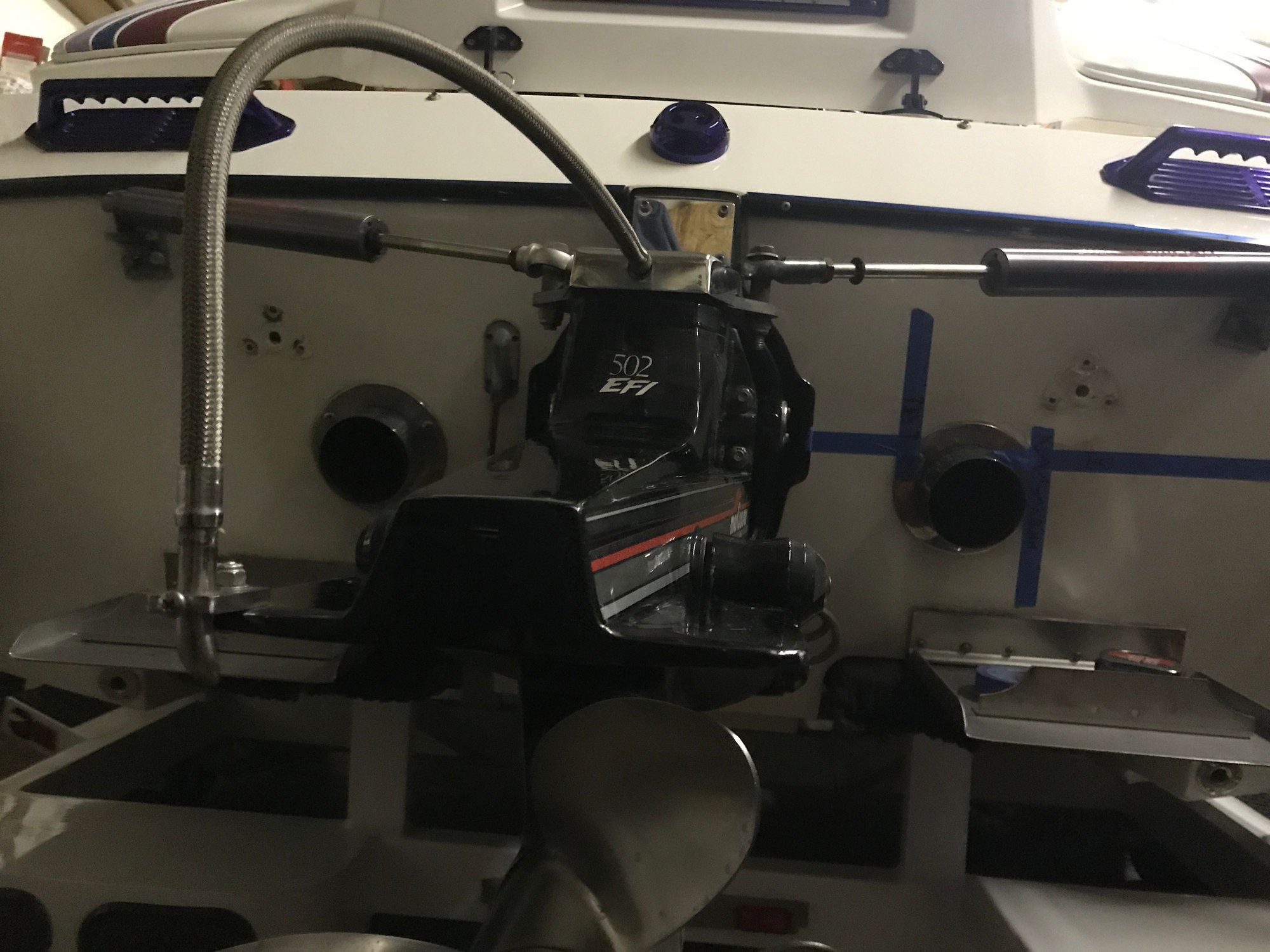

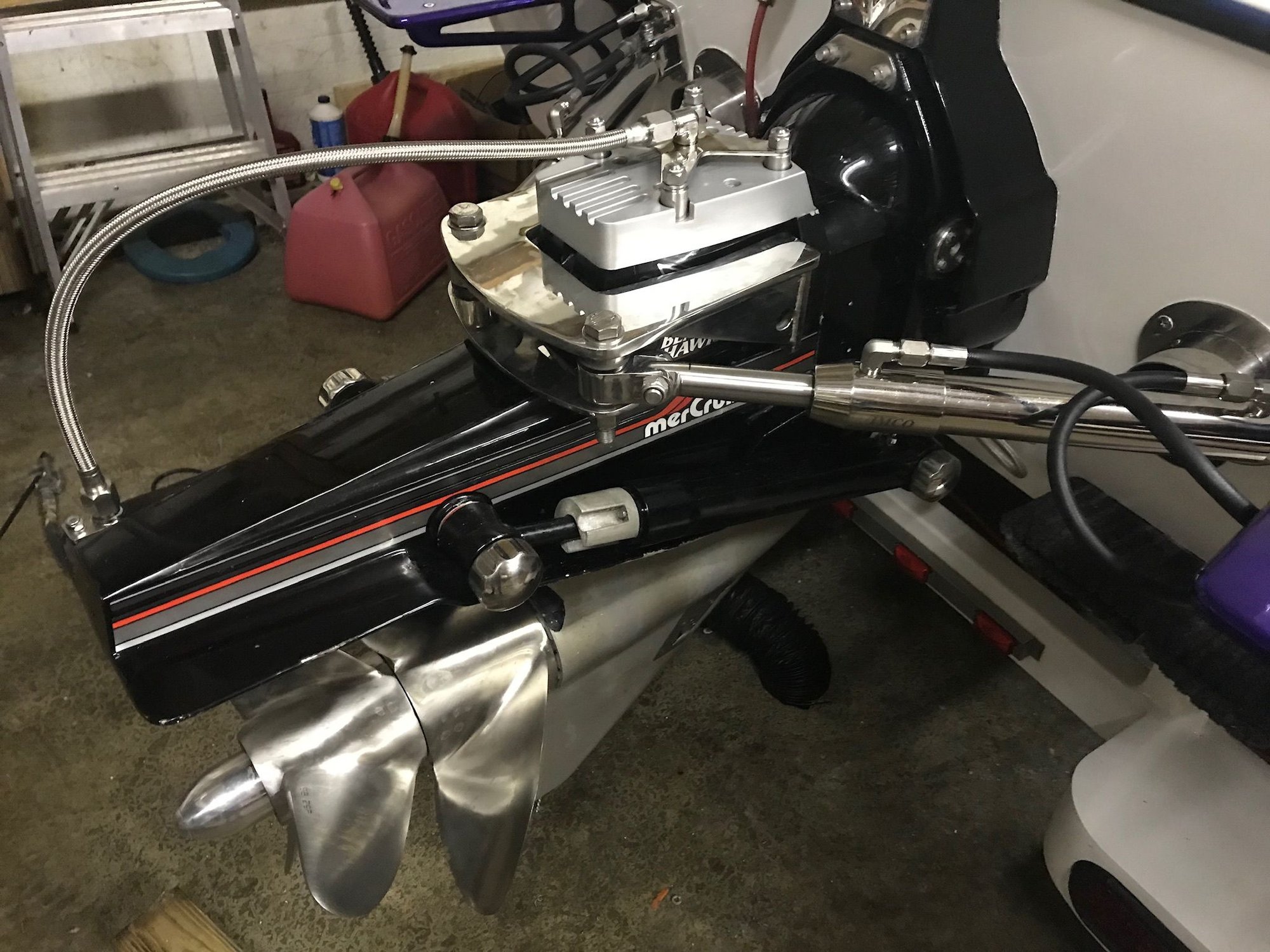

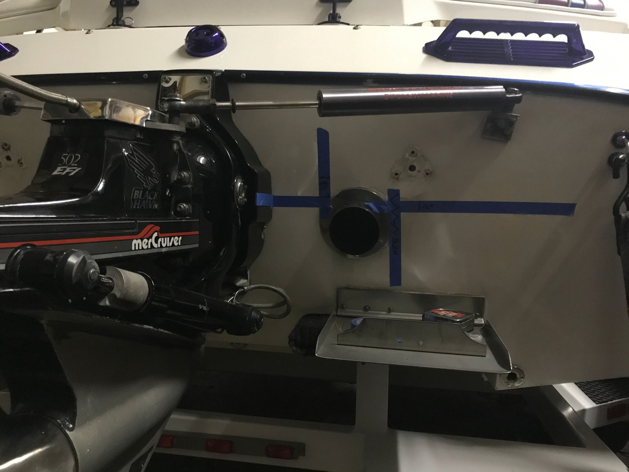

I forgot to update this thread. Got the steering done. I got the steering back plate from Marine Machine. They had a couple of them left and gave me some great advice. I used Imco hydraulic rams and transom components. I had to dig deep in my old geometry books to figure out placement of the rams to avoid the exhaust and swim platforms. Imco does not make the back plate for the Blackhawk anymore but they said they would make one for me if I couldn't find them anymore. I bought the hydraulic helm and interior components from Hardin Marine. Their components worked well and were the best value. I had to pick parts from a bunch of different companies, but it works very well on the very light Kevlar 22 Daytona. I patched all the old transom holes and put a new trim cable seal, swim platforms,etc....
