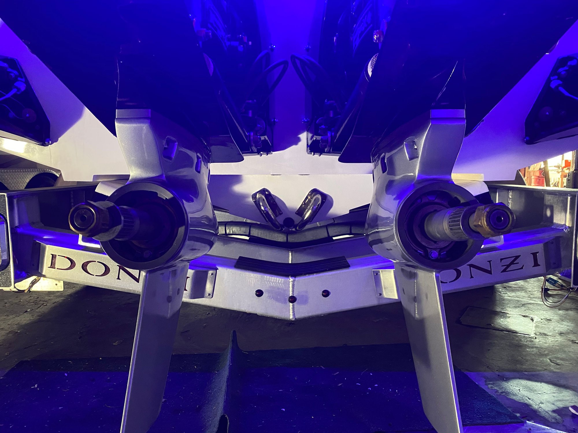

For comparison sake, my 06 38ZR imco SCX-4s are about 2” above hull bottom. Haven’t gotten a precise measurement on height or how far back they are. They are on ITS boxes. 17.25” 5 blades 18 degree rake. Planes out good with help of 280 k planes but isn’t challenging by any means. In a video that was taken with a go pro mounted in the notch you can clearly see the tip of the lower above the water. My slip isn’t the greatest however, 15-18 percent at cruise. From my experience and shops I’ve talked to the big imcos run the beat when up high out of the water and have a 16”+ cleaver to get around the big bullet and reach the water. There’s also the handling advantage with the cleavers. My boat was set up high to begin with with long sportmasters. 100+ 4 people coolers, full of fuel. 105 light, best so far of 108

Tori, I think you are spot on with your set up and bullets just surfacing. Most guys I know are running 15 percent slip when surfacing the propeller's. I will bet your water pickup location is causing you a little more slip also. Not sure on Donzi hull but on Fountains if you move water pickup to outside hull you will help with slip because props are getting cleaner water. Hope to see ya soon. Are running Top Gun poker run this year?
IGetWet 07-22-2021 10:49 AM
Yes we are looking forward to top gun! You probably right about the pickups down in the V, but they do scoop up enough water for the two stage pumps so I’m happy with that! I’ve asked a couple guys with NXT’s what their slip is but no one seems to know that or how high their drives are. From what they’ve told me about planing I’m betting they’re way up there though.

thats where im putting my pickups at id rather get good clean water all the time deep in the v to feed my twin stage pumps
