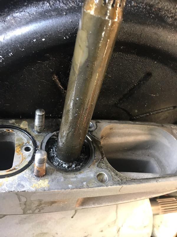

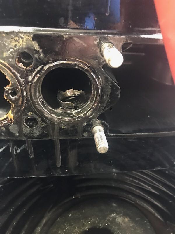

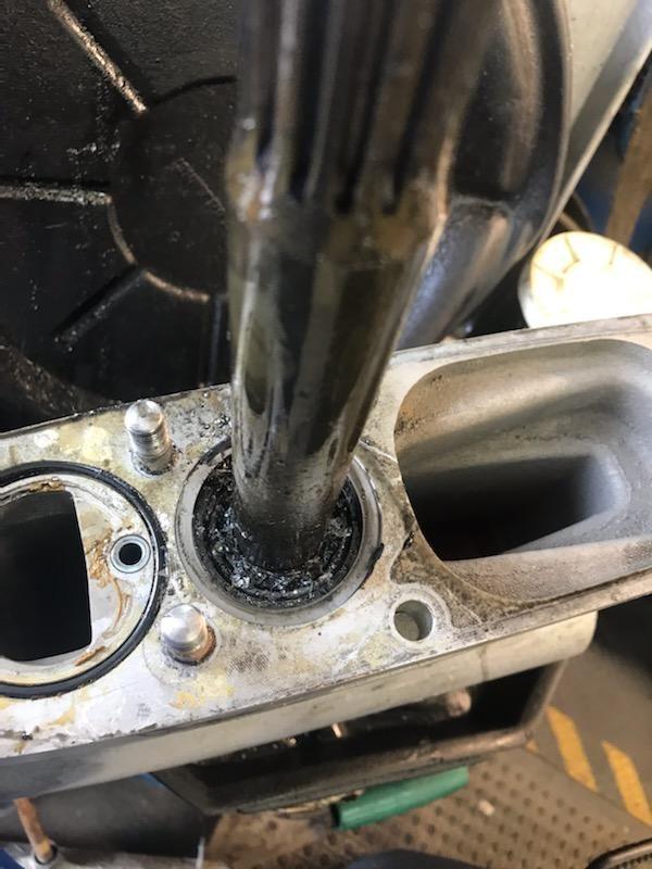

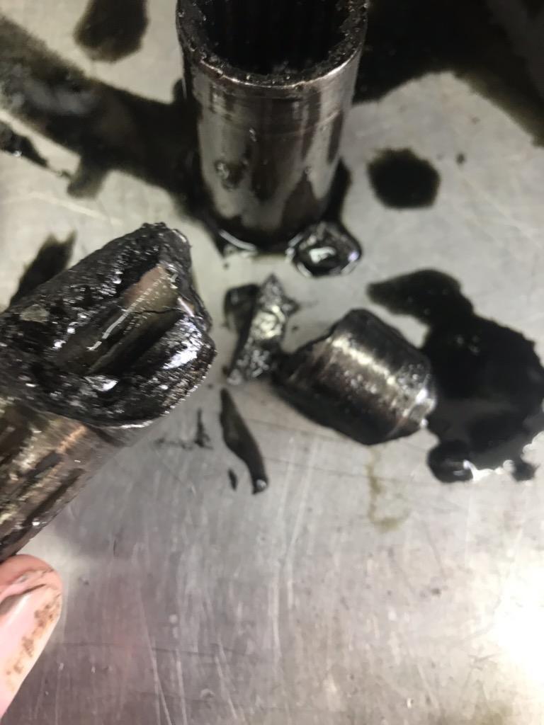

Well the upper is trashed and metal was sent throughout.
guess it’s decision time now. Looking at like about 18k for a new upper sending the lower to imco for rebuild and a few other parts (helmet, drive reservoir and adaptor for the steering)
that’s probably the same as rebuilding and then Buying a spare
I just bought 2 SCX upper conversions from Fred @ Imco. Your correct on the Helmet, drive reservoir and the steering cap comes with the drive. You'll need the SC/SCX Coupler as well.
spending money 07-27-2021 05:10 PM
Just spoke to Brad at imco. They make a shaft that fits the scx upper without an adapter. The lower will go back for a rebuild anyway. If that’s the case and the shaft is trashed then I can just get the correct shaft.
At the cost of a rebuild for xr and the sc lower. One more explosion and I could have had a scx. I can keep justifying it but damn it sucks pulling the trigger.
Glad you are going there sooner than later. It took me about 8 rebuilds before I GOT it lol
RedBoatFl 07-28-2021 06:14 AM
The new shaft for the lower is needed to use a spacer.
IMCO has their adapter coupler for standard length.
