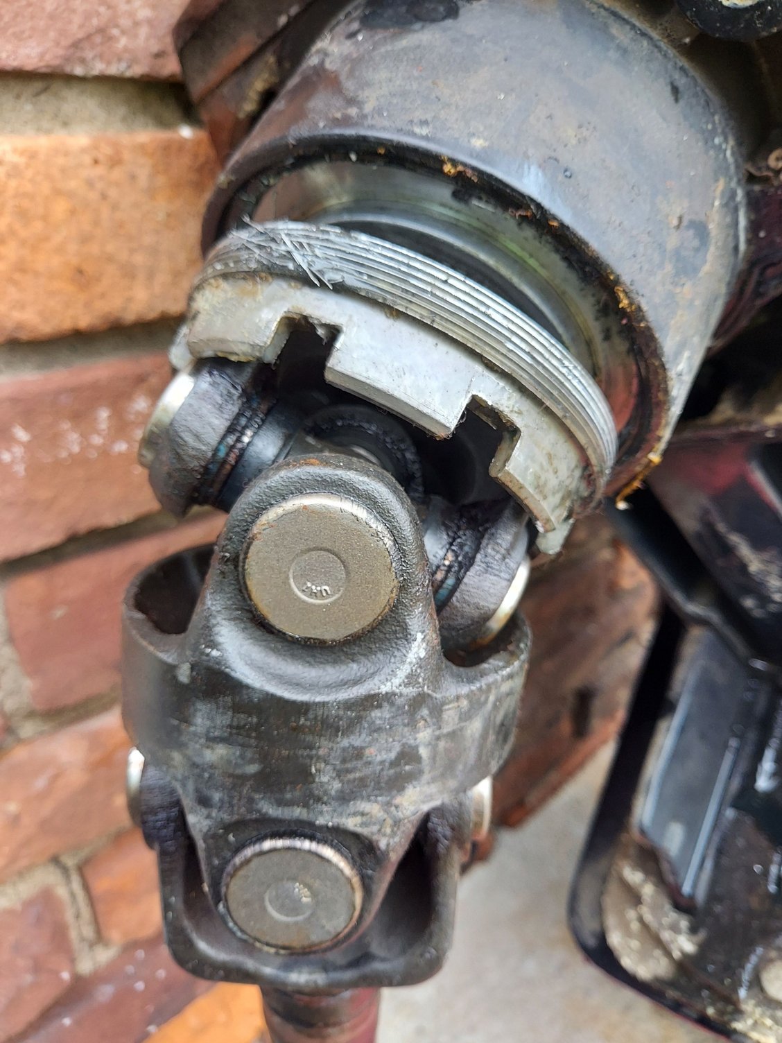

I went out this past weekend and ran my boat hard. Thought I blew my drive. When I pulled it off this is what I found. I'm going to pull apart when I find the time but was wondering if anyone had any idea why this net would back out or push out?

Go ahead and pull out the input
shaft assy and see if any teeth have broken off of the
gears….. you don’t even need any tools to do this

As said above. Should be able to pull the input right out.
Lost a few teeth, they tried to climb each other, pushed against retainer nut, then the threads in upper case lost the match.

that's what a blown upper gear case looks like !

yeah looked a little closer tonight. Yikes!

What were you doing when she went? Speed, water conditions, heavy or light load?

when it went I was around 4000 rpm calm water. Boat is a 28 pantera speed I'm unsure of. Probably around 55mph. I'd say it was under a pretty light load
