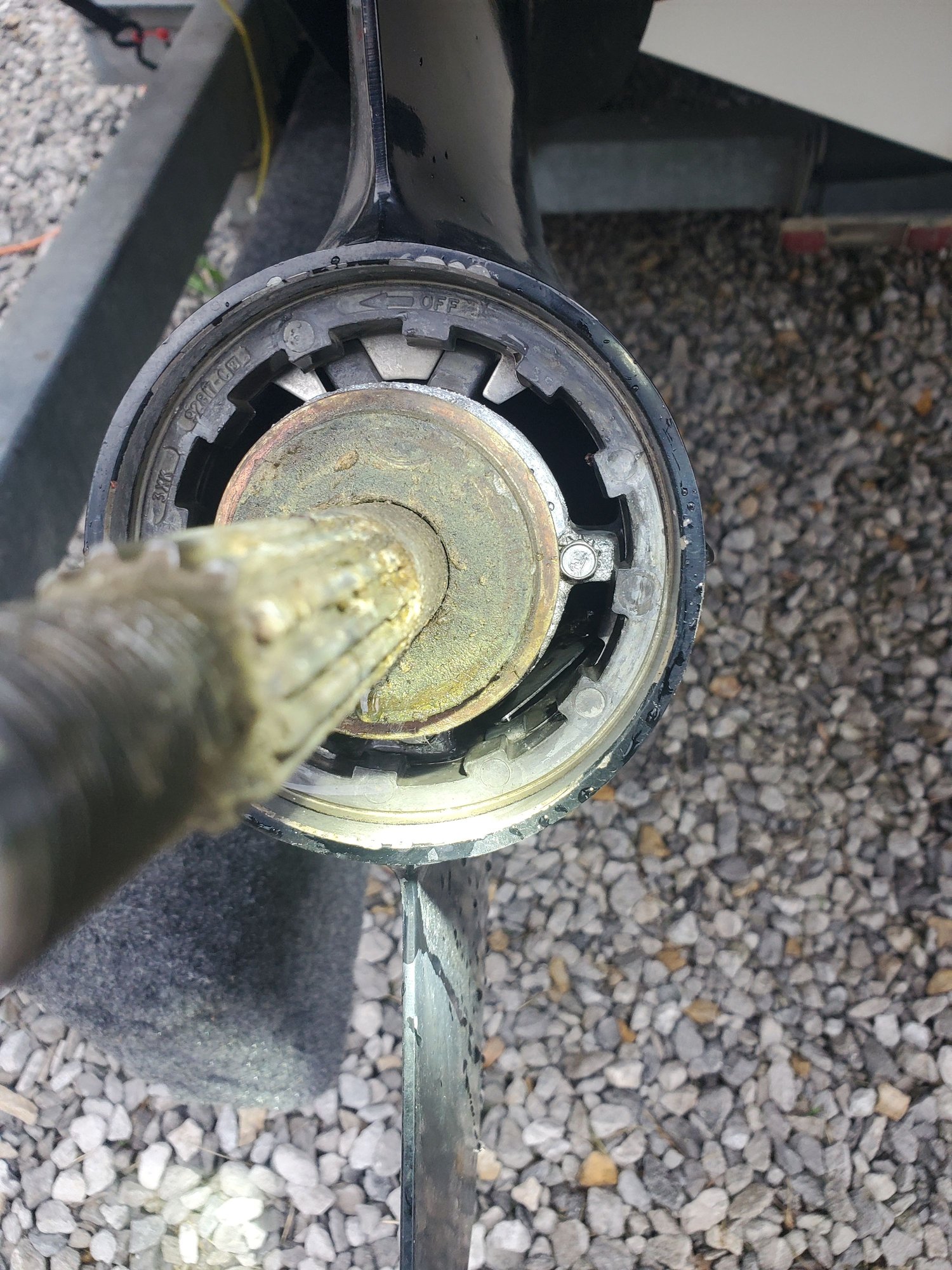

I have what looks like a rubber gasket and a metal piece behind the prop in the housing. Also looks like a small piece of a wooden shim that is further in. Any help on what it is and if I should remove it or something needs replaced? Its a bravo 1 outdrive.

Thanks for the reply. The props are off and it in the space around the prop shaft. I'm a new member, so as soon as it lets me, I'll post a pic.

Here's the pics. Top one is the rubber and the bottom one is the metal piece I was talking about.
Unlimited jd 06-01-2022 05:05 PM
Those are what’s left of the exhaust flaps that are supposed to be in the top of the y pipe
