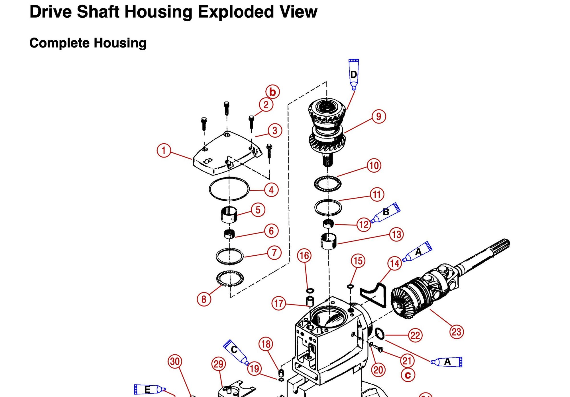

Ah, wait a minute. Are you talking the bearing sleeves? These look to be included in the upgraded gear kit. Parts 5 and 13 here:
https://cimg7.ibsrv.net/gimg/www.off...f86f3a0b4f.jpg
JaayTeee 08-05-2023 05:50 PM
yes
Knissone 08-05-2023 05:54 PM
Originally Posted by JaayTeee (Post 4875739)
yes
Yep, gotcha. Thanks for pointing that out, I did totally miss that one. But damn! That tool is over $400. Might call around on Monday and see if I can find a shop to quickly press those in for me...
