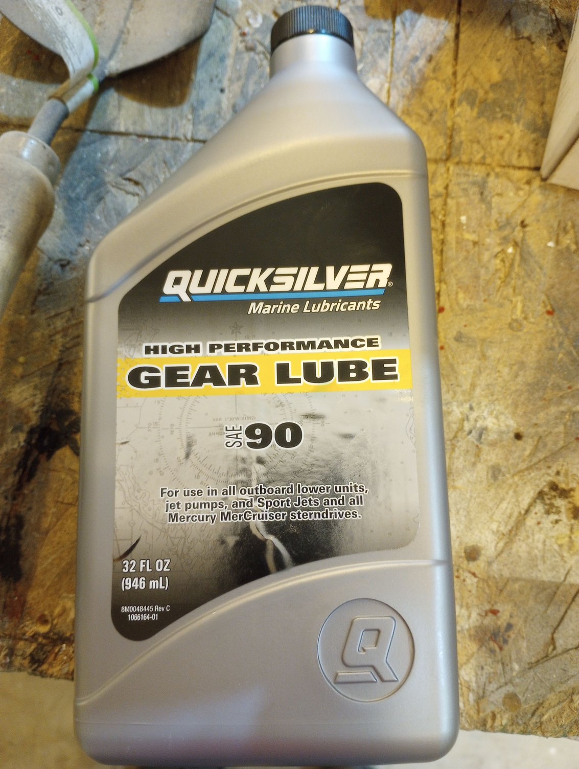

PQ290Enticer 05-21-2025 12:44 PM
I bought this and it doesn't say synthetic anywhere. It does say to shake before use!! Never saw that before and of course I didn't do it. Why am I suppose to shake a qt of oil before use?

boatnt 05-21-2025 12:52 PM
https://cimg0.ibsrv.net/gimg/www.off...faddf5794b.jpg
https://cimg3.ibsrv.net/gimg/www.off...8c5c8508c1.jpg
because all the additives have settled on the bottom
30outlaw 05-21-2025 01:11 PM
that is not the 85w-90 extreme lube....
