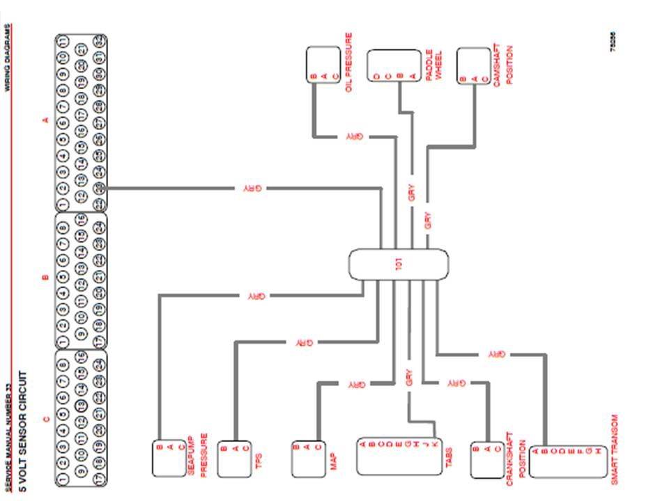

Ok....so there's 3 wires in the plug that plug into the TPS sensor, a black/purple, a blue, and a grey. On the engine that runs test continuity on all 3 wires black/purple goes to ground, on blue and grey OL (open)
On engine that won't run the grey wire goes to ground. So where does grey wire go?

So my 496 mag ho is the 0M0000000. Today I checked ever PCM pin on both engines and the checked out the same EXCEPT 5 V on good engine and only 3 V on other for what I believe is the 5v system. The only other discrepancy is I have a ground on the good engine at TPS sensor (black and purple with) with the key on and no ground on same wire on bad engine

So far as the beeps, I would connect a meter to the 5V circuit, then start unplugging some of the sensors, water pressure, water temp, IAC, TPS and just turn ignition to ON. When the shorted sensor is unhooked, the voltage will go up to 5V
So in my 5v system I have 3 volts on the 5 volt line and 2 volts on the ground line . Is it s sensor? Is it a bad ground?
If it was a short in a sensor wouldn't I have continuity on the 5v line to ground?

The "short" term is meant to indicate something is drawing enough current to drop the reference voltage below the standard or 5V in this case. Same goes with a starter motor and the battery. If the starter pulls more current when cranking the motor, voltage will drop further down. So there is something in the 5V circuit which is pulling more current then normal which is dropping the voltage to 3V, but is not a dea short which would pull down to 0V if not blow a fuse when doing so.
If it was a bad ground the voltage would show full 5V and there would be a code for the bad sensor for not providing the correct range voltage back to the ECM

So why is the 2 of my 5v in the ground line and 3v in the 5v grey line?
This is not real clear but I think your saying that 2 of the 5V lines are at 3V and others are at 5V?
If this is the case then there is either a break in the grey wire splice, or if they are all 3V then there is either one or more sensors drawing to much current.
Has to be a sensor right. Will a laptop program show which sensor is bad? Or will they all have funny readings because there's only 3v running through the system?
The software is looking at info supplied by the ECM, and if all the Gray wires are low then it will say all sensors have bad readings (so to speak)

Yes all sensors I have found so far only have 3volts. TPS, map, the one going in outdrive, iac, crankshaft, Now I just have to find the rest if I can get to them. With that schematic I now know all 5v system sensors. When I unplugged the bad sensor I should get my 5volts back. Thank you so much for the info!
I replied to this on because it wouldn't let me reply to the picture post
