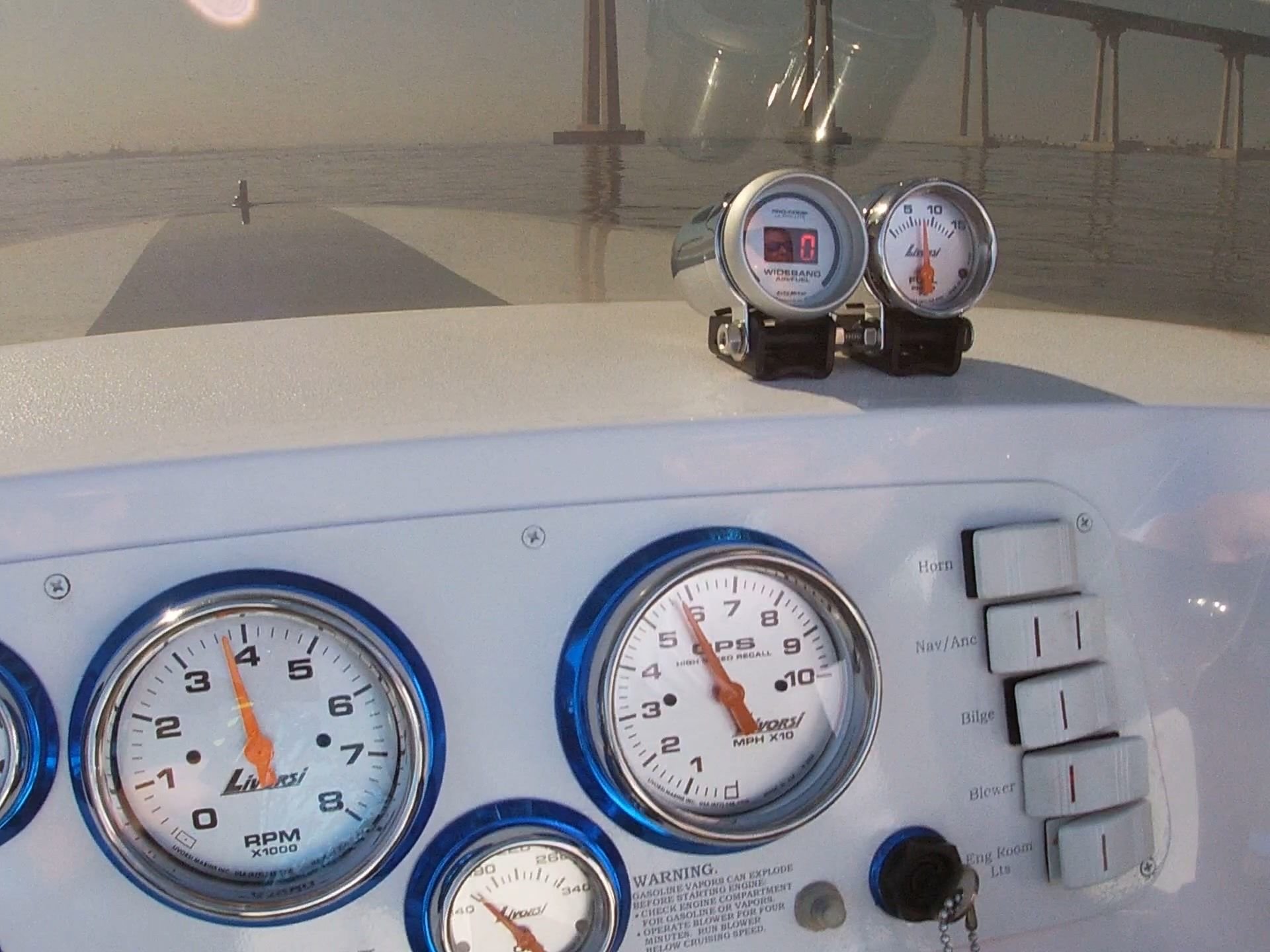

I have an Afr and fuel pressure gauge in little cups. Not a fan of those but didn’t have to butcher things too much. Running a fuel pressure sender from the return regulator.
