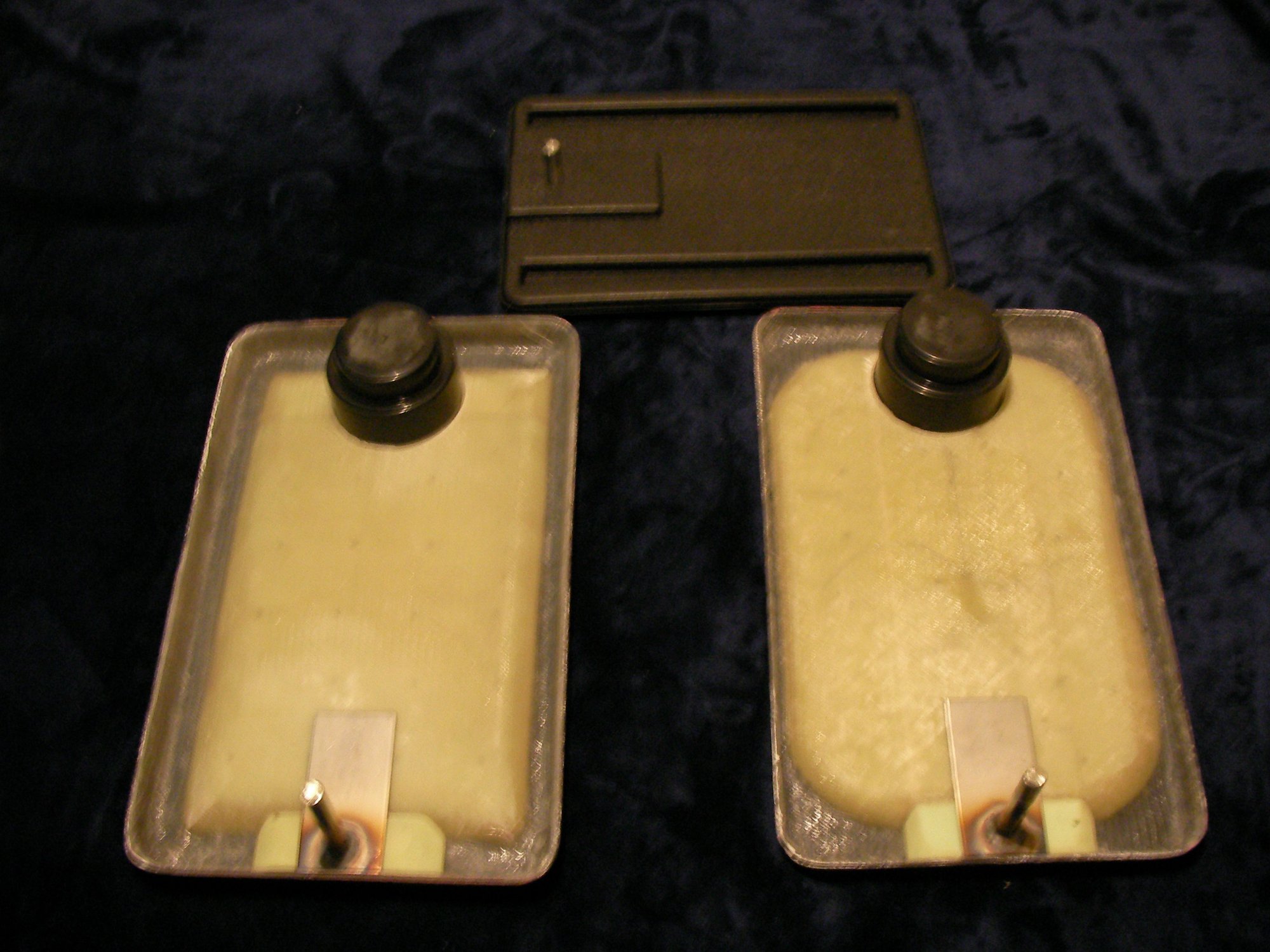

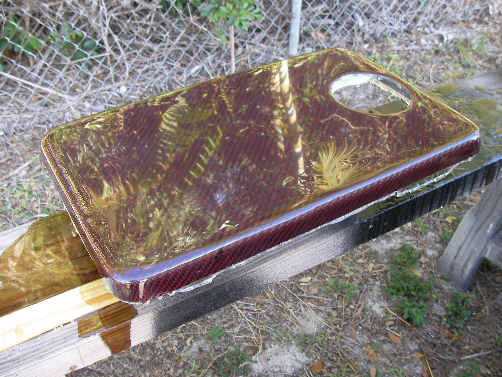

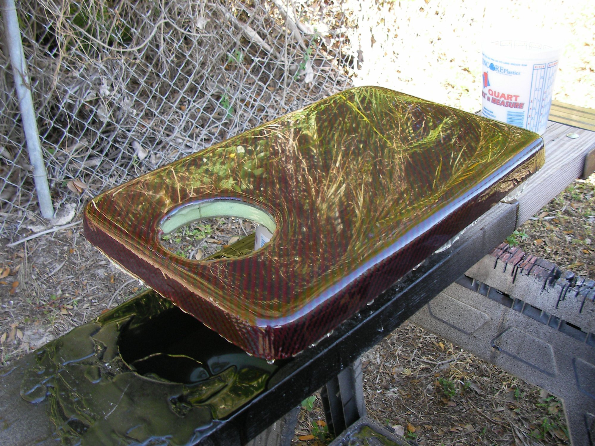

First 16, across all.
2 hours into the cure.
2 mixes both 16 then covered with pva. Got about quart and 1/2 of clear gel left.

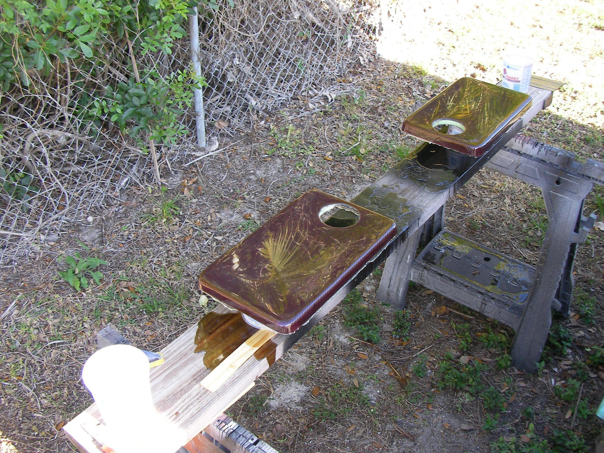

Missed some spots but it's on its way, maybe good to go tomorrow. pinstripes and stencil still under gel.

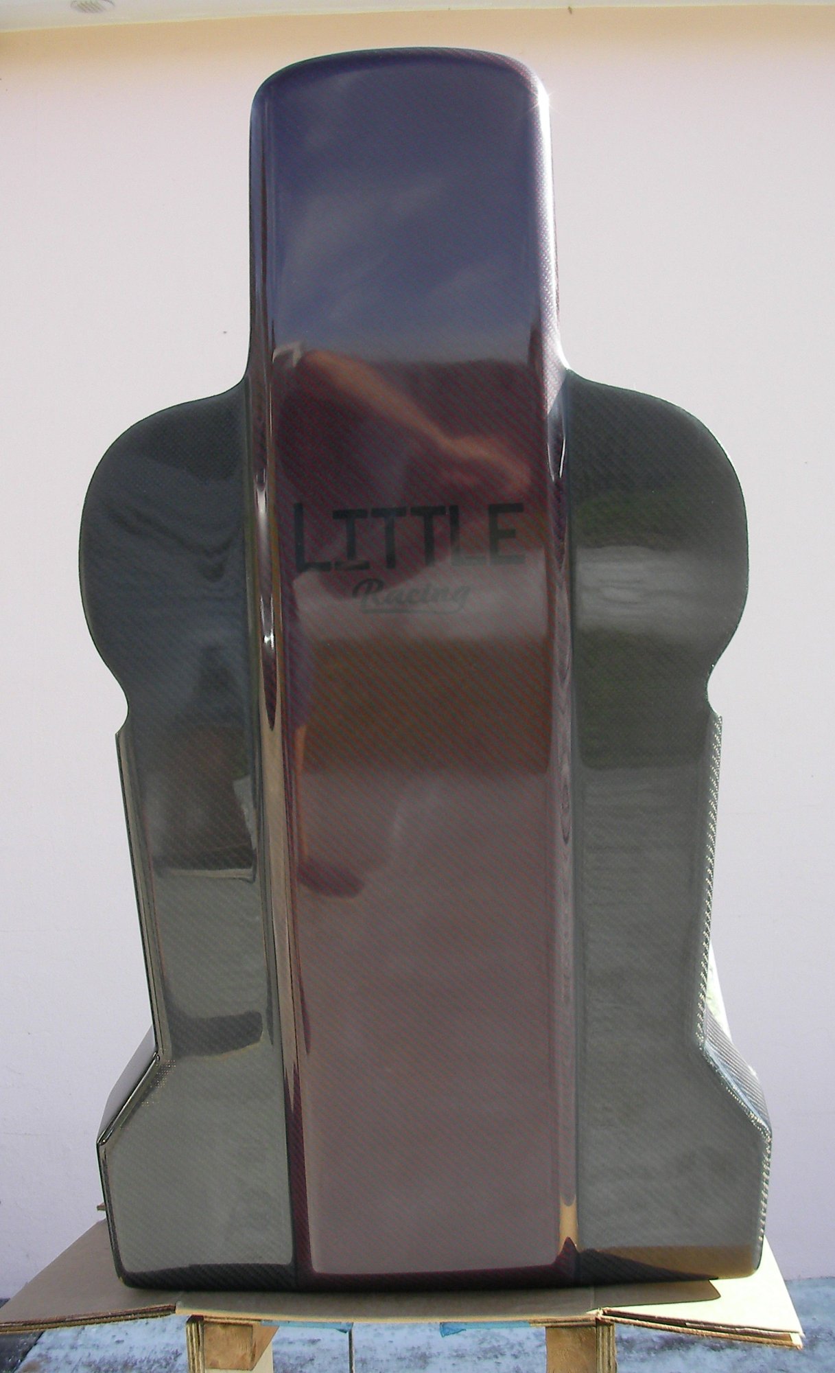

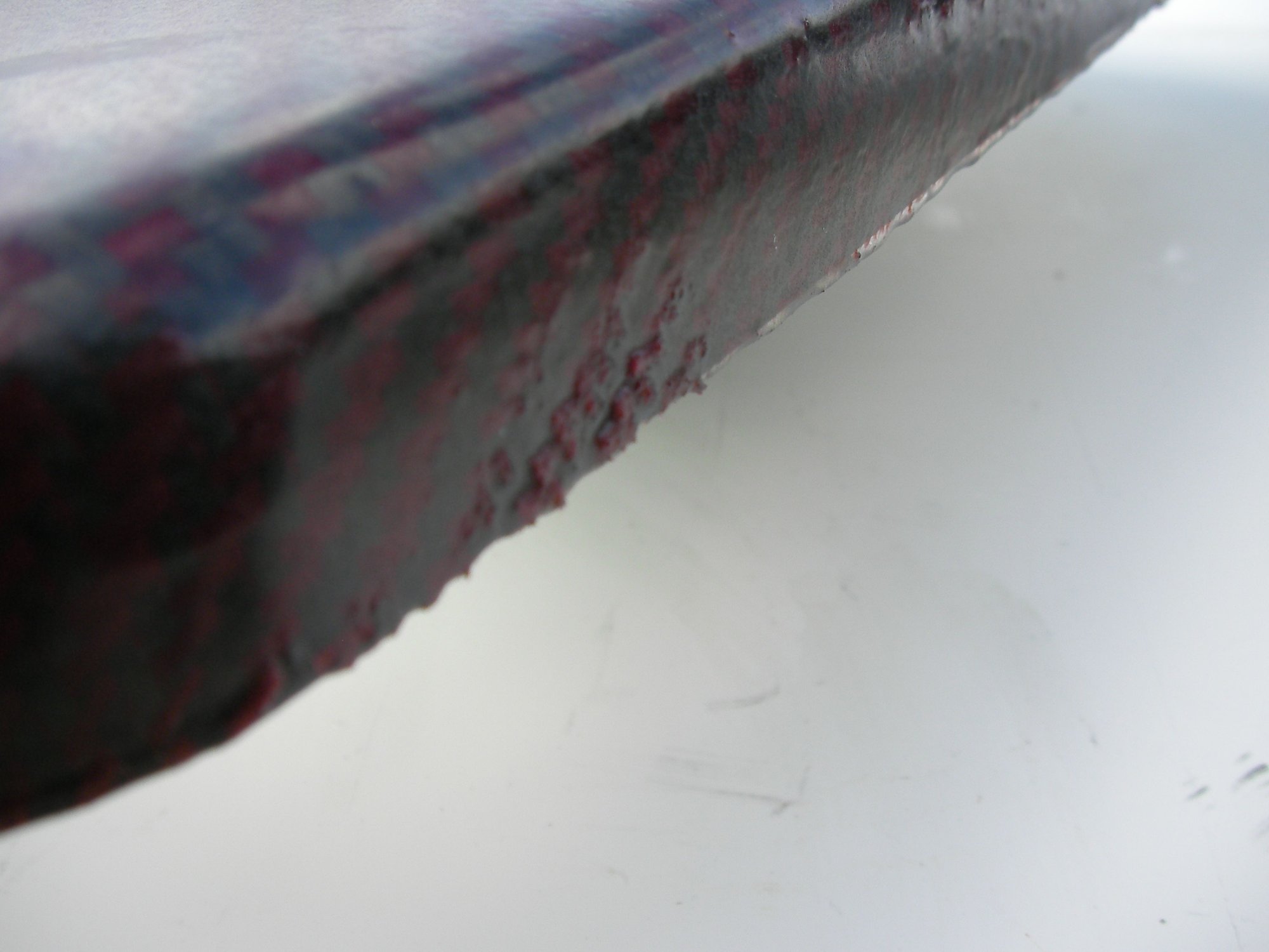

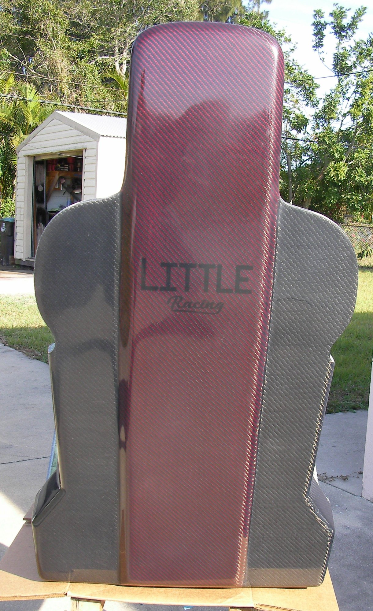

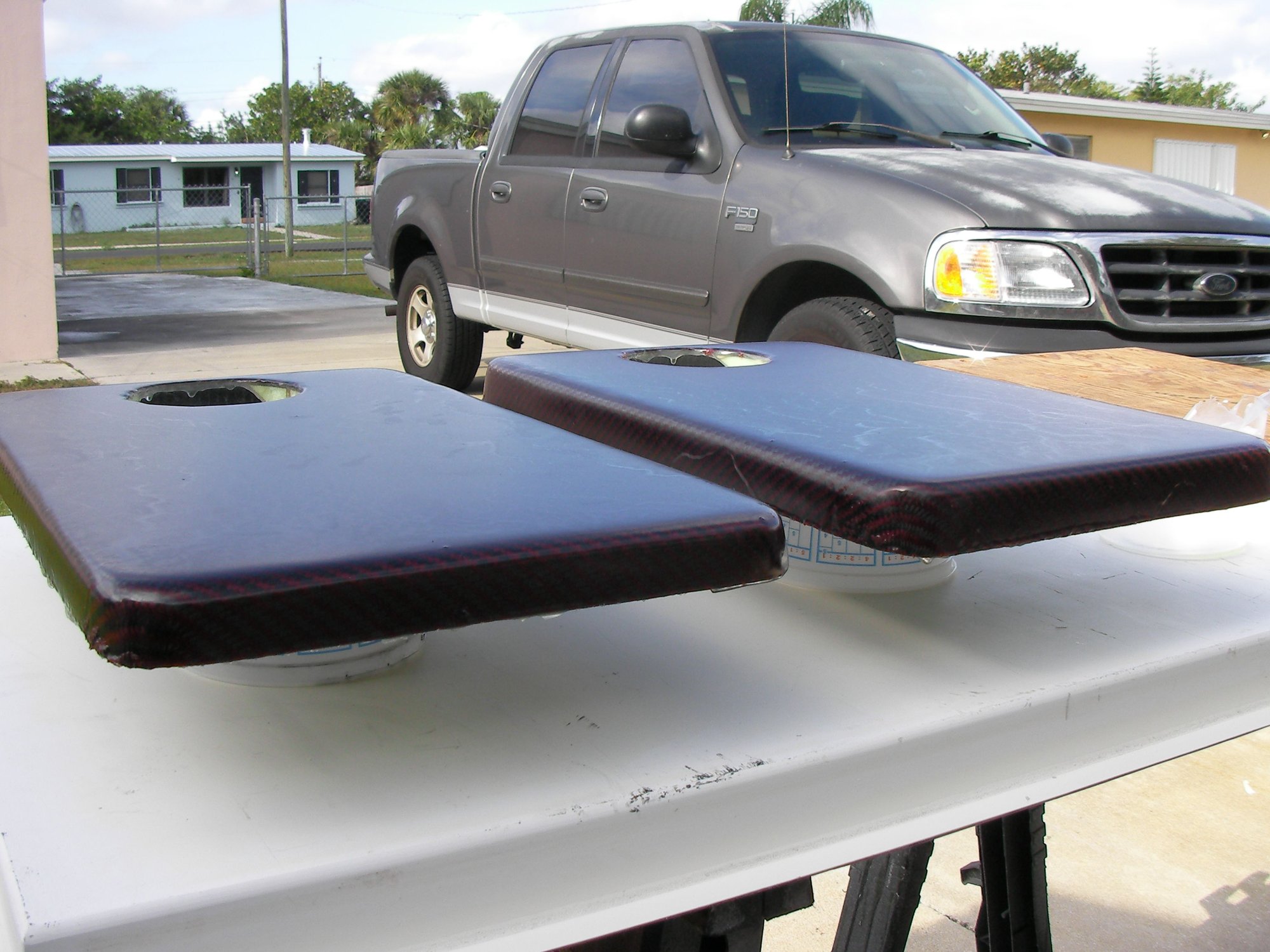

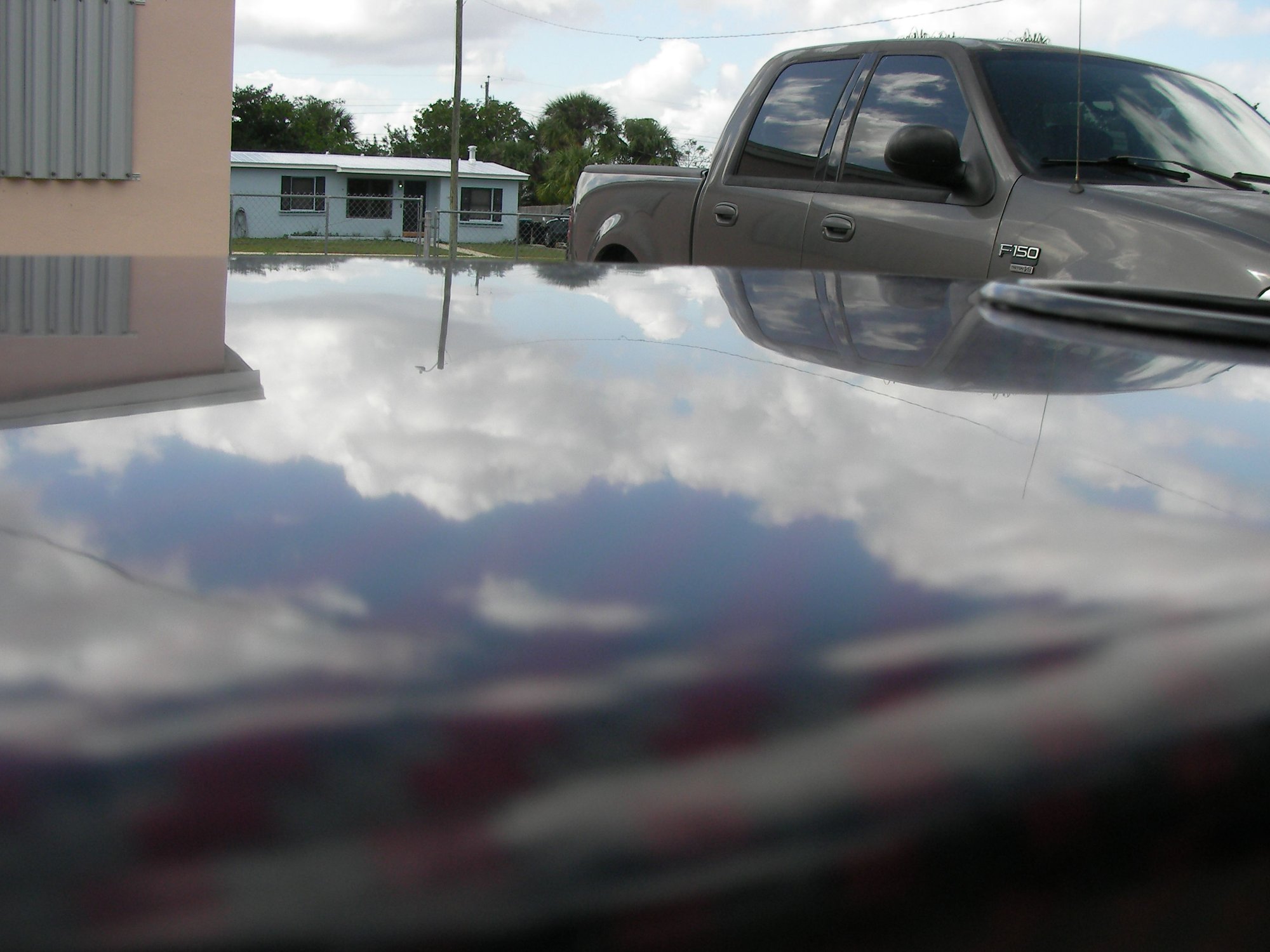

Got a nice deep shine all around on both seats, problem i have is stop sign shaped scratches from sanding 90, 45 and 45 thru the grits. Ordered sticky back paper, wrong stuff and the velcro paper didn't get delivered (lost and pending until the 31st).
So i'm missing 800, hopefully both can be re started at 800 and go up with better results.
those guys who wet sand a whole boat in a weekend must have a super secret cuz 5 hours on a seat leaves it needing more.
The new formula of vibra cut is nice, just opened a fresh gallon for these 2 seats, and need to buff to see what i'm leaving behind with the 1000 and up paper. Wet/ wet with soap/ dry makes no difference.
sheets of 3m tri mite leave edge/fold scratches, using 5 inch discs.

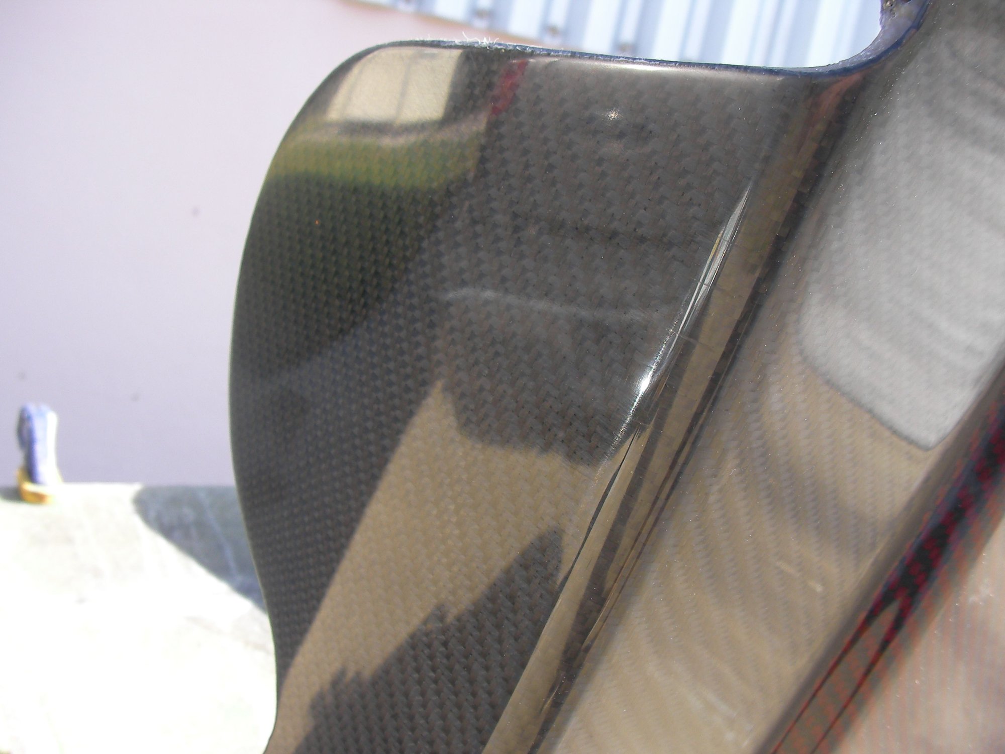

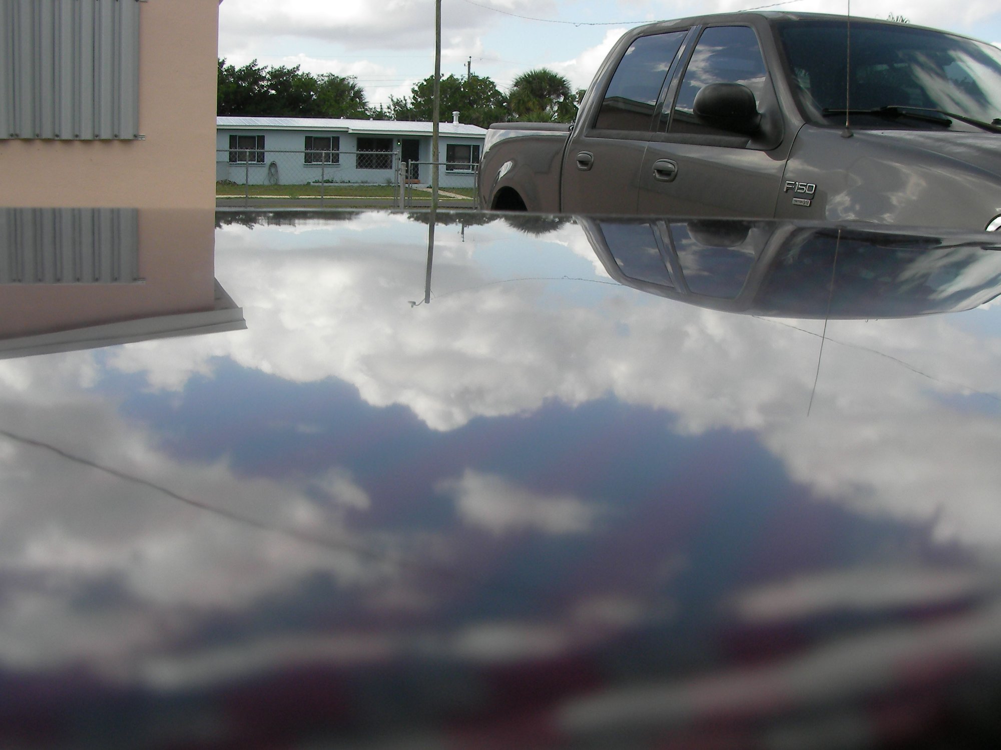

Thanks, yeah right angle and light they look great, spin it around and they don't pass muster.
sanding on both seats as follows;
80 grit on electric da wet and soapy to cut 99% orange peel.
220 on electric da wet and soapy to just finsh the orange peel and remove the 80 corkscrews.
400 dry to remove the 220 corkscrews
600 wet @ 90,45, 45
1000 and 1500 wet @ 90, 45, 45
buffed with vibra cut on wool pad to show what got missed.
scratches i'm seeing are straight and could very well be 600 almost completely sanded down.
when sanding i can see the 400 filling up with dusty water, wipe and sand till gone.
It's patience and skill thats missing, i started with 600 by hand and kept going lower to knock the orange peel down until i gave up and plugged in the da. Hose on mist to keep it clean, not enough compressor to run tool like you mentioned.

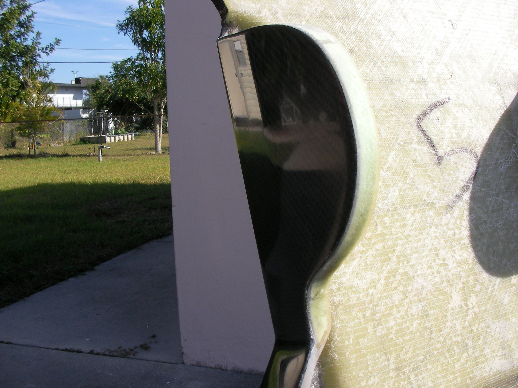

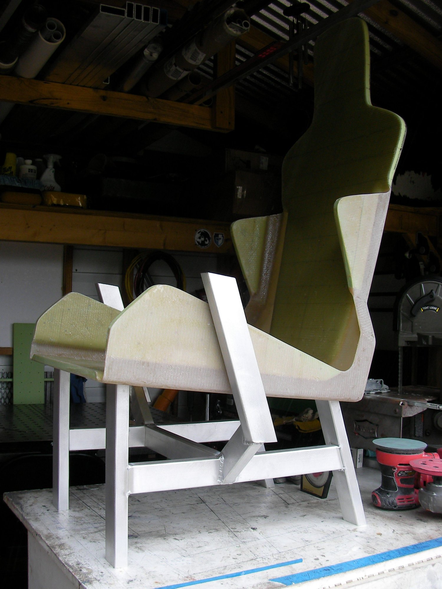

In a last act of desperation each tray got 16 oz of surfboard resin w/ the correct amount of wax added. Hopefully, vibra cut will take it off the surface. Bet the resins 1/8 inch thick
The hardware for both seats and snack trays gets joined together with globs of destruction starting tommorow. You guys know globs of destruction by another name, welding !

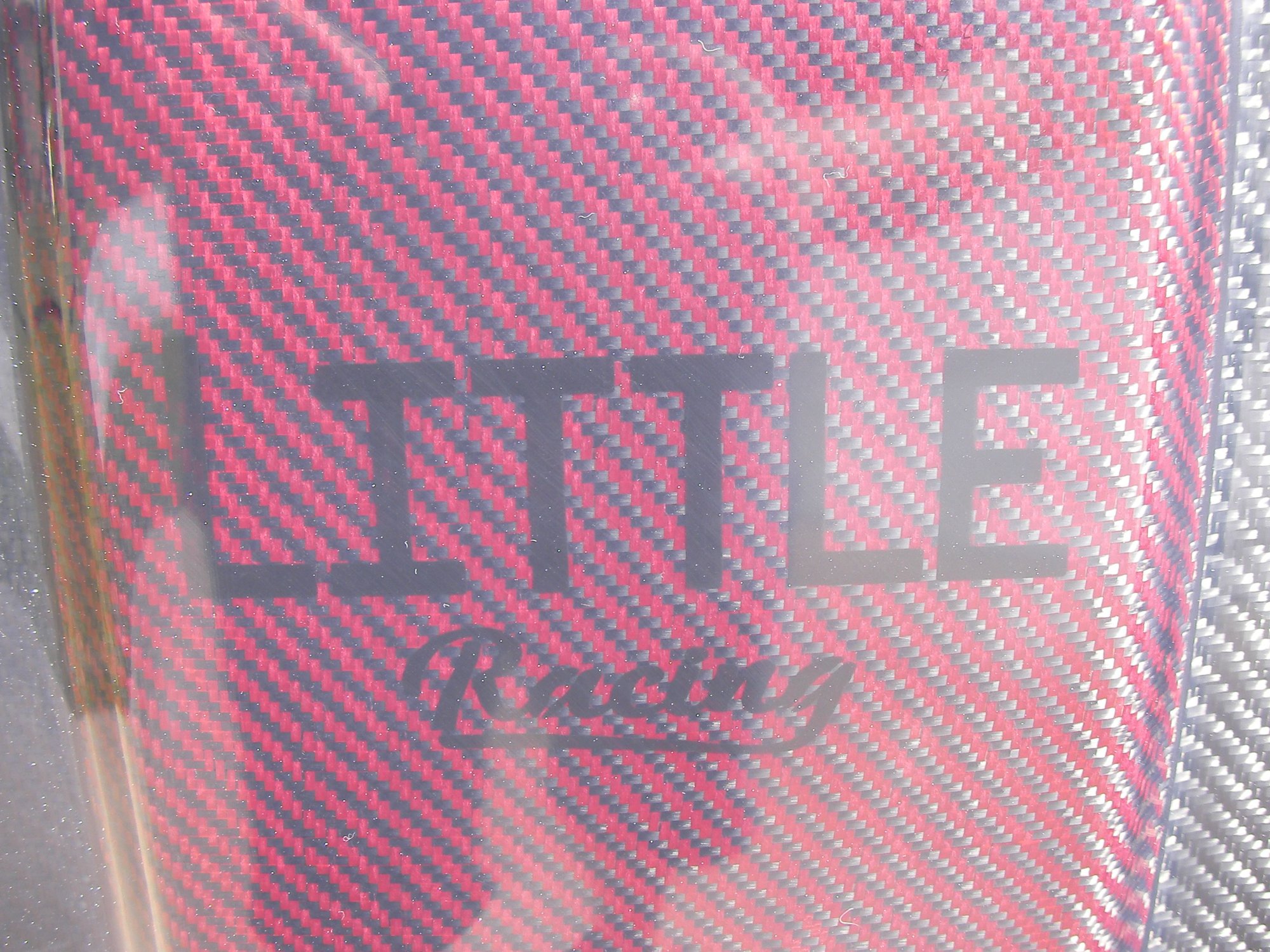

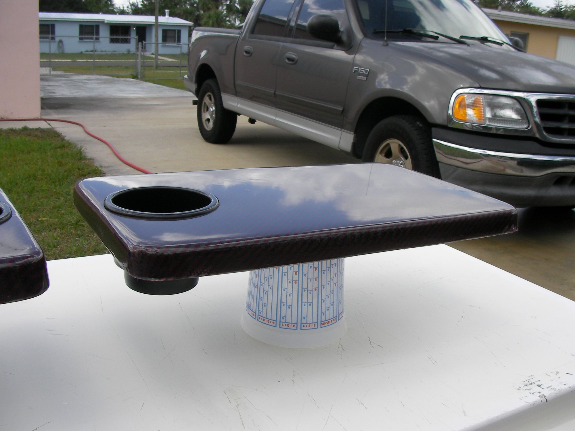

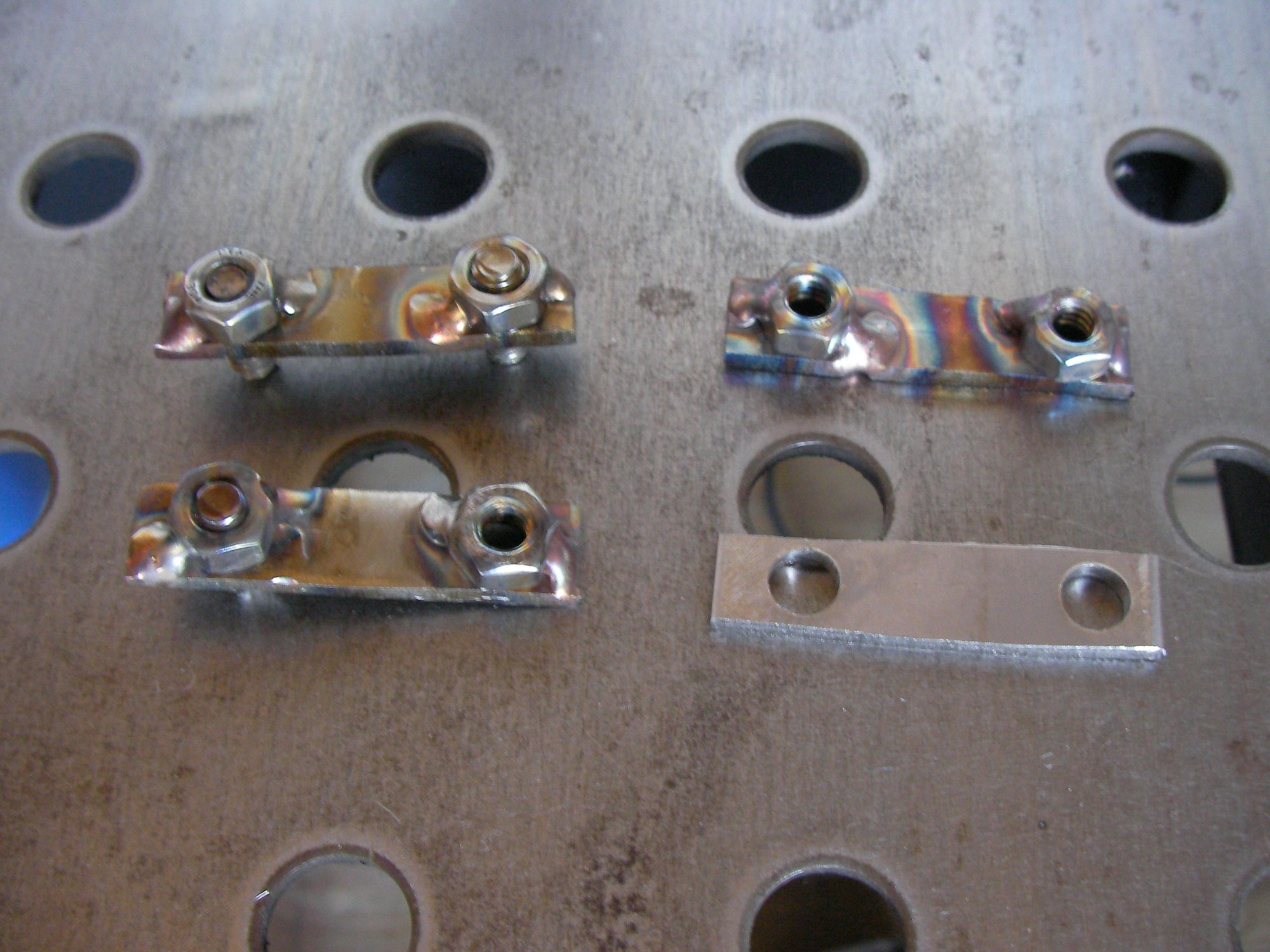

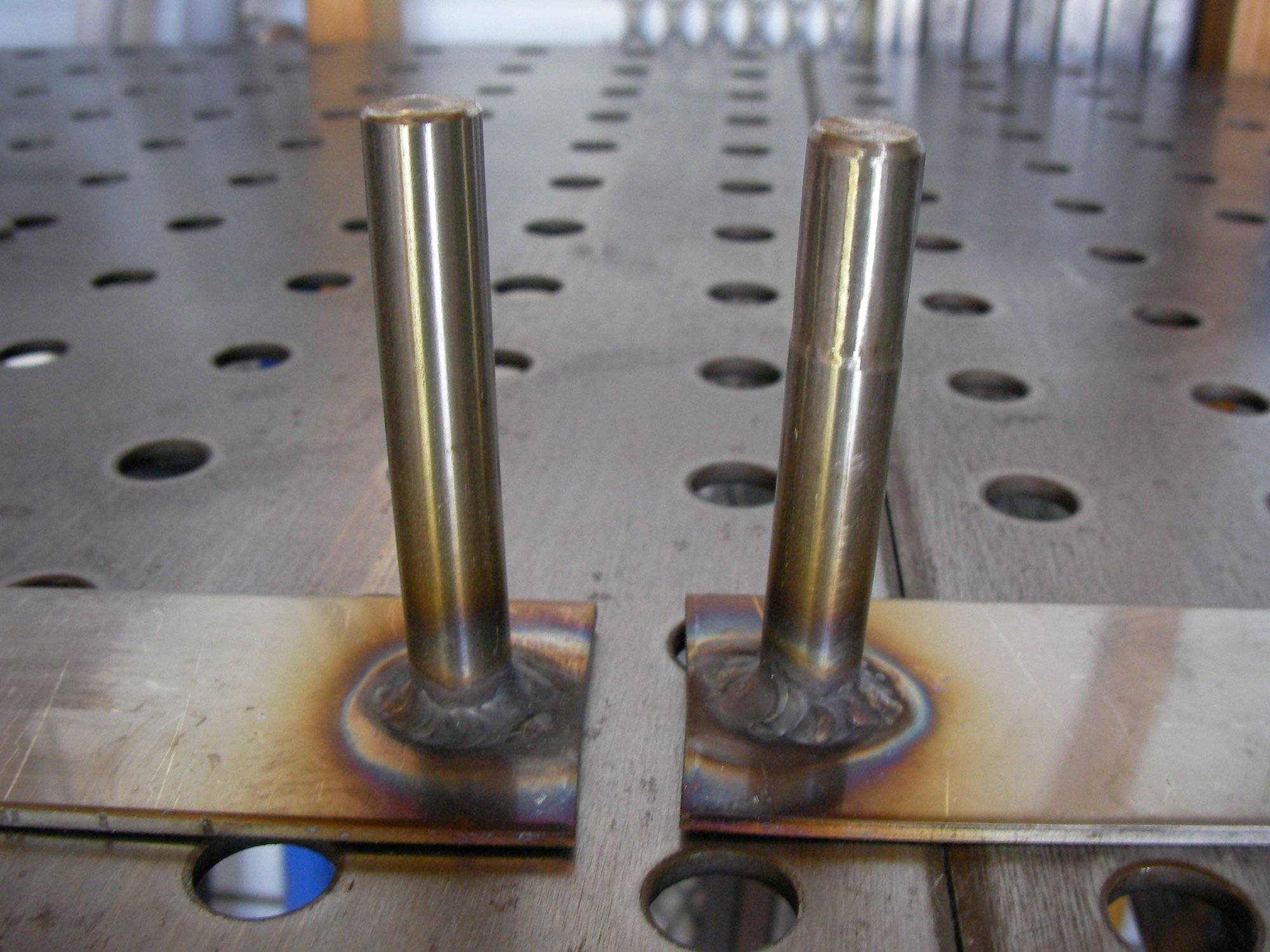

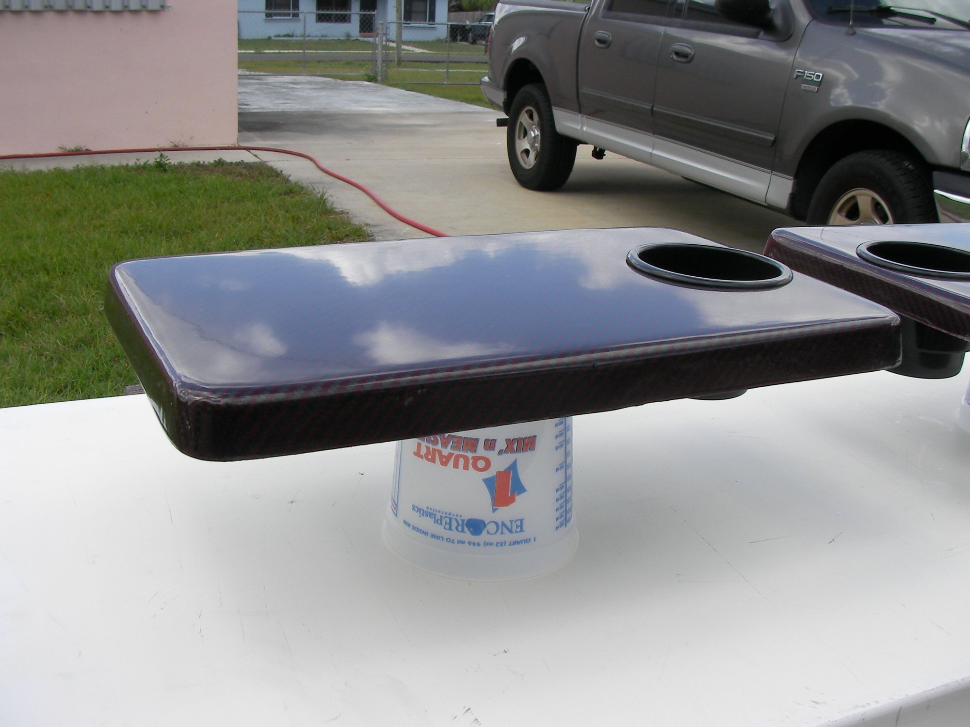

Brad, more like Blue electric "hot"glue. I've smoked 3 pairs of tig gloves and only gone thru 3 pounds of filler rod, king of slow learning around here

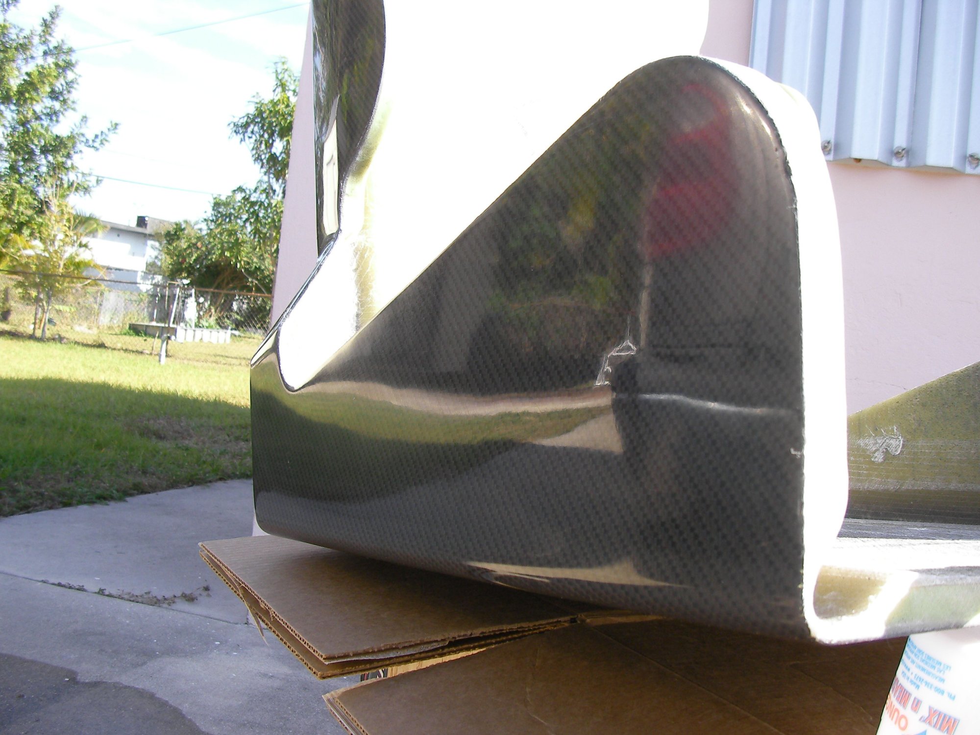

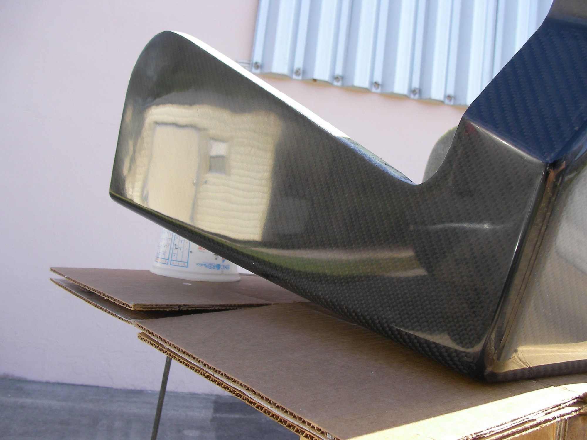

Dried flatter than they looked yesterday
This is the problem with the hybrid fabric, carbon stays flat and the kevlar swells up leaving a washboard surface, i wont use any more, from now on color will come in the form of dyed 2x2 twill composite envision sells.
1000 wet then buffed, as done as they're getting

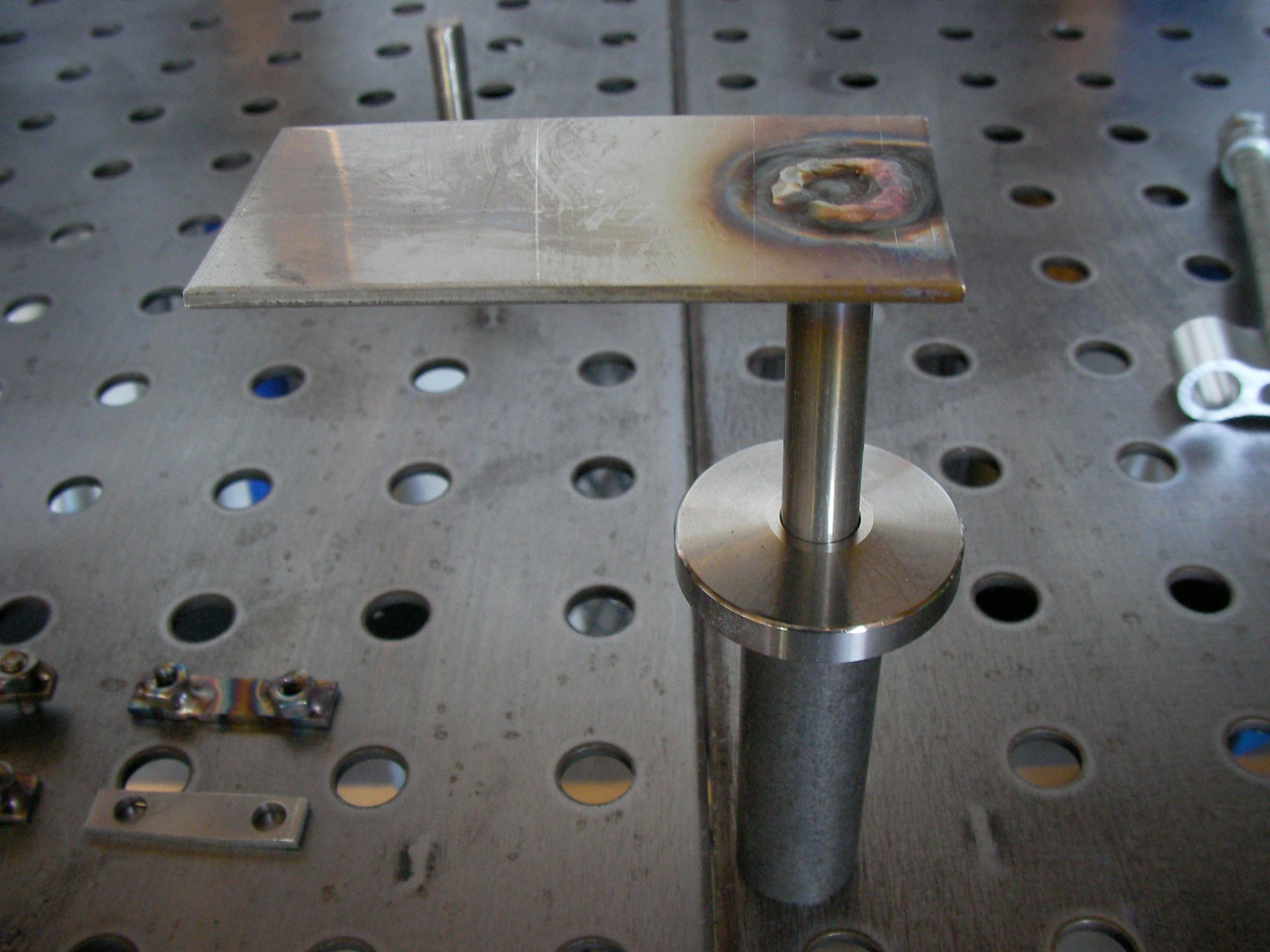

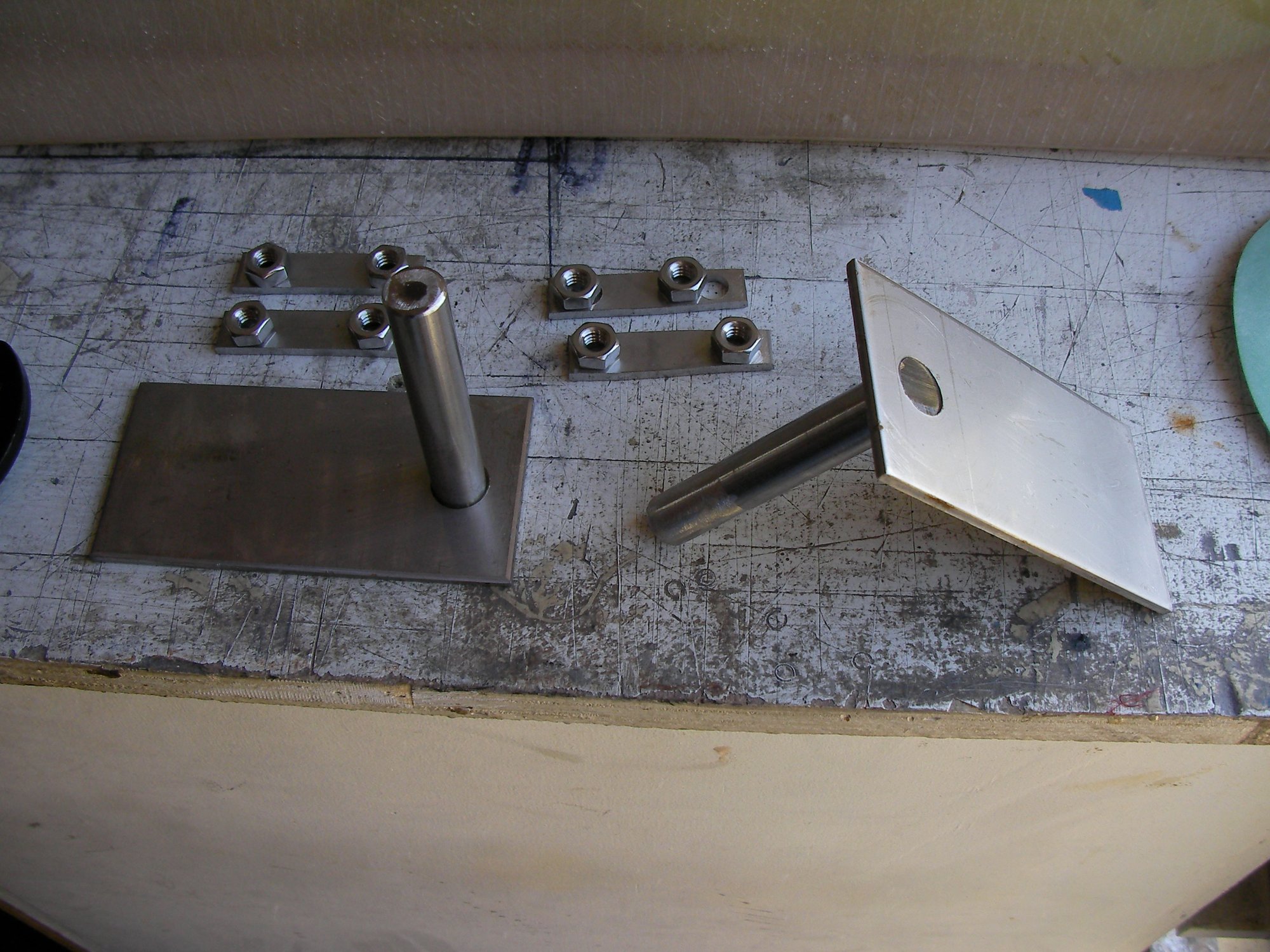

I can hammer that plate so the rod is square, they'll swivel on the level
failed no time to mess around, gluing core down and inserting t-nuts.
They fit into a grommet pulled off my old recliners
Borrowed idea, just bigger with cup holders

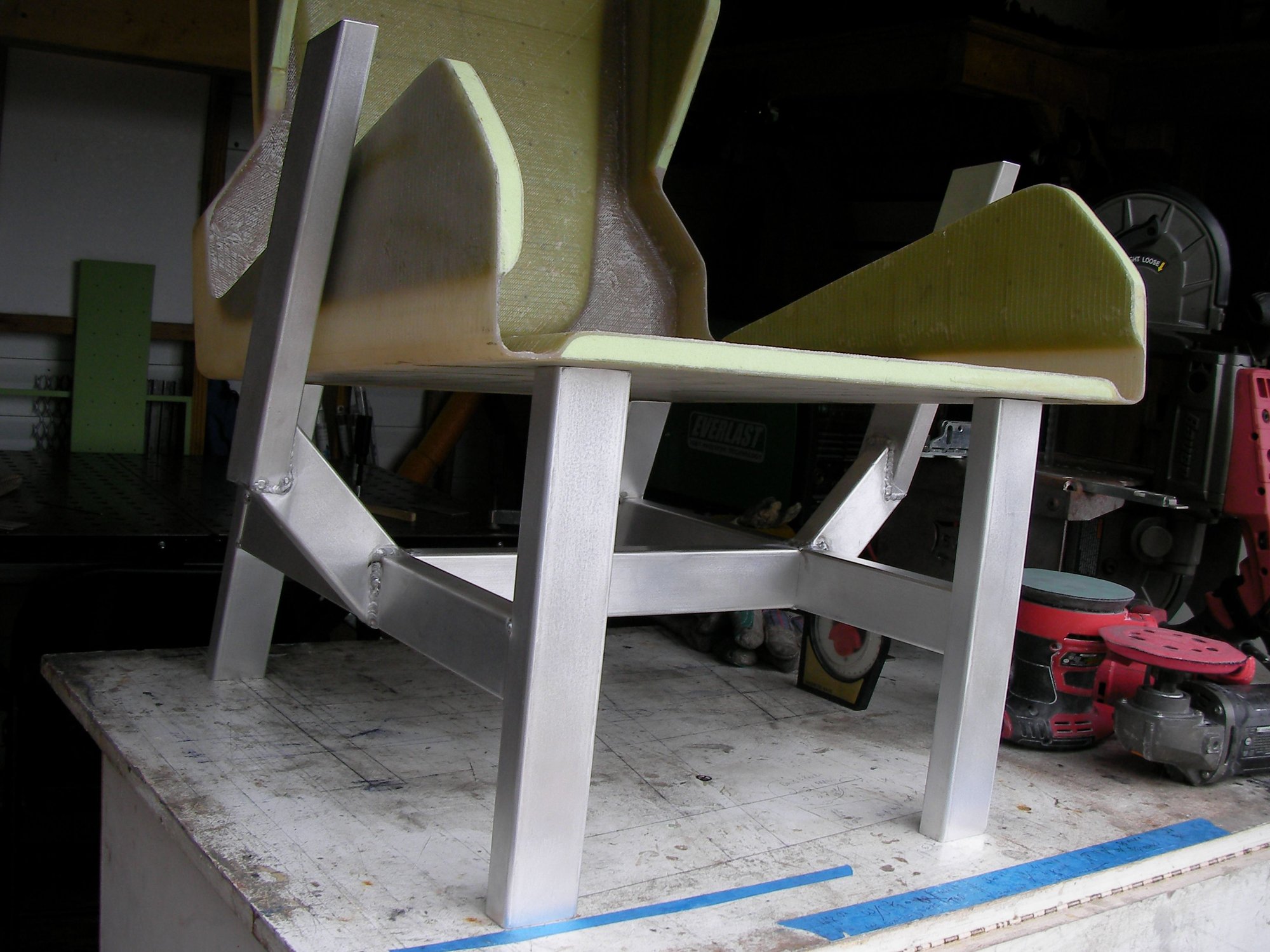

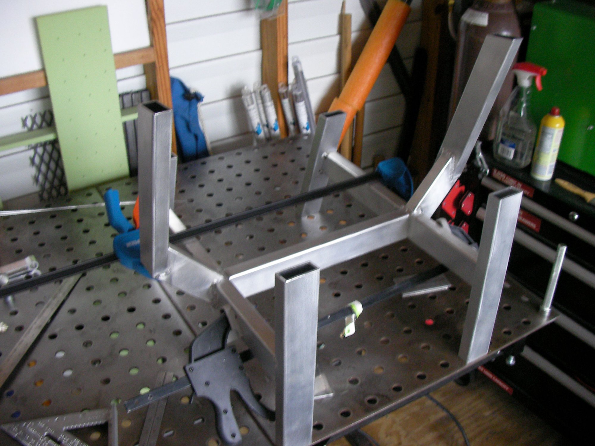

Warning, the following pictures may not be suitable for all viewers.

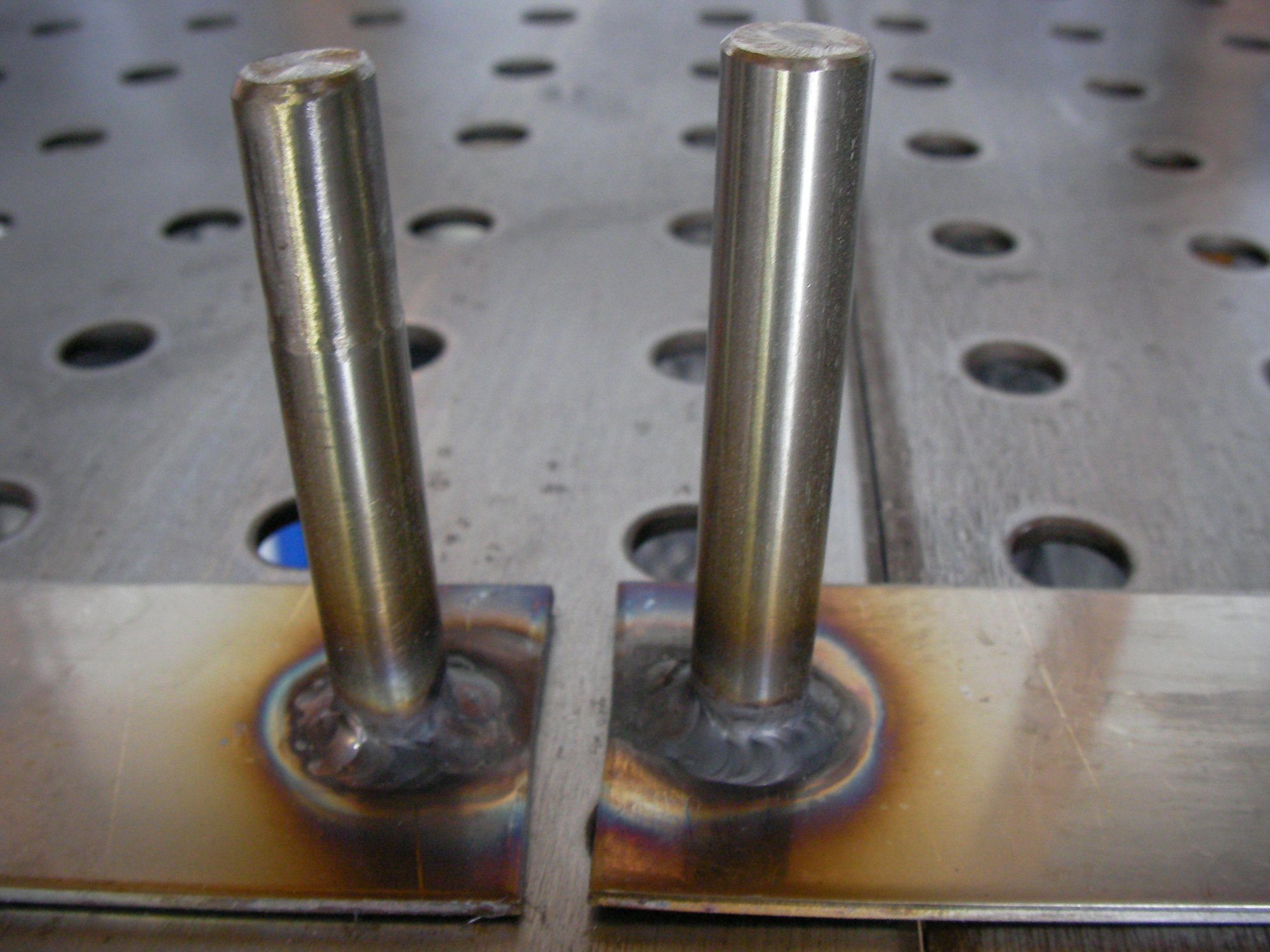

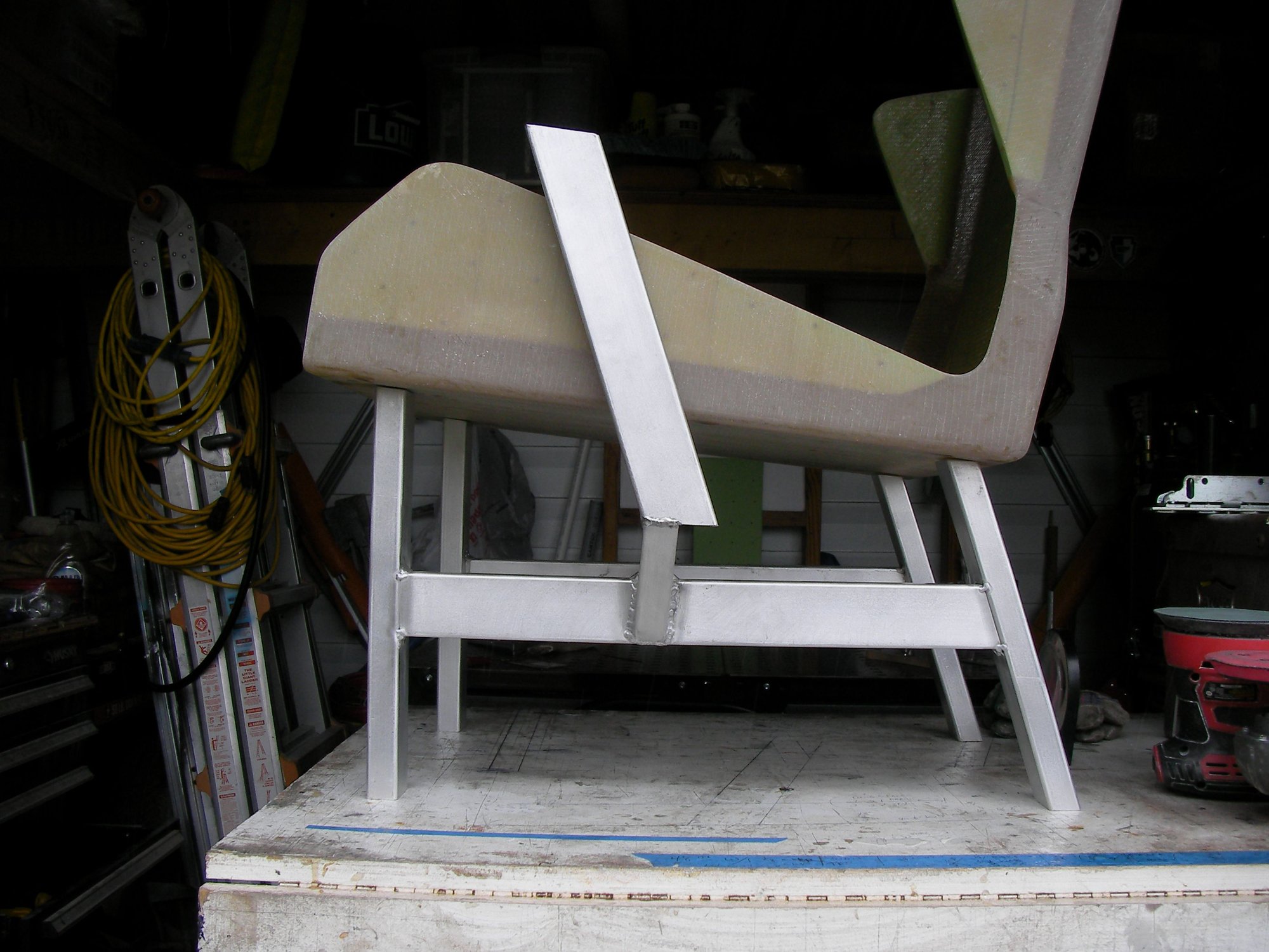

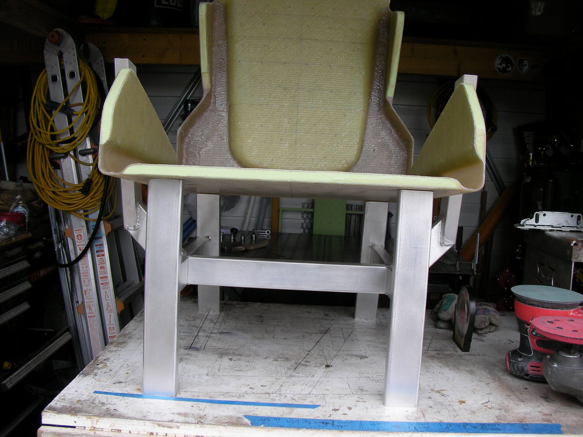

Pickd a good sequence welding the 45's to the front/backs then the uprights yesterday.
Today i tacked it all together but when the welding started i immediately screwed up worse than globs of destruction. Called it a day when normally it would've been swear words and pedal down followed by more swear words.
Got enough material to make 4 of these and i have until the 26th to make one good enough for the marine corp seat.
