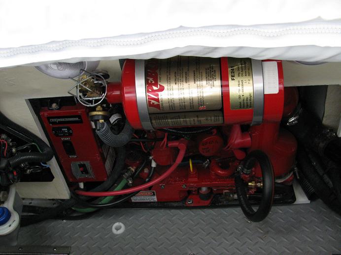

sidetracked502 08-21-2009 11:16 PM
i have a westerbeke factory installed gen in my 2006 353. its under the seat. i would never buy any boat w/o gen. this is a 3kw, it runs a/c, charger, tv, frig, and never misses a beat. it is only 165lbs,and water cooled, so the little extra weight doesnt slow the boat at all.

sleek1 08-26-2009 05:46 PM
Thanks, looking forward to seeing the set up. I priced the genset online.... $5,500+. That's a little more than I would have thought but it does have "marine" in the title. Looks like a neat unit.

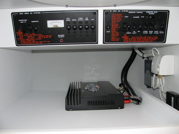

sidetracked502 08-26-2009 08:35 PM
2 Attachment(s)
Attachment 394692
Attachment 394693can take more over weekend if these dont help. boat is for sale on boat trader.com
sleek1 08-29-2009 06:21 PM
Man that genset sure is nestled in there. Thanks for the pics, it will help me out if I decide to take on this project. Good luck selling your boat-nice looking.
