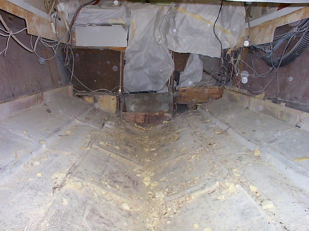

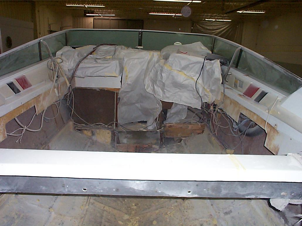

spazboz 07-25-2010 12:51 PM
1988 357 Sr-1
4 Attachment(s)
Couple of pictures after the rotten stringers were removed. That fuel tank is a son of a gun to pull up off that floor. Be prepared to take some time to get it to un-seat. In this boat the floor drains flowed into the bilge in front of the motors as described in a post above. before we re-installed the fuel tank. we layed a piece of 1" conduit in the bottom of the hull connecting the bilge to the front under the the step in the cabin. Then in the back we put a rubber plug in it. IN the event the front ever gets wet for any reason, you can pull the rubber plug, and it will drain. This happened only one time when the filter assembly on the air conditioning cracked and filled the cuddy floor with water.
Attachment 422516
Attachment 422517
Attachment 422518
Attachment 422519
I'll try and find the before pics.
