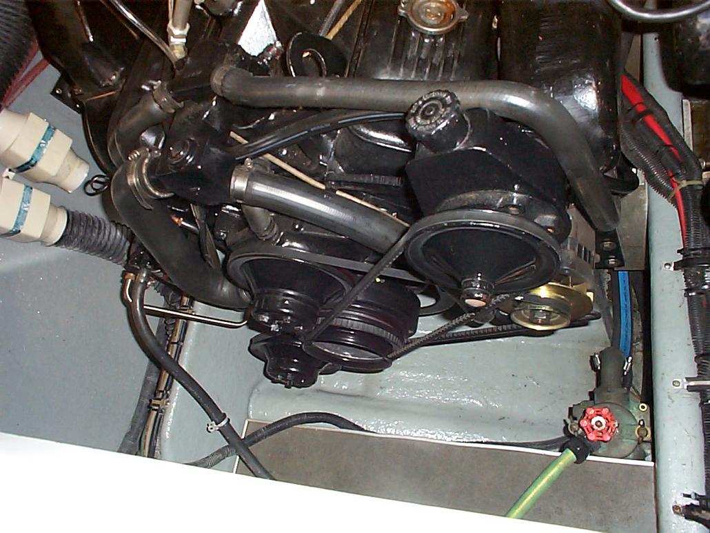

spazboz 10-26-2010 10:25 AM
1 Attachment(s)
Originally Posted by offthefront (Post 3238424)
Mike ...take a look at my thread on the 311 stringer repairs ... the center stringer had solid wood thruout ...problem was the bottom of the stringer was not sealed ...so water that was in the V under the stringer could soak up into the plywood ....m
http://www.offshoreonly.com/forums/f...6-project.html
That's the wider style stringer in the 311's. The 357 had the narrower center stringer. This isn't the best picture, but its all I have left. You can see the narrower style in the right corner of the picture. Not sure which one you had.
Attachment 430633
