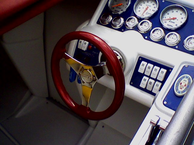

Have had the new to me out twice this season and i absolutely love the boat, I do have a 4-6" slack in the steering that would be great to get out without dropping thousands on external steering! Is there a solution for this or?? Also my boat does not have tab indicators and just the dial drive indicators, Ive been starting with tabs down drives down, get on plane drives to neutral but then where are you putting your tabs?? do you leave them down, although i can only go by feel without indicators!!

Pond runner thanks for the info, the drives are tight, the slack im talking about is in the steering wheel i can turn the wheel i would say 3-4" before it will turn?? All is fine but when im running fast i dont like the play in the wheel!

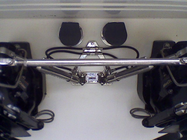

Expensive Date 04-12-2012 03:22 PM
2 Attachment(s)
Attachment 472738
Attachment 472739
Mine was the same way from new. Its just a cheap system, a lot of the play is in the helm itself, but the only way to fix it is the pictures above. I have no play now. Shame on Formula for sending these boats out like this.

looseconnection 04-12-2012 06:54 PM
No tab for us at anything over 3k. Starts to bow steer. I put drew marine sidewinders on still the 1/2 inch slack but runs true and feels hydraulic like. Make sure your trim on throttle is moving both drives or just use rocker switches. Trim the drive even with hull and put in the water. Dont touch trim and get a buddy in the cabin to plane off. Once up on step look at prop wash and burn the image to you memory. Rember how the boat feels. The hull should feel slighty loose but not like a bass boat. Asjust tabs to modify trim of the boat. Level attitude is best.
