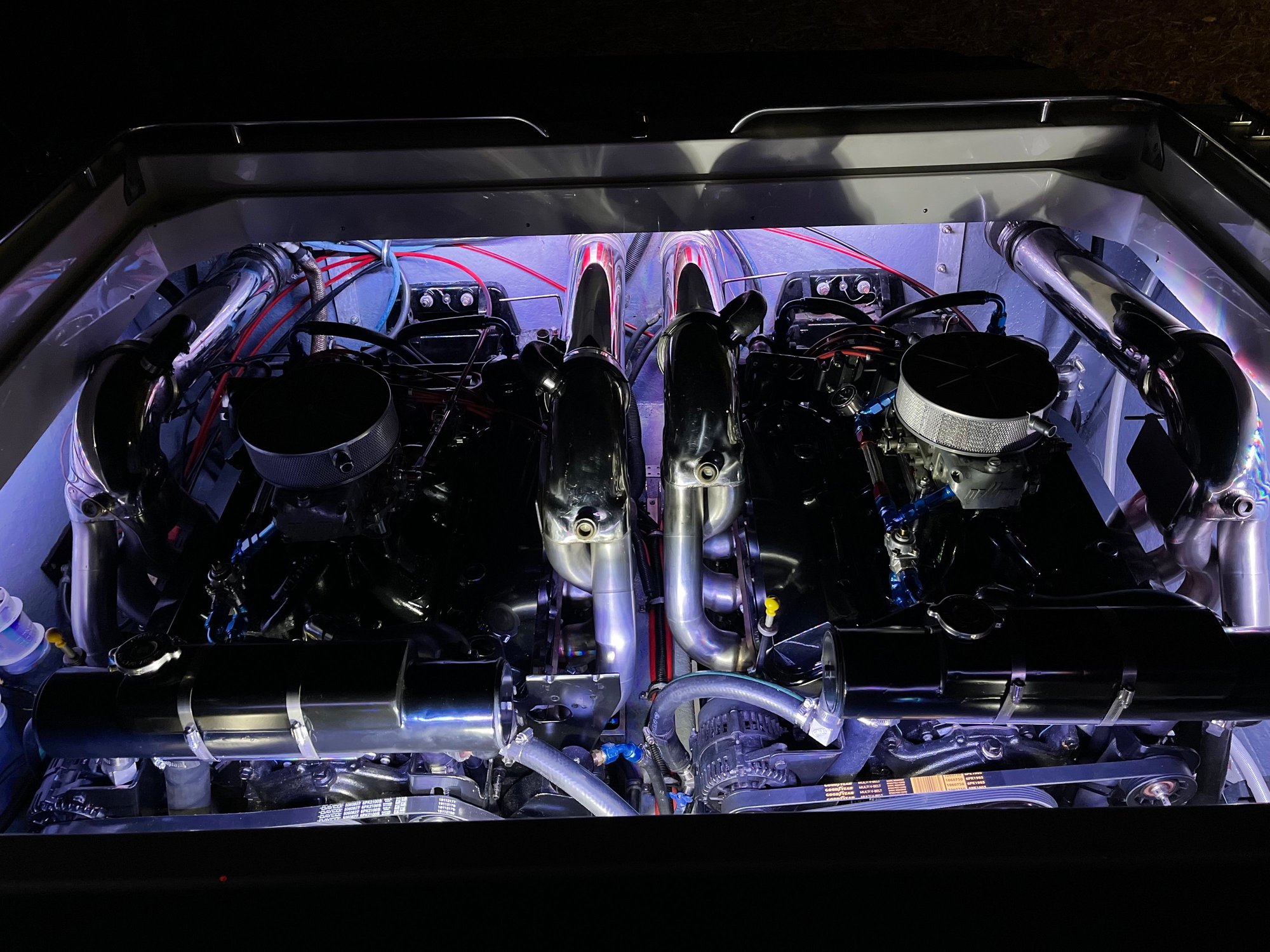

TomZ 10-24-2021 01:33 AM
Slowly but surely….
https://cimg0.ibsrv.net/gimg/www.off...4326fc7fe.jpeg
https://cimg1.ibsrv.net/gimg/www.off...ea69e48ab.jpeg
Electronics are all that’s left now. O2 sensors/controller/gauge and the moving around of other gauges to accommodate oil temp.
I got the keys and both engines rolled over. Maybe fire Sunday afternoon? We’ll see.
It’s taken long enough… At least I get to tune in cool weather.

TomZ 12-02-2021 07:09 AM
Well, I started them over the weekend. Nothing spectacular, but I got them tuned in a little more, timing set, fattened up idle a some. Idling on the hose at 950, they sit at 160 degrees and the water coming out of the pipes is, by feel, right at 100 degrees. The high advance of the EST distributors at idle really takes the bite out of the exhaust note; from inside the boat they're running like sewing machines.
Now I need to get to work on moving/installing gauges and getting the sun deck back on the boat.
